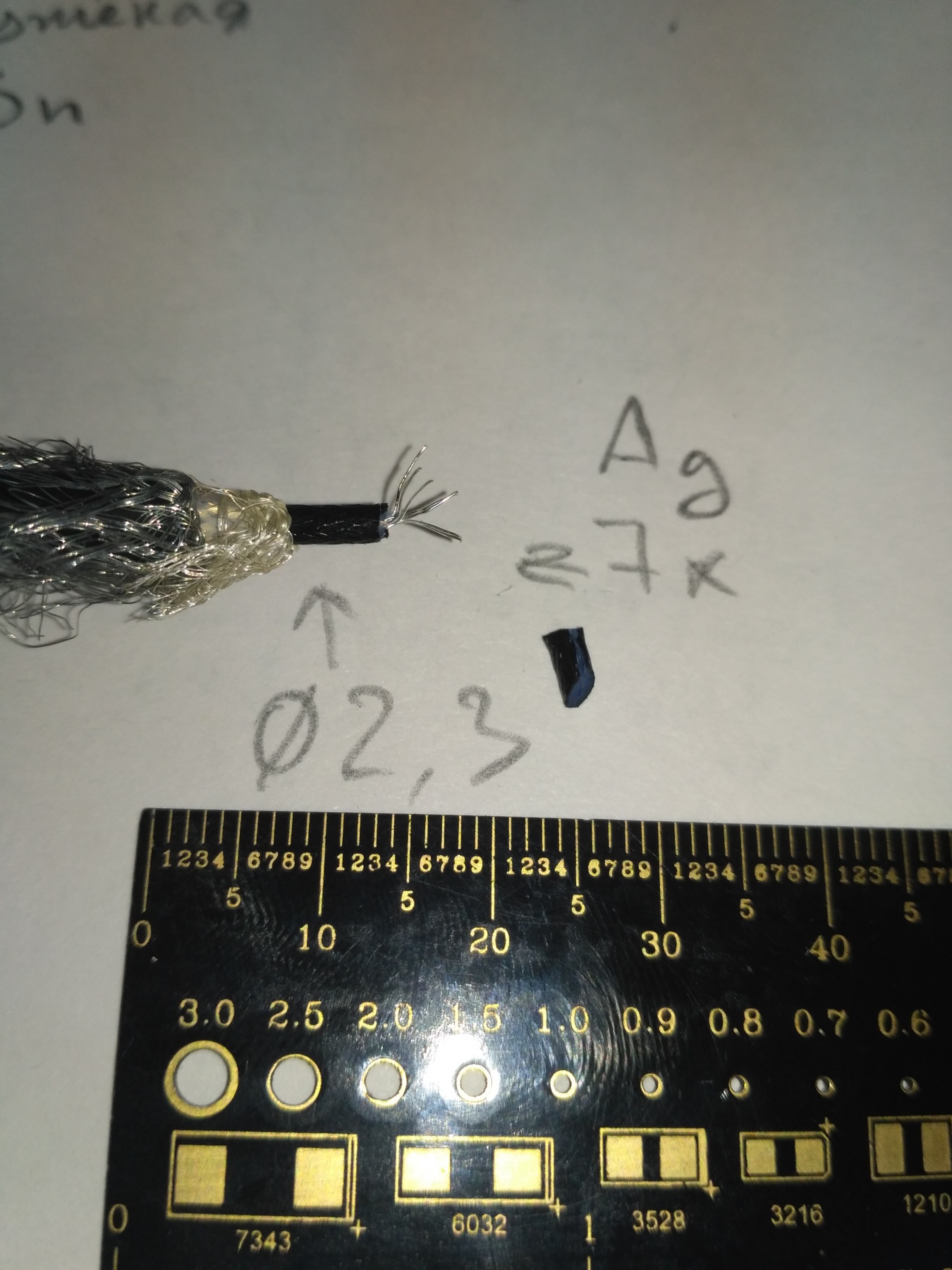

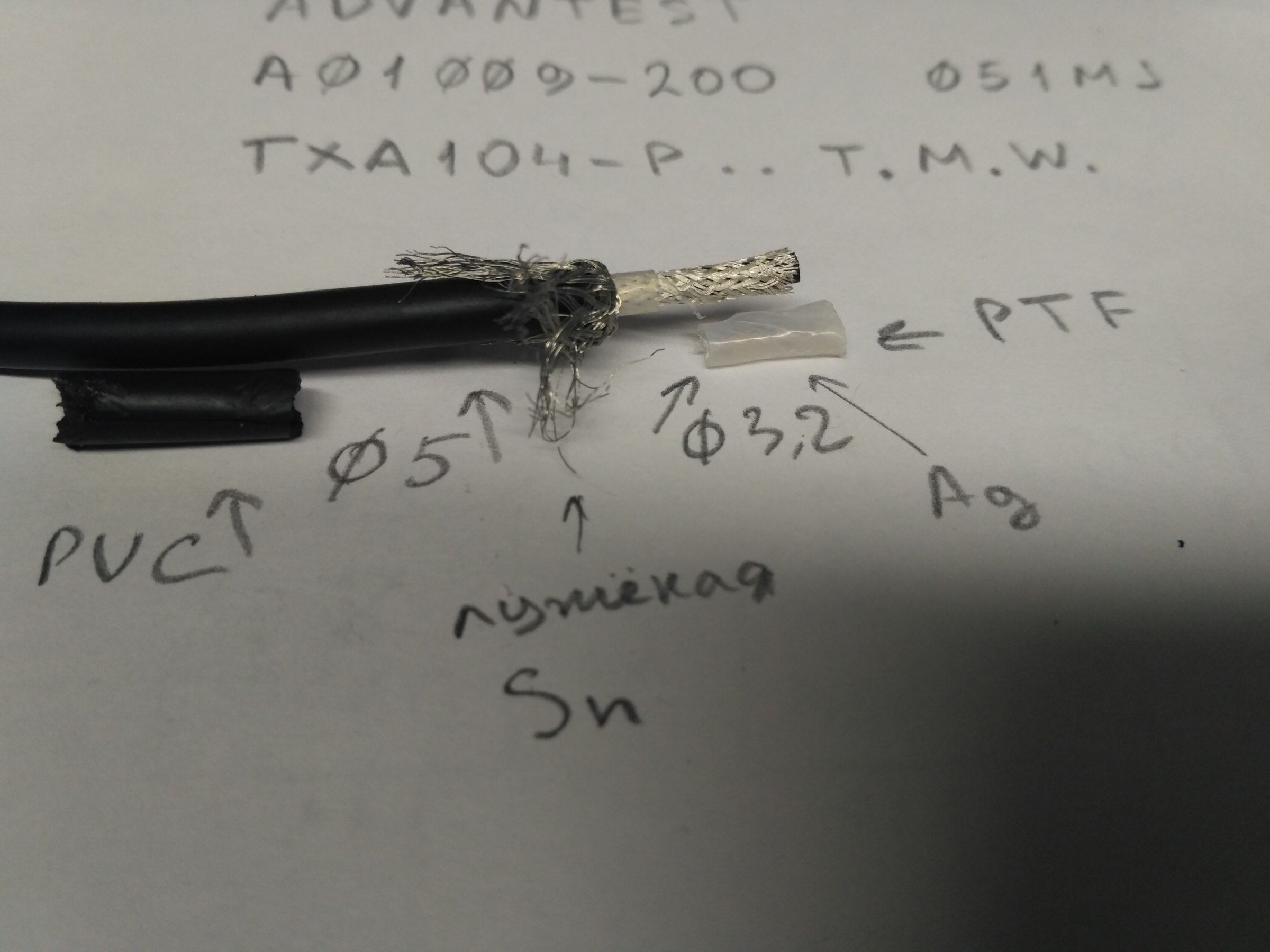

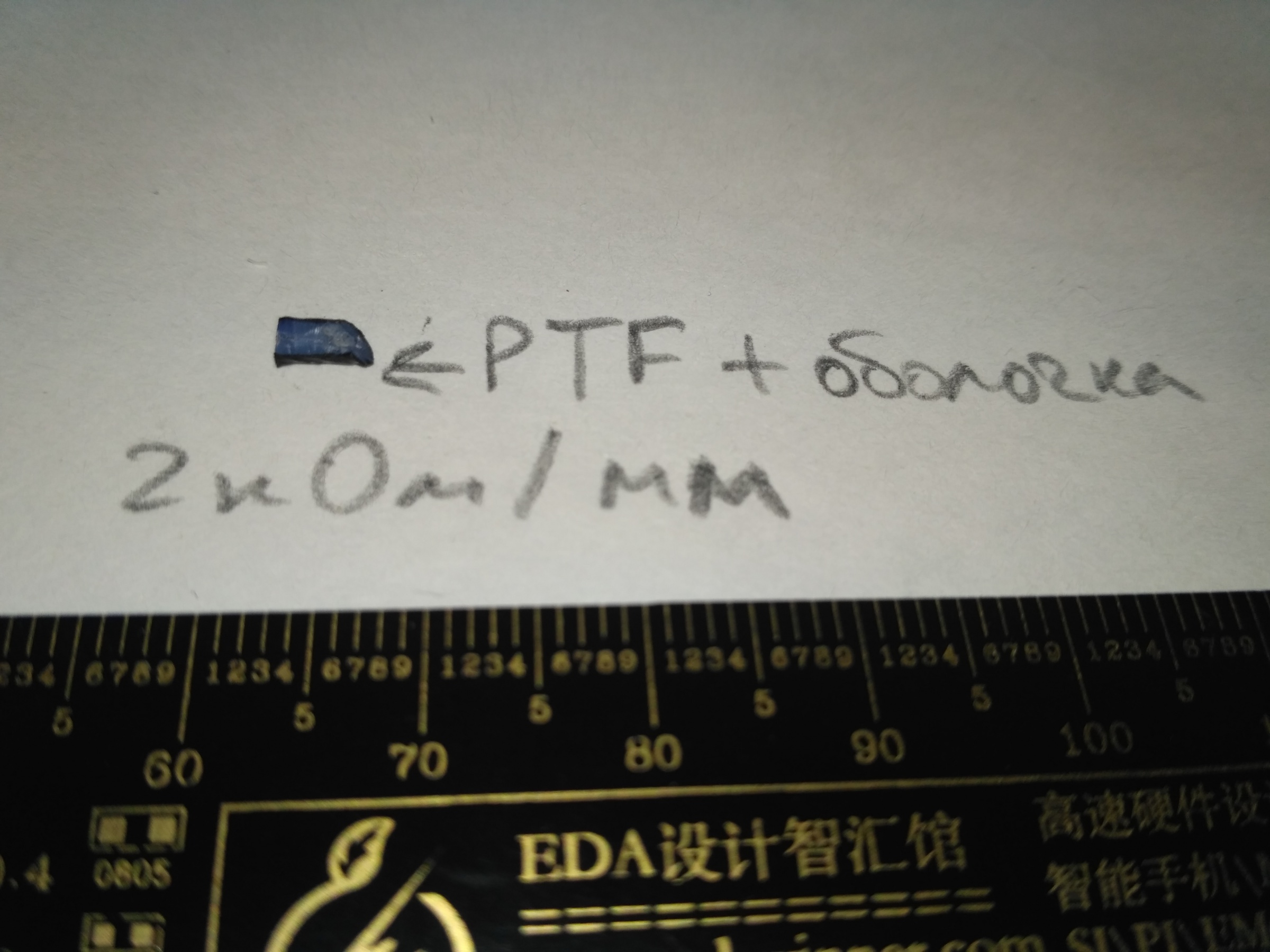

Advantest triax cables have a coating on the inner insulation.  Conducts current, or not - did not check.

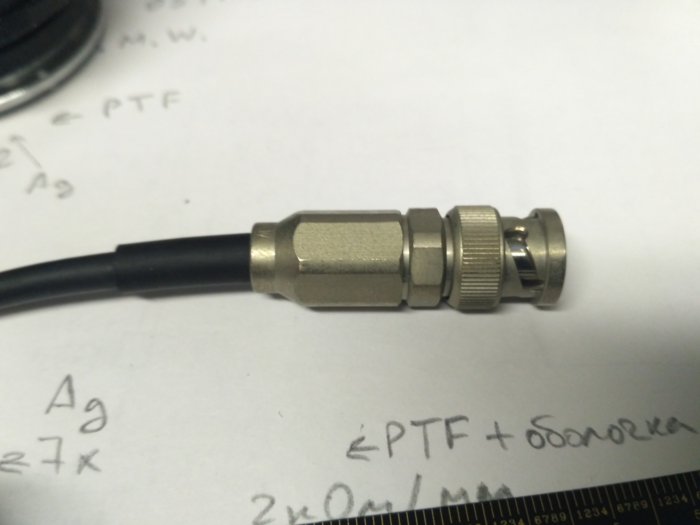

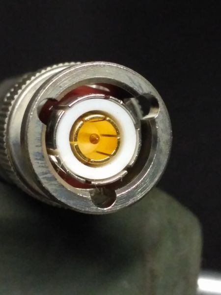

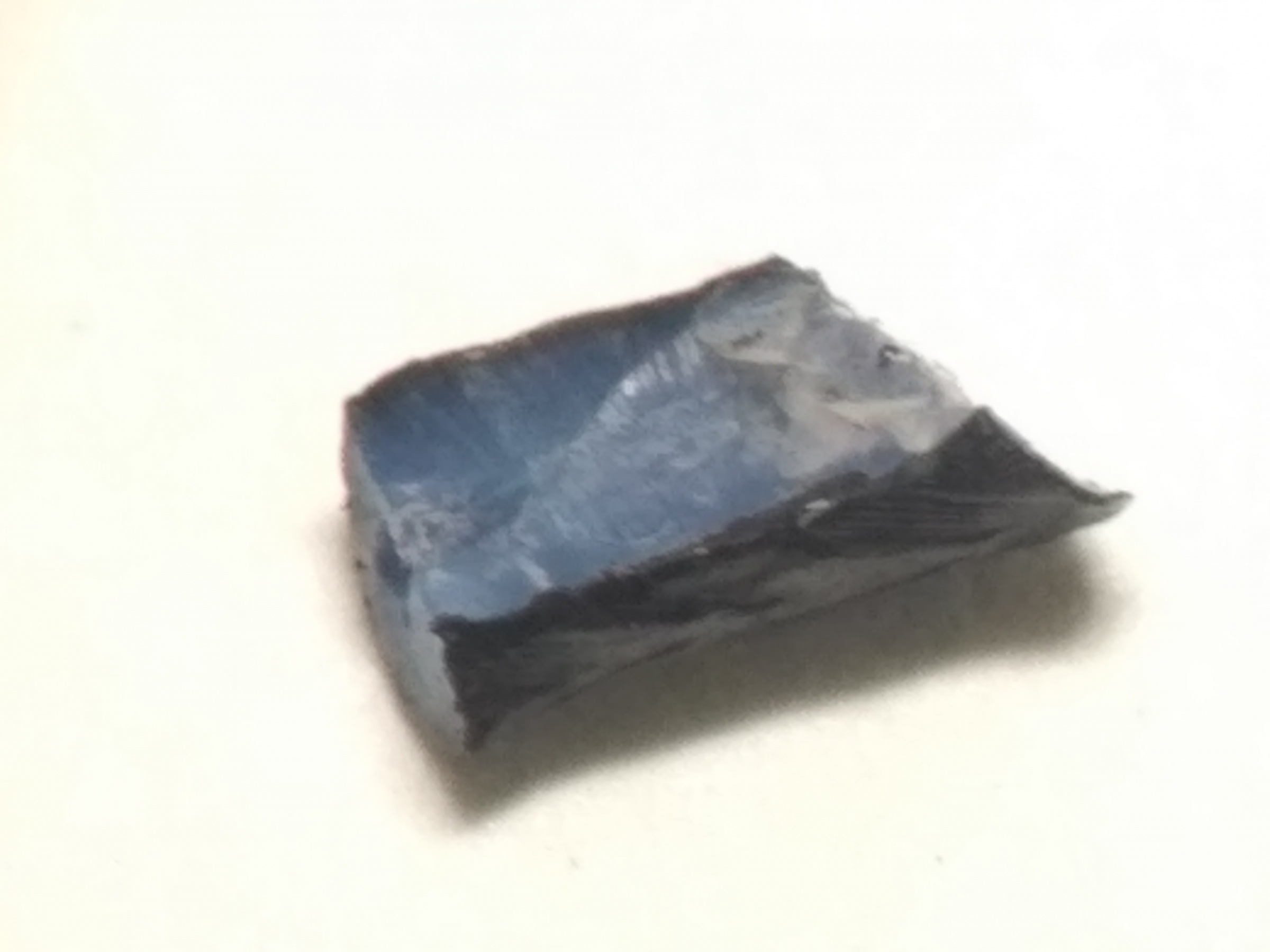

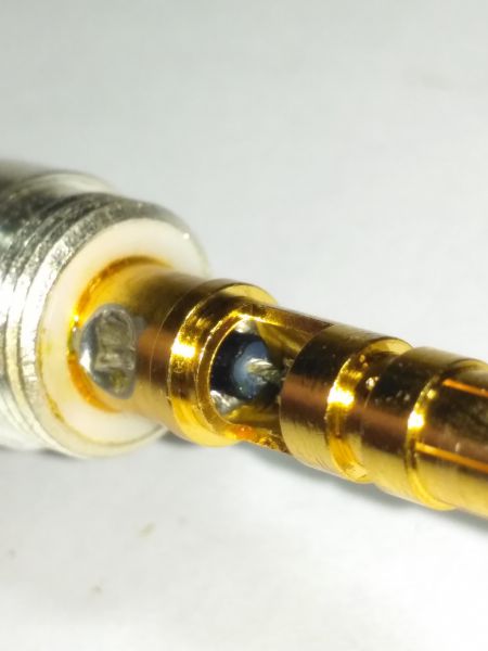

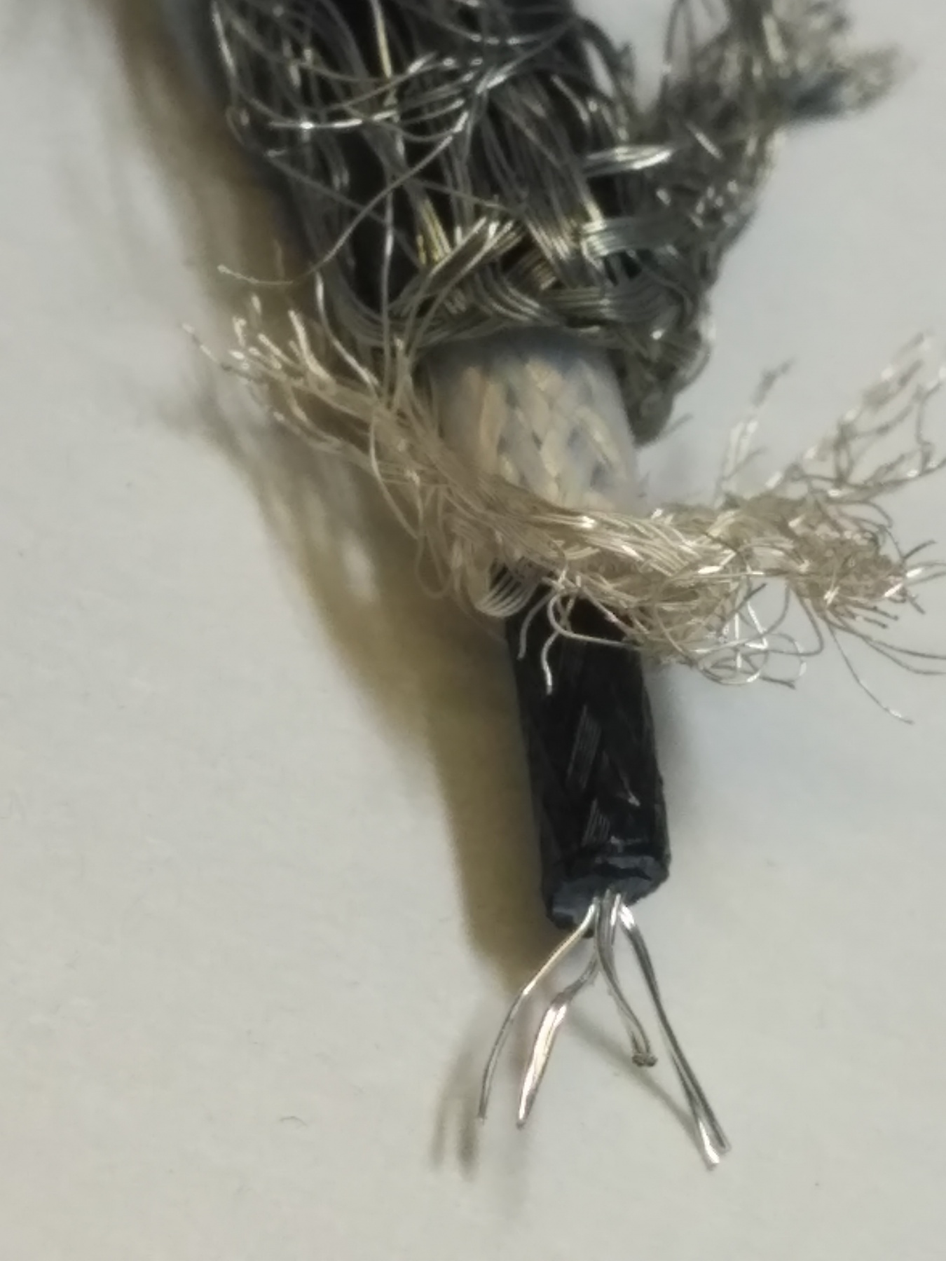

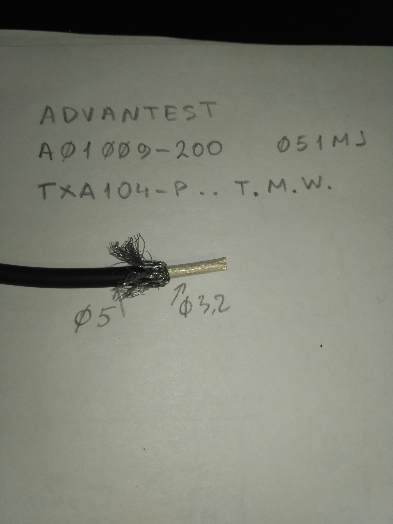

« Reply #33 on: November 23, 2019, 11:37:42 pm »

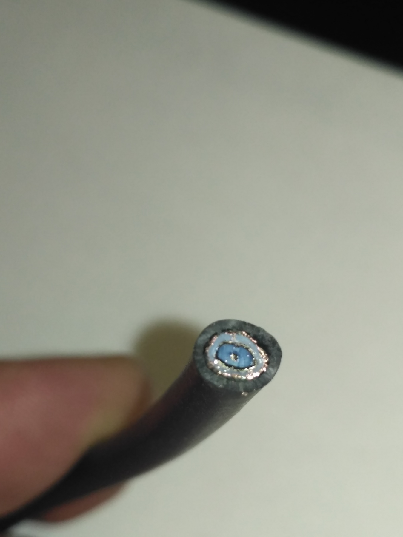

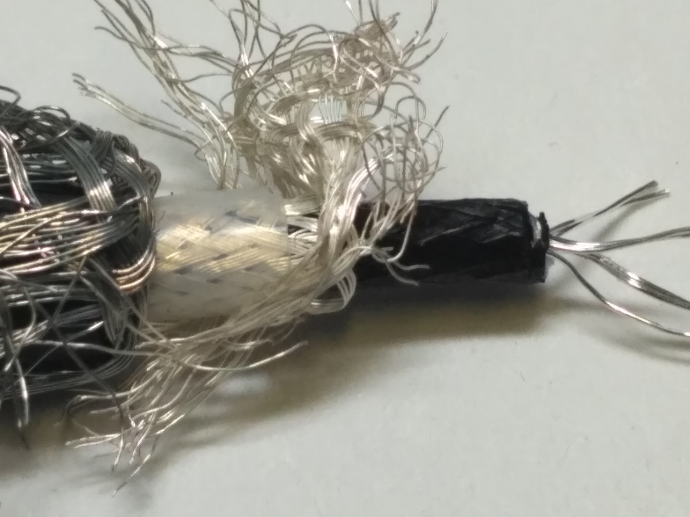

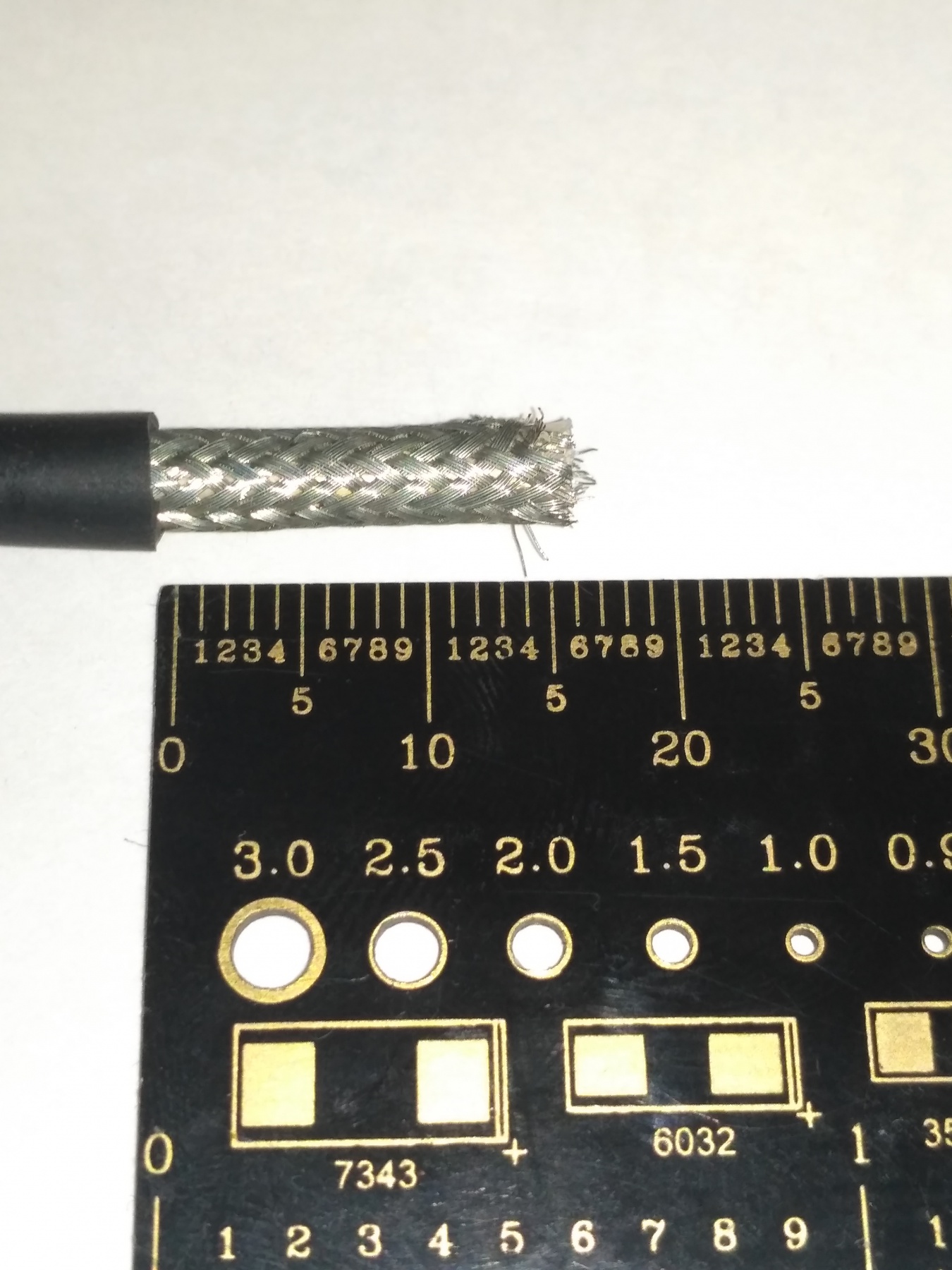

Took measurements on his cable.
Advantest A01009-200.
Autopsy results in photos.
« Last Edit: December 01, 2019, 02:38:59 pm by serg-el »
The following users thanked this post: Kirill V.

« Reply #34 on: November 24, 2019, 12:11:23 am »
Great-great thanks Alex for diodes information and serg-el for cable disassembly! :-+
