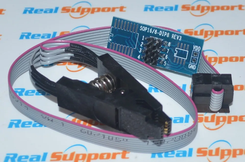

It looks like I need a programmer to try to reanimate that K2000 via I²C.
Any suggestions for a good value programmer?

As for the programmer, TL866 can be an option. It's cheap, so far worked fine with serial/parallel E(E)PROMS for me. For SMD packages there are a lot of adapters available. It all depends what do you want to use it for.
If you only want to program the 24LC16 in your meter, for a quick and dirty solution an arduino could also be used.

Just hold CPU in RESET and you can just hook SDA/SCL/GND to TL866 to readout the calibration EEPROM data. That's how I did it on 2001/2002's.
It's strange (to say softly) to experiment with calibrations without saving original dump first.  :palm:
So we saw the described outcome coming.  :-BROKE
Thanks, for that information.

1568431-0
Capacitor makes it a bit harder, but clip accurately sits on the right side of the chip where data lines are, only need to connect programmator to ground in some other place. :scared:
Calibration flash data is saved, now we are prepared and safe. >:D
