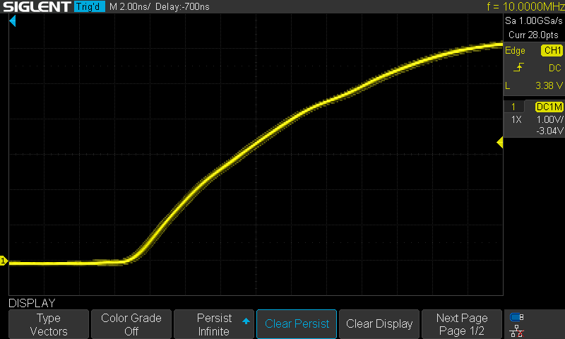

There are a slew of references based on the CTI OSC5A2B02 10MHz 5V Square Wave OCXO Crystal Oscillator very cheap (~$20 USD).  After placing in an enclosures to protect against drafts, the two I am testing are holding <0.1 ppb day to day stability once trimmed to the thermal environment.  Bare modules are less than $3, though I don't yet know what I'm going to get.
The one shown  lacks fiber fill to damp airflow and is very stable lying flat, but shifts frequency quite a bit if placed long edge vertical.  Lay it flat again and it's back where it was.  Another filled with cotton balls doesn't care about orientation.
This one will get a mat of fiber insulation and a temperature controller.  The dramatic change in frequency from convection makes keeping a copy of this pointless except as an example of what not to do.
The yellow trace is one of Leo Bodnar's GPSDOs.  The other trace is the OXCO output.  I attached the two screen dumps so you can calculate the frequency difference independently of my 5386A.  I know from experience that when the error is <0.01 Hz I can't possibly get it better.
One of the great virtues of packaging them in a box is the ability to use it with any T&M kit that takes an external 10 MHz reference via a backpanel  port.
Have Fun!
Reg

received today OSC5A2B02, was curious about jitter .... seems nothing ...
I may consider , super duper high jitter was incorrect measurement :
i'm wait 60 seconds , till snapshot , that 7th rise from the trigger
forgot to say .... that high P-P,  due to GPSDO, reference , as the circuit truing to constantly push-pull OCXO adjustment , if you run fa-2 for at least a week , internal oscillator would be reasonable steady, and hook gps to input, you may see as 2 last digit constantly jumping up or dowm,   merely depend on gpsdo algorithms adjustment  ...
« Last Edit: June 28, 2024, 02:35:26 am by GigaJoe »
I think the GPSDO does constantly adjust up and down but I'm pretty sure what you saw above for Pk-Pk with the Amazon OCXO is primarily from the Amazon OCXO/board.
Below is the same FA-2 counter (getting it's ref from the GPSDO) taking a 10 MHz input from an Agilent generator (also ref'd to the GPSDO).  Not so much Pk-Pk.  I think this indicates that the GPSDO can be reasonably steady.  If need be I can probably find similar results from measurements made over longer durations.
