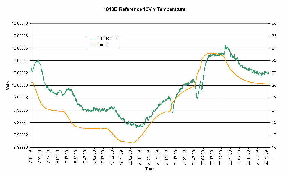

« Reply #14 on: February 09, 2017, 10:13:42 am »
I did a 23C-15C-45C-23C run in my "temperature chamber" on the 1010B reference and will post some graphs later. Few things transpired during that run.
First, there is a noticeable lag between the reference itself and the temperature compensating diodes, as the diodes are placed on the board and not in a direct thermal contact with the case of the reference. It is only noticeable during reasonably fast temperature changes, as the diodes react faster than the reference, so if the temperature rises fast, the voltage can actually drop by 5-10 ppm before rising again some minutes later.
Second, the tempco measured after the voltage is settled at a particular temperature is reasonably constant at +1...+1.5ppm/C over the whole 15C-45C range, so with a better temperature compensation circuit this could be adjusted closer to zero. I won't bother with this unit though, it is good enough for it's intended application as a travelling reference that could be posted cheaply.
Third, the hysteresis was not readily measurable over that run, less than 1ppm variation after settling down at the same 23C temperature as at the start. It is also worth noting that the reference was transported at an outside temperature below 5C and did not exhibit any voltage shifts. The control run will be after the weekend when I'll bring it back to HP3458A.
I will also run a proper temperature test for the internal 10K reference resistor. A preliminary estimate from few points is below 2ppm/C.
Cheers
Alex
« Last Edit: February 09, 2017, 10:17:51 am by Alex Nikitin »

« Reply #15 on: February 20, 2017, 12:38:49 am »
Here is the second run in a "temperature chamber", this time with few "stops" - again, there is a visible lag on the thermal compensation, essentially no hysteresis, +1ppm/C tempco and a bit of a popcorn noise, still visible though the voltage was measured with the Keysight 34465A.
Cheers
Alex

« Reply #16 on: February 20, 2017, 04:57:43 pm »
The popcorn noise look much stronger than in the earlier measurement. So maybe it is from a different source, like the DMM.
Offline Alex NikitinTopic starter
  • Posts: 1459
  • Femtoampnut and Tapehead.
    • A.N.T. Audio
Re: LT1021CMH based mini-reference
« Reply #17 on: February 20, 2017, 05:05:50 pm »
Not really, the popcorn noise is about the same 0.5ppm p-p. Vertical scale is 2ppm/div. Other "jumps" are from the thermal lag between the tempco correcting diodes and the reference IC.
Cheers
Alex
