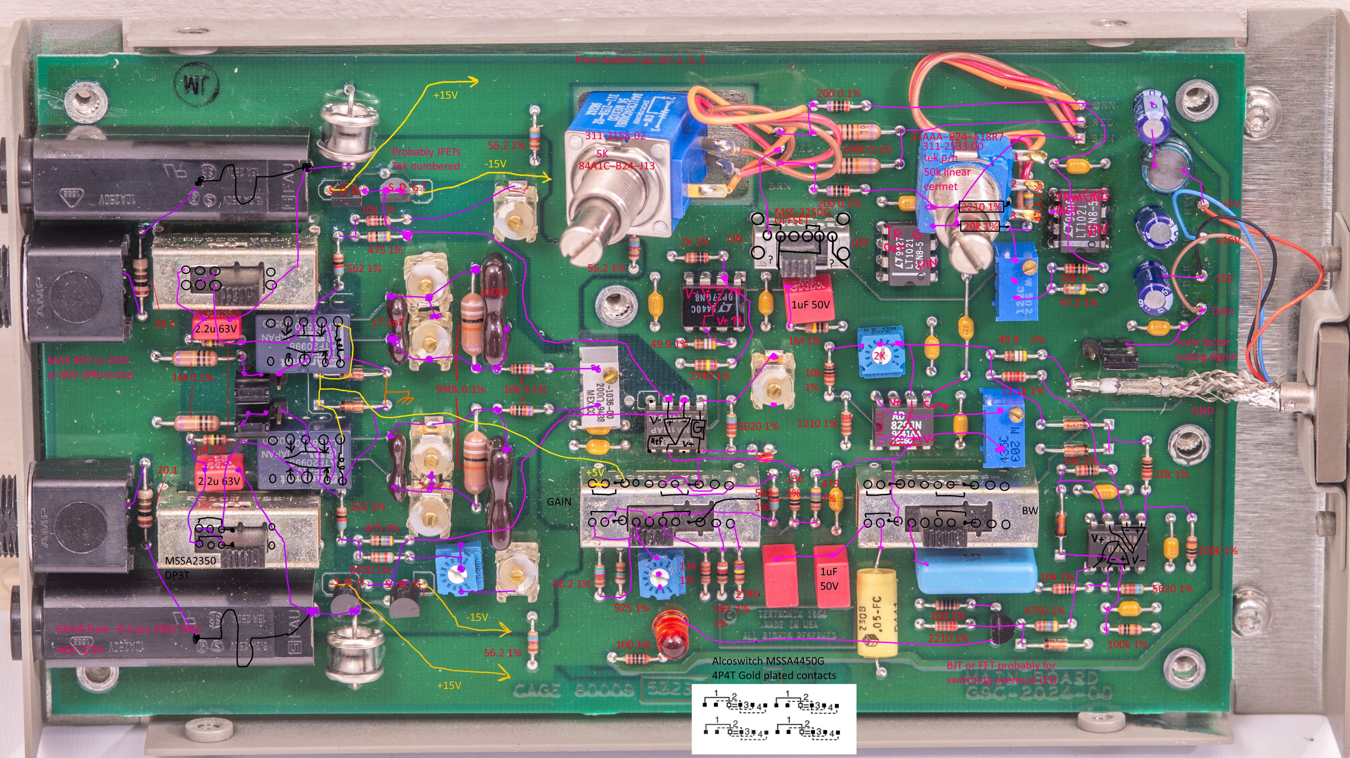

Take a look on Tektronix ADA400 Differential Preamplifier https://w140.com/tekwiki/wiki/ADA400 can be connected via Tektronix 1103 power supply to any modern hi-res scopes.
Mostly-correct schematic of the ADA400.
Significantly more complicated than my current design or the LFLNA-80, (likely?) requires matched initial high-pass filter capacitor, a lot of internal trimmers, unnecessary gain controls.
If I can find a 100% complete schematic (as there's a lot of things that the Github poster is unsure about), I may consider simulating it, seeing how well it works, what can be removed, and how to speed it up. The device is over $300USD on EBay, so I definitely won't be purchasing one.
Early on I did consider a differential input amplifier, but I quickly became dissuaded by the requirement for matching input high-pass filter capacitors
Edit:
Looking at this image, I could likely remove the bandwidth switch, gain selector switch, input selection (AC, DC, GND) + associated circuitry. Hmm, maybe I will consider looking more into this design...
Some notes on the schematic:
- Uses a +15V & -5V for DC offset voltage correction, instead of a DC servo (in my design) or high-pass filtered output (of LFLNA-80)
-  DC offset voltage correction is fed into an instrumentation amplifier, which also appears to be the main preamplifier with a super-low input bias current of 20pA (max).
- No idea what Q1 & Q2 do/are for
- AD829 amplifies the signal further for the output, and uses an external compensation capacitor for stability (per datasheet, appears to be required for gains less than 20x)
- Simple overload detection circuit
The trimmers
: (??? = I have no idea what it's doing, as I'm not smart enough, but I do take a guess)
- RV1 (???)
- C2 (???)
- C3 (???. For reducing noise?)
- C6 (???. Not enabled for 100KHz/Full bandwidth? Can be removed?)
- C7 (???. Not enabled for 100KHz/Full bandwidth? Can be removed?)
- RV5 (???. Not enabled for 100KHz/Full bandwidth? Can be removed?)
- RV6 (gain fine-tuning?)
- RV8 (gain fine-tuning?)
- RV2 (External pot: coarse DC offset voltage correction)
- RV3 (External pot: fine DC offset voltage correction)
- RV4 (another DC offset voltage correction trimmer)
- RV7 (DC offset voltage correction)
Without knowing the purpose for all of the trimmers, I don't think I'd really be able to replicate the circuit.

Q1 and Q2 are JFETs connected as diodes (gate to channel), used as part of the input protection circuit.
Small JFETs are often used thus, exploiting the very low leakage current at low voltages, compared with signal diodes (e.g. 1N4148).
The following users thanked this post: LooseJunkHater

Q1 and Q2 are low leakage current input protection diodes.
And yes, the circuit becomes more complicated if you include the second input channel and one needs matched filters etc. Maybe the 300 € ebay price is justified. The device supports capacitive coupling (in case of larger DC offsets) and i guess one could increase the two capacitors C1- and C1+ in order to implement a lower bandwidth limit of 0.1 Hz if required. Differential input is nice to have for low level measurements if the DUT is more than a little test PCB.
Regards, Dieter

BAV199 might be a good substitute for the Q1, Q2 diode connected jfets.

The 1st amplifier is the INA111. So this sets the input bias, noise and drift performance.  It is a good FET INA, but could still be limiting when it comes to super low noise. The ADA400 is mainly a differential probe, not a super low noise amplifier.
The trimmers are not that complicated to see what they are good for:
RV1 and C2 are for the input impedance per channel  -- this may be the slightly tricky part to trim, RV1 may use a fixed resistor
C3 to trim the higher frequency CMRR
C6 frequency compensation for setting with 1:100 divider at the front
C7 input capacitance for setting with 1:100 divider at the front
RV5  symmetry in the 1:100 dividers /  DC CMRR for 1:100 setting
RV6 overall gain
RV8 gain for 0.1 gain  - there may be something wrong in the gain switching part

I ended up spending a bit of time simplifying the Tektronix ADA400A schematic that was posted to Github, to improve my understanding of it (image attached). Hopefully I didn't mess any of it up.
Removed:
- Gain selection + Trimpot RV8 (now it's a constant 100x gain)
- Bandwidth selection (now it's a constant "full" bandwidth; above 100KHz)
- Overload detection/Overload range LED
- 5v Relay (was associated with gain selection)
I'm a bit confused as to what "Scale_Factor_Coding" is for, as it doesn't seem to connect to anything on the circuit and attaches to the scope? Maybe it's just for automatic scaling change on the oscilloscope? https://raw.githubusercontent.com/mattico/ADA400A-Reversing/refs/heads/master/Images/ada400a_top_annotated.jpg
Additionally not entirely sure how the In+ circuit is wired up into the circuit (related to "To + Channel" being mentioned twice in the schematic), so I may try to figure this out + simulate the circuit.

I have used differential-input oscilloscopes, ‘scope plug-ins, and external preamps over the years.
The variable bandwidth (LPF and sometimes HPF) feature is very useful when dealing with small signals.
I would retain at least the low-pass filter feature.

The scale factor coding should be a way to tell the scope what gain is set. This is likely a tektronic specific probe interface. So this is a part to leave out in most cases.
The +in part should see essentially a copy of the input circuit. It is just the other side of the differential probe.
The filters are helping in removing noise, especially higher frequency noise. For the highest gain one may really want a reduced BW. 100 kHz instead of 20 MHz from the scope alread could give around 1/14 the higher frequency noise.
As shown in the cut down schematics the 1:100 divider is in place. For a gain of 1 one would remode R25, RV5 and related parts and reduce R16. The R16 value would be a compromise between noise and the level of protection.
« Last Edit: October 05, 2025, 05:30:10 pm by Kleinstein »

That simplified circuit has a gain of about 1, as there are two 10x gain stages and a 1:100 input divider (990K+10K). As mentioned before by Kleinstein the instrumentation amplifier INA111 may be detrimental to noise performance and unnecessary if you go for a single ended input.
I would also keep some low and high pass filter option in case you need that later on.
Regards, Dieter
