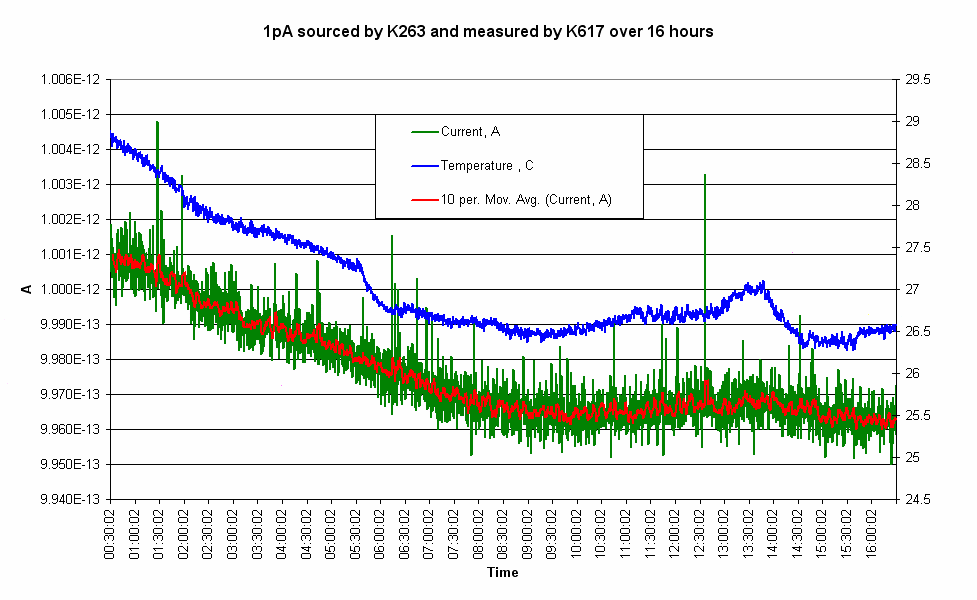

Here is a 16 hours run of 1pA current sourced by Keithley 263 and measured by Keithley 617. Temperature shown on the graph is measured by a thermocouple attached to the case of the K263 near the electrometer amp position. The visible variation with temperature is mostly due to the change of the electrometer input current on the K263. If I suppress the "zero" current again, as I've done at the beginning of this measurement, this variation is reset almost completely. This "zero" current at the moment, with the ADA4530-1 installed, is about +5...+10fA, depending on the temperature. This graph shows a very good performance from both units, essentially variations of about 5fA or 0.5% from 1pA value over 16 hours.
Vertical scale is 1fA/div. Measurements are made every 20 seconds but for a single sample with 330ms conversion time on the K617.
Cheers
Alex

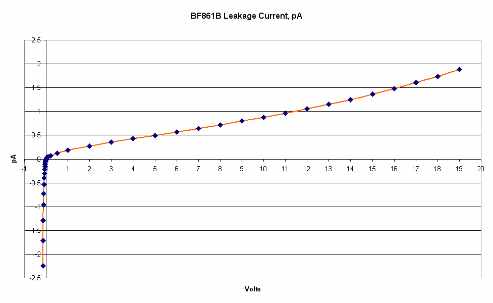

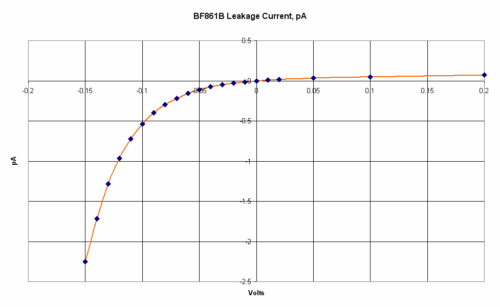

Another measurement. I plan to do the same measurement on a number of diodes and JFETs connected as diodes. Here we have BF861 JFET connected as a diode. I've used these for the Keithley 2015 repair and happy to see that the leakage is good. The voltage was supplied by the Keithley 263 and the current measured by the Keithley 617. The JFET was placed in a metal enclosure with two BNC connectors. The residual leakage was less than +/-2fA and the enclosure temperature was 24.6C .
Vertical scale is 0.5pA/div, the second graph is a zoomed in part of the first.
Cheers
Alex

Can I ask how are you guys cleaning the wires / connectors / components  after handling / soldering etc to avoid surface conduction?
IPA?
What sort of cloth / tissue / q tip??
Thanks Robert

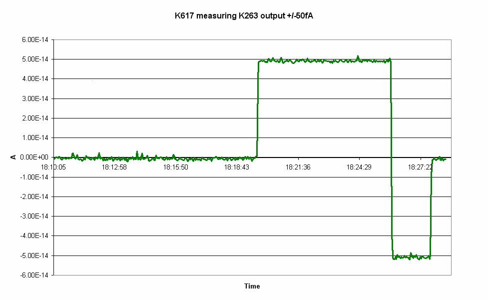

« Reply #60 on: January 22, 2017, 11:17:45 pm »
Here is the Keithley 617 measuring the Keithley 263 output over about 18 minutes time - first the zero baseline, then +50fA, -50fA and back to baseline.
Cheers
Alex

Jim Williams advocated the use of diode connected JFETs for low leakage. Every tried those?
Offline Alex Nikitin
  • Posts: 1372
  • Femtoampnut and Tapehead.
    • A.N.T. Audio
Re: Measuring nanoamps and below like a Ninja
« Reply #68 on: January 24, 2017, 07:50:32 pm »
I've posted measurements for one JFET (BF861) earlier in this thread, taken in a somewhat different setup (K263 as a source and K617 as a meter). JFETs are much better than common signal diodes like 1N4148, however very few would come close to the performance of even the worst BAV199 devices and none will survive 100V reverse voltage or have leakages similar to the best of BAV199. I plan to measure some more JFETs and BJTs soon (the Keithley 617 has some selected BJTs as input protection diodes by the way) and will post results here.
Cheers
Alex
