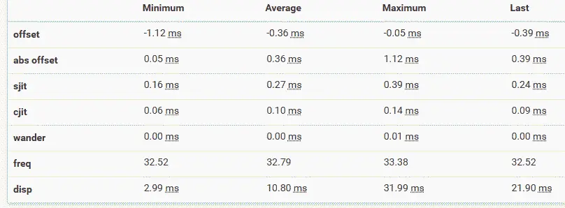

as an example 24 hours Stratum 2 from S1 ,over UDP
requirement for logging are 1mSec so it in overall fit my purpose ...
i may suggest to use 10Mhz for overall frequency usage for your lab
and 1 PPS signal will fit a dedicated NTP server that sync over Internet , but use 1PPS as a precision time second source ( consider linux\freebsd with minimal working process , and PPS signal usually feed to com port)  you may get about 10-6 precision , ( but again i have no clue how to use it on another device as over Ethernet \ UDP and software layer all this evaporated)
