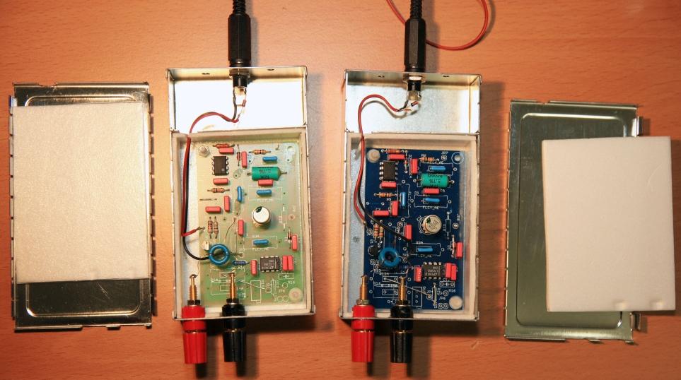

Final Assembly of LTZ1000 modules
« Reply #3152 on: December 20, 2021, 07:32:09 pm »
Hello,
maybe you remember my LTZ 1000 tuner box assemblies.
Inside the tuner box, there's space for a simple linear regulator, like an LM317 based one.
Those boxes were all powered by transformer wall warts, which I salvaged from different devices. I use a 2.8VA, 15V, 180mA transformer as a replacement for the original ones, plus bridge rectifier and electrolytic capacitor for an unregulated DC output. Here's an old  transformer case from Nokia.
It was always my intention to have a proper mechanical assembly for these tuner boxes, inside an outer case.
At first, here's the LTZ #5, solution copyright by Andreas, battery powered, where I added CuTe Pomona jacks for output, Guard (connected to isolated tuner box) and case ground.
Those Pomona jacks are long enough to mechanically connect outer case and the tuner box, adding an isolating plastic plate, and plastic spacers, so that outer box and tuner boxes are electrically isolated from each other, and also avoiding long connection cables.
On the rear side, the tuner boxes are screwed on to another plastic plate, using an electrical connection to the tuner boxes, serving as a common Guard.
Then I added the Guard and Case Ground jacks, a simple 12V LM317 stabilizer, and connected all 4 modules in parallel.
I would have of course preferred 4 isolated supplies.
This way, the 4 reference grounds differ by 50.. 250µV, because of differences on the supply cables, due to different oven supply currents. It's also not possible to connect any of these 4 reference grounds together (to make differential measurements), as this directly shifts the references outputs.
That's ok for me at the moment, as I regularly compare all of my 12 voltage references against each other, by absolute measurements of each by means of my 3458A.
Maybe somebody has an idea, to commonly supply several LTZs and properly interface the reference grounds. I currently have no idea, how this is done inside the Datron 4910.
Here's my Tower of References, where I maintain Volt and Ohm.
Frank
« Last Edit: December 20, 2021, 07:53:17 pm by Dr. Frank »

Offline Kleinstein
  • Posts: 16339
Re: Ultra Precision Reference LTZ1000
« Reply #3153 on: December 20, 2021, 08:37:27 pm »
The setup looks nice.  If there is an EMI problem, one may consider adding some common mode choke / ferrite ring just inside the reference boxes.
For the ground problem, one could consider seprate transformers. Some mains transformers come with 2 fully separate winding and thus could power 2 ref modules.
If a single supply is wanted, one could build a circuit to shift the low sides of 3 modules a litte (e.g. +-1 mV range), so that the reference low side is at the same level as the one unit taken as a master and common ground for the output. So the low side would be all from 1 box and the other low sides on the extra extra amplier / compensation part. Shifting the low side would take quite some current, though only at a low voltage.
An alternative would be to directly connect the reference gounds and make sure the negative supply leads get the same current as the positive side. This would add some current regulation / mirroring and maybe the voltage regulation. So more circuit,  but likely less extra noise and drift. The refrence modules should not provide a significant current, so I don't think one would have to treat that current separate.
Offline dietert1
  • Posts: 2774
  • Country: br
    • CADT Homepage
« Reply #3154 on: December 20, 2021, 08:50:43 pm »
With a bipolar supply one can use ground current compensation similar to the HP 3458A reference module.
With our LTFLU references, in order to use a simple +15V supply without negative supply, i am using a silicon diode in the Gnd connection to simulate a negative supply of -0.7 V. Then one can use chopper amplifiers to equilibrate the Gnds using the Gnd sense lines from each reference.
Or use a transformer with multiple secondaries to get separate supplies for each reference.
Regards, Dieter

  • Posts: 4569
Re: Final Assembly of LTZ1000 modules
« Reply #3156 on: December 20, 2021, 09:38:25 pm »
If you'd like to go with isolated supplies, I'd recommend two Talema toroidal transformers, e.g. the 70033K. It has 2x 15VAC output and 2x 3.5VA. It is available at Bürklin for ca. 17.50 EUR/unit plus shipping.
https://www.buerklin.com/de/Ringkern-Flachtransformator-7-VA-15-V-15-V-2x115-V-Talema-70033K/p/38C766
Sizes (LxWxH): 50mm x 50mm x 24mm (ca.)
Attached the datasheet
