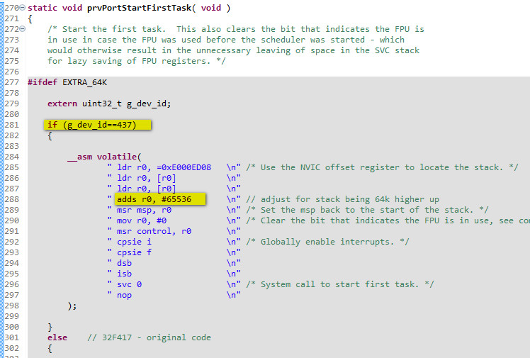

I have a strange problem.
It is OK to have the 1st vector in the VTOR vector table pointing to an initial stack value of ram base + 128k (0x20020000), but having SP itself pointing to ram base + 192k (0x20030000), at the point when interrupts are initially set up and enabled?
Vectors2:
  .word  _estack  // 0x20020000
  .word  main
  .word  NMI_Handler
  .word  HardFault_Handler
  .word  MemManage_Handler
etc
IOW, does the 32F4 interrupt system read that first vector table value for some purpose?
I know FreeRTOS bloody well does read it, hence the "adds" instruction there
static void prvPortStartFirstTask( void )
/* Start the first task.  This also clears the bit that indicates the FPU is
in use in case the FPU was used before the scheduler was started - which
would otherwise result in the unnecessary leaving of space in the SVC stack
for lazy saving of FPU registers. */
extern uint32_t g_dev_id;
if (g_dev_id==437)
__asm volatile(
" ldr r0, =0xE000ED08 \n" /* Use the NVIC offset register to locate the stack. */
" ldr r0, [r0] \n"
" ldr r0, [r0] \n"
" adds r0, #65536 \n" // adjust for stack being 64k higher up
" msr msp, r0 \n" /* Set the msp back to the start of the stack. */
" mov r0, #0 \n" /* Clear the bit that indicates the FPU is in use, see comment above. */
" msr control, r0 \n"
" cpsie i \n" /* Globally enable interrupts. */
" cpsie f \n"
" dsb \n"
" isb \n"
" svc 0 \n" /* System call to start first task. */
" nop \n"
The code is bombing in quite a drastic way :)
My vector table is in FLASH because that is safer, but if this was some huge problem it could be in RAM and then I can have the right value actually in the table.
AFAIK, no. The first two entries are read out just for SP and PC initialization after actual chip reset signal (power up reset or software reset through NVIC_SystemReset())

In the RTOS code there is this
which is the only reference to the entry SP value that I can find. The RTOS has its internal stacks in the 64k CCM, which is a separate area not used by anything else.
I wonder if perhaps there is some CPU sync stuff - the sort of thing which needs __DSB etc.
In fact looking at it again now I am confused whether the reference to 0xE000ED08 is actually reading the vector table and only that; the comment about the NVIC offset doesn't make sense.

Edit: E000ED08 is VTOR register and that code looks correct (read the table ptr from VTOR, read the first word via table ptr).
