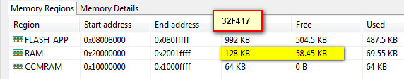

I have all this working, and tweaked things like _sbrk()

but there is a problem: I cannot do e.g.
uint8_t fred[63*1024];
i.e. a static global variable cannot access the extra 64 because the linkfile still contains the 32F417 memory mapping
MEMORY
FLASH_BOOT (rx)     : ORIGIN = 0x08000000, LENGTH = 32K
FLASH_APP (rx)      : ORIGIN = 0x08008000, LENGTH = 1024K-32K
RAM (xrw)           : ORIGIN = 0x20000000, LENGTH = 128K
RAM_L (xrw)         : ORIGIN = 0x2001f000, LENGTH = 4K
CCMRAM (rw)         : ORIGIN = 0x10000000, LENGTH = 64K
i.e. I would need to also change LENGTH = 128K to LENGTH = 192K. The error comes from the linker.
The obvious hack is to have LENGTH = 192K in the linkfile anyway but then the Build Analyser will be misleading if the CPU is a 417. No way around this, I guess
I just wonder how others have done it.
I really do not want to have two Cube IDE projects or different builds. And changing the CPU type in Cube (one needs to do it in more than one place, and that is just the ones I know about!) is a can of worms which would need a massive amount of regression testing.
It is of course obvious that the Cube Build Analyser won't know the CPU type :)
The 32F437 is believed by experts to be an exact superset of the 32F417, with just one exception: the Vbat measurement using ADC1 (/4 or /2 resistor divider) and FWIW I have verified this over years of development work (I have both CPUs in various boards).

I would personally write a linker script which defines the base common RAM area (and associate all 'common' data sections to it), and define a separate RAM area for the extra 64KB, and define a dedicated section for it.
Then whatever data in C that you define that must be in this extra 64KB will have to be declared using a section attribute.
I suppose you may have wanted something more "transparent", but I don't really see how you can do this safely.

What would be helpful would be a prominent build-time warning if the yellow value below
falls below 64k. I have no idea how to do that. It would say something like "WARNING: RAM usage needs a 32F437".
It needs to come from the linkfile, and is all this lot
That should not be a warning but an error.
The worst thing is to detect a fault, but not tell it's severity to a programmer. Memory stack issues can lead to strange cases. I once had to debug a bootloader + application issue with a colleague. We spent the best part of 1-2 weeks on tracing it down. When the application stack(s) grew too much, the application would crash. Turns out we had some mess going on with stack pointers in our bootloader.
I agree with Siwastaja. Stacks can be put at any arbitrary location, as FreeRTOS will do, but by default the stack of main() is at the "end of RAM" (that it knows about). I read that you're using a heap, which is commonly not best practice on embedded because of fragmentation issues if its constantly used for reallocations. More memory would alleviate some memory pressure of the heap, but if that is necessary due to instable software, then that is bad design.

Hard to explain without describing the product but to a large extent I am right now doing work which will be a helluva lot easier to do now than if somebody wants it in a year's time when I've forgotten half the stuff.
I can tell you I have enough RAM on the 417 (about 55k spare) unless somebody invokes TLS which mallocs a 48k block... There is a possible graphic LCD applicatio; biggest LCD with SPI is not that big but big enough, and graphics libs like RAM.
But right now I have broken this box comprehensively. I suspect the linkfile syntax does not allow /* comments */ in some places  |O I am seeing the CPU vanishing into hyperspace, but the binary seems ok byte for byte. Completely weird.

I have now got a lot further. But I have a funny one, a real mystery, but something which must be very simple. The central issue is whether the Cube disassembly listing is a disassembly of the binary (with symbol names inserted where addresses match) or whether it is done with a copy/paste of bits of the assembler listing produced by the compiler. I suspect the latter.
The code disassembled at the yellow address bears no resemblance to memcpy().
On the face of it, there is something wrong with the values sent to memcpy and/or memset, but I can't debug them properly because I don't know the register conventions for parameter passing, and stepping into the functions is not possible because a) I don't have the C source and b) the code displayed is duff. Replacing those two functions with my own ones solves this problem and everything works!
Why do you need to move the stack at all? Just place it like this:
You are totally right - if the extra 64k was used only for heap.
But using the extra 64k RAM conventionally should work. I really cannot see why not. Something totally weird is going on. Could be just Cube doing silly buggers... but if I disable the checks for the extra 64k, it runs OK.
It also runs fine if the memcpy and memset at the start of the "overlay" are local functions and not the Newlib ones. And this is not some simple product which might work by luck; the amount of functionality is huge. As a 24/7 test I am running a TLS session every 60 seconds, and a constant traffic on serial over TCP, plus a GPS to ARINC429 converter, etc.
