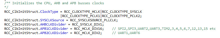

We have 42MHz on APB1 (168MHz CPU). Cube IDE generates the code for setting the baud rate in UART_SetConfig (via some extremely convoluted code) and my tests show good accuracy 2400-921.6k which is all I need at the top end, but I am trying to achieve compatibility with other stuff I have done and go down to these
30, 37.5, 50, 75, 100, 110, 134, 150, 300, 600, 1200...
The table in the ref manual for a 42Mhz clock shows this
and nothing below that but even 1200 baud doesn't work (it generates ~ 4k so probably some integer overflow).
This is with x16 oversampling; x8 makes it even worse. This is the relevant bit
Looking in the reference manual, there seems no obvious way other than to drastically slow down APB1, which we can't do because we are running some fast SPI stuff off that. There seems to be no other prescaler there, but maybe I am missing something obvious? And googling for hours finds nothing, other than the usual tons of negative comments on the ST "code generator", and one article which found an int32 overflow bug with CPUs running above 172MHz.
Could one use one of the timers for the clock?
Thank you for any ideas. No; I don't need 30 baud :) but 110 is still used in some very old kit, and 1200 is definitely used (and should work IAW the above).

Could anyone have a guess why setting 600 as the baud rate simply does not work regardless of the clock setting?
1200 works (with a 42MHz pclk) so going down another 4x should produce 300 baud :) But instead at 600 baud one gets ~9400 baud so clearly something is broken.
Yes indeed I may dump that ST code and just create a table of values to load in there.
UPDATE:
There is no mystery anymore really... The ST code generates a function SetSysClock for setting up the clocks but it doesn't call it. Another one is also created and that one is getting called: SystemClock_Config. Now I am using these settings
and I get a minimum baud rate of 161 baud on uarts 2,3 which run off APB1 which with DIV16 is 10.5MHz. The minimum baud rate on uarts 1,6 which run off APB2 which with DIV2 is 84MHz, is about 1285 baud.
So basically the lowest baud rate achievable using any UART on the 32F417 at 168MHz is 161 baud. 150 baud could be achieved with a 150MHz core clock. This involves setting the slowest possible APB1 (or APB2 depending on which UART / SPI / timers you don't want to screw up) clock speed.
No real issue with the top end, with 460800 fine on uart 2,3 (won't go higher) and 921600 fine on uart 1,6 (will go higher but limited by drivers in this case).
The low baud rates are generated with great accuracy, as you might expect. The top ones achievable are generally no worse than 1% off, which is OK (10% out over 10 bits is still ok, unless the far end is doing auto baud, but few will be doing that at >> 115k).
« Last Edit: March 13, 2021, 11:00:18 pm by peter-h »

There are some mistakes in my posts above regarding which UARTs use which APB clock source. I posted a long correction but it has disappeared.
Also the ST32F4xx has TWO bits of code for setting up the APB1/APB2 clocks and the 2nd overrides the first, obviously. The first gets called from SystemInit which gets called from startup_stm32f407xx.s. This duplication of clock setup wasted a lot of time.

This thread is a good example of how shitty software can get in the way of exploiting the full capabilities of the hardware.
You should be able to get down to ~160.2 baud (10.5MHz) and ~1281.8 (84MHz) with the divider maxed out (FFFF = 4095.9375) - that is, assuming you've checked that the upper 16 bits of that register are indeed not used, and that 0 doesn't actually result in a "secret" 4096 divisor. ;)
As for the implementation, my guess is just a 16x PLL multiplier with a 16-bit divider (BRR itself), especially given that it does 16x oversampling. In 8x mode it ignores BRR[3].

"You should be able to get down to ~160.2 baud (10.5MHz) and ~1281.8 (84MHz) "
That is what I found experimentally - except that the 84MHz happens to be on PCLK1 which is 42MHz max, so the max is ~640 baud. Hmmm not actually sure; will need to re-test that.
The 10.5MHz has been set up on PCLK2.
I am glad that I wasn't missing something obvious :)
