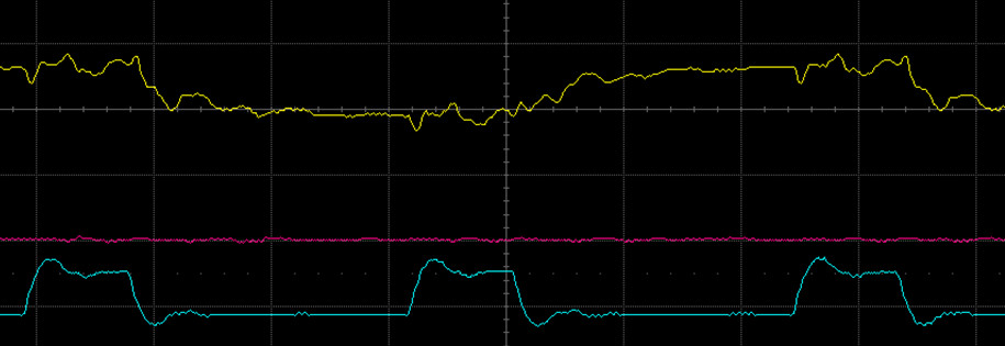

Online peter-hTopic starter
  • Posts: 5817
Moving to next stage of this, I did a quick and dirty test writing to an 8 bit port, in software, with a /wr strobe generated on another pin.
Ignore the crappy waveform. I don't have properly grounded probes etc. But this shows a 20ns (2 CPU cycle times at 168MHz!) wide /wr and an overall cycle time of 66ns which is 15MB/sec. A 1 cycle time (7ns) wide /wr is also possible, which surprised me. 20ns/div:
Data setup and hold times are tons. I am amazed how fast one can waggle a GPIO!
Here is the code - just a quick hack to output bytes on PD8-PD15 and /wr on PD2

Offline wek
  • Posts: 591
  • Country: sk
~20ns means 3 cycles.
When I did experiments back then when starting with STM32F4xx, I was unable to generate a 2-cycle long pulse by writing from processor to GPIO; only 1-cycle and 3-cycle. I believe this is due to the way how the GPIO's AHB bus is arbitrated within the bus matrix, but I am not an insider so there may be some other mechanism involved, e.g. within the processor's S port.
[As a curiosity, in those early days I experimented also with bit-banging GPIO on a NXP LPC1786 (Cortex-M3 but it should be mostly identical to M4 in this regard). At one point, the data hold delay to clock edge disappeared (i.e. instructions were write_for_clock_edge->write_for_data_change, and both changes appeared at the GPIO at the same time). Clock was written through bit-banding to the same GPIO port as data. My conclusion was, that as - contrary to STM32 - in LPC17xx GPIO is in the 0x2xxx'xxxx area, which by default is Normal (rather than Device), the processor was allowed to collapse both writes to one, and it did so. As at the same time we decided to select the more capable STM32, I've never gotten to proving this hypothesis (by setting the GPIO as Device using MPU).]
With DMA, things will get different again, the DMA will impose enough delay (IMO min 3 cycles) so this thing won't be observable. OTOH, the DMA's delays/latencies are relatively hard to calculate with absolute confidence, especially if other channels in DMA are used simultaneously.
Btw. you don't need to run benchmarks at maximum clock frequency, if you keep everything else set in the same way (e.g. FLASH latency): this is an extensively synchronous machine.
JW
  • Posts: 5817
That's funny; I now realise I found the same when packing the /WR pulse width with NOPs :)
I am now running this somewhat weird code, to get data out on PD8-PD15, with /WR on PD1, and no other PD bits (i.e. PD0, PD3-7) affected. Due to the BSRR weirdness there is a 256x uint32_t lookup table. It is in FLASH because I don't want to waste 1k of RTOS stack space. Generated by Claude ;)

I am getting a 70ns cycle to the LCD which is ~14MB/sec. The ST7789 min is 66ns. The only faster thing would be going to 16 bit parallel which means the QFP144 package and more hassle...
AIUI, no way to use DMA for 8 bit parallel unless one does one of these
- make sure the other half of the 16 bit port is all inputs, so writing to them has no effect
- prepare the data table to be 32 bit wide, containing BSRR values (in most cases this will be too wasteful if the table data is actually variable)
« Last Edit: June 16, 2026, 11:44:41 am by peter-h »
