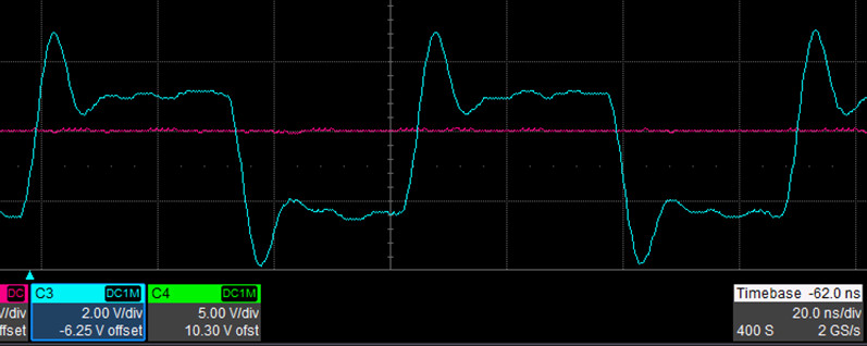

As an update in case anybody else tries this, this is TIM8 just doing PWM at 71ns cycle (ST7789 is 66ns min). It does 10 pulses and that's it. Perfect so far :)
// ── TIM8 PWM /WR burst test: 10 pulses on PC8 (TIM8_CH3), then self-stop ──
// Bench check for the future DMA scheme: configure TIM8 CH3 (PC8) as PWM, use
// one-pulse mode + the repetition counter (RCR) so the timer emits exactly 10
// pulses and then halts itself in hardware (CEN cleared by OPM). No DMA here -
// this just proves the pulse count and timing on the scope.
// TIM8 counter clock = 168MHz (APB2 timer clock). ARR sets the period, CCR3 the
// /WR low/high split. RCR = N-1 makes one-pulse-mode span N counter cycles, so
// OPM stops after N pulses.
// Scope PC8: expect exactly 10 PWM pulses then idle, with the period and duty
// set below. Re-run by re-arming (set CEN again).
// Adjust:
//   ARR  = period-1   (period in 168MHz ticks; 11 -> 12 ticks -> 71.4ns)
//   CCR3 = high-time portion (PWM mode 1: output high while CNT<CCR3)
//   RCR  = pulses-1   (10 pulses -> 9)
// Clock the timer and the GPIO port
__HAL_RCC_TIM8_CLK_ENABLE();
__HAL_RCC_GPIOC_CLK_ENABLE();
// PC8 -> AF3 (TIM8_CH3), push-pull, very-high speed, no pull
GPIOC->MODER   = (GPIOC->MODER   & ~(3u << (8*2))) | (2u << (8*2));   // AF mode
GPIOC->OTYPER &= ~(1u << 8);                                          // push-pull
GPIOC->OSPEEDR = (GPIOC->OSPEEDR & ~(3u << (8*2))) | (3u << (8*2));   // very-high
GPIOC->PUPDR  &= ~(3u << (8*2));                                      // no pull
GPIOC->AFR[1]  = (GPIOC->AFR[1] & ~(0xFu << ((8-8)*4))) | (3u << ((8-8)*4)); // AF3
// Timer base: period and prescaler
TIM8->PSC = 0;          // no prescale -> 168MHz counter clock
TIM8->ARR = 11;         // 12 ticks -> 71.4ns period
TIM8->CCR3 = 6;         // high while CNT<6, low while 6..11 -> ~half/half
TIM8->RCR = 9;          // 10 pulses (N-1)
// One-pulse mode: timer stops itself after the RCR burst
TIM8->CR1 |= TIM_CR1_OPM;
// CH3 = PWM mode 1, output enable
TIM8->CCMR2 &= ~TIM_CCMR2_OC3M;
TIM8->CCMR2 |= (6u << TIM_CCMR2_OC3M_Pos);   // PWM mode 1
TIM8->CCMR2 |= TIM_CCMR2_OC3PE;              // preload enable
TIM8->CCER  |= TIM_CCER_CC3E;                // CH3 output enable
// Advanced-timer outputs need MOE (main output enable) in BDTR
TIM8->BDTR |= TIM_BDTR_MOE;
// Force an update to load PSC/ARR/RCR/CCR3 shadow registers
TIM8->EGR = TIM_EGR_UG;
// Start: generates 10 pulses then OPM clears CEN automatically
TIM8->CR1 |= TIM_CR1_CEN;
// (To repeat the burst: TIM8->EGR = TIM_EGR_UG; TIM8->CR1 |= TIM_CR1_CEN;)
and this is the PWM waveform (ignore the ringing - bad probe earth)
« Last Edit: June 17, 2026, 08:57:54 am by peter-h »
