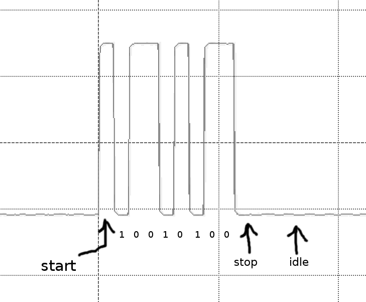

I have a background in C and Java but recently starting playing with Verilog and a Nexys2 (Xilinx Spartan 3E) dev board. I wrote a couple modules: one module listens to a ps2 keyboard and outputs the scan code, the other module takes that scan code and shifts it out the DB9 port formatted as 9600 8N1. The keyboard module outputs to an array of 8 LEDs on the dev board. The rs232 module takes those 8 IOs as it's input.
With my code, shown below, it works fine. The 8 LEDs and the TX line of the DB9 correctly reflect the scan code from the keyboard. If you simply change the name of the ps2keyboard module instantiation from "keyboard" to "kbd" then LED #7 (the "MSB") is always lit. Even weirder is that the output from rs232 is always correct -- bit 7 always correctly reflects the scan code value. Only the LED is "stuck."
I can't figure it out. I can't even see why changing the name of an instantiated module (which isn't referenced anywhere else) would have any affect at all. Timing issues seem to be common FPGAs, so maybe that's it? I don't know how to proceed. With a microcontroller I would use my debugger and start stepping through code, but with an FPGA...?
Video clip showing the problem:

For what it's worth, the problem even happens if nothing is plugged into the ps2 port. The bug is consistent. Power cycling the board and reloading the bitstream does not change the behavior. Any help is appreciated.
-Farrell

Another possible issue - how sure are you that the RS232 output does not have the last bit set?
As far as i can see on the video, it's indistinguishable from the continuing high line.

I thought I read somewhere that Xilinx tools automatically init all values to zero? I added the initial block, but it did not help. In any case, I'm not sure that would have been the problem anyway: the first keypress would overwrite any corrupt data, and if currentBit started out non-zero, the bit order would have been offset, but it was never offset. (The lower LEDs (bits) were always correct when the upper LEDs were stuck high.)
As for the RS232 output, I'm counting the individual bits on the scope. The MSB is low (+7V due to inverted logic of RS232) as it should be. If the MSB was high (-7V) the waveform would look different.
-Farrell

Offline farrellTopic starter
  • Posts: 20
Re: Learning Verilog, Have Weird Bug, Don't Know What to Try
« Reply #17 on: November 23, 2014, 10:51:54 am »
Bassman59: I had not written a testbench, but just wrote a trivial one. Considering that this stuck LED problem even occurs when nothing is plugged into the PS2 port, I wrote this sorry excuse for a testbench:
forever
begin
#1 clock = ~clock;
#1 clock = ~clock;
#1 clock = ~clock;
#1 clock = ~clock;
#1 clock = ~clock;
ps2clock = ~ps2clock;
end
And all 8 LEDs are logic 0 in the sim as expected.
hamster_nz: I added NET "clock" PERIOD=10ns; to my UCF, but the problem persists.
mrflibble: I have tried Project > Cleanup Project Files, and redone the synthesize/implement/generate file steps, but the problem persists. I have the -500 version of the Nexys2, and the LEDs work fine in other projects. How would I go about inspecting the synthesis results?
-Farrell
  • Posts: 20
« Reply #20 on: November 23, 2014, 09:50:53 pm »
I think I got it fixed! Finally!
First, I tried a bunch of things that did NOT fix it:
1. Changing the UCF assignments didn't help. The bits were reassigned to different LEDs, but the left-most LED that was stuck stayed stuck... it did not follow the new pin assignment. The LEDs that weren't stuck correctly reflected their new assignment.
2. Even commenting out the LEDs in the UCF and just having the ps2keyboard module output wired to the rs232_transmitter module didn't work. The stuck LED was STILL LIT. I'm raging pretty hard now...
3. I installed the Xilinx and Digilent software about two years ago (but just recently did anything past HelloWorld stuff) so decided to try the latest software. Out of frustration I decided to take the nuclear option: setup a whole new VM, installed a virgin copy of Windows 7, installed all Windows Updates as of last night (that took forever!) and the latest version of ISE WebPack and Digilent Adept. Tried it out, and the LED was still stuck. Words can not describe my anger.
Finally, success:
I had been loading my bitstream directly into the FPGA during all of this development and debugging. I decided to try loading the bitstream in the platform flash to see if anything would change. So I changed the FPGA Start Up Clock setting from "JTAG Clock" to "CCLK", regenerated the bitstream and flashed the board. FINALLY. It works properly now. I did not change anything else. I did not touch any PCB jumpers, etc.
Why might this have fixed the problem? Was the Adept software not properly "erasing" (not sure if that's the right word) when loading the bitstream into the FPGA instead of into the platform flash?
-Farrell
