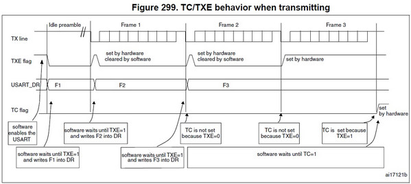

On a related topic, there is weird stuff going on with the TXE and TC bits. You would think that when both go to 1, the UART is empty and you can drop the driver. Well, TXE works as you would expect but TC doesn't. Not sure why; no way to single step through it.

When you load a byte into the transmit holding register, the propagation delay to it starting to shift out is anything from about 1us, to 1 bit time of the selected baud rate.
If you look at the block diagram of the USART, fig 296 in the RM, you can see that the transmit control block, and hence the shift register, is clocked by the bit rate.
Note that the bit rate counters are running continuously, from descriptions scattered in several other points.
So, very well hidden information, but there nonetheless.
I see no errata on the TC/TXE flags behaviour, how does it differ from what is shown in Figure 299?

In practice TC=1 seems to happen more frequently. Also the diagram doesn't mention if TC is ever cleared by hardware, which certainly seems to be the case.
What I have been trying to do is what I have done with various UARTs over many years: write an "output queue count" function which returns not just the #bytes in the circular buffer but also adds in the #bytes in the UART itself. And if this is done right, when the returned value falls to zero, you can disable the RS485 driver.
Of course this can also be done by an interrupt from TC, in the 32F4 case, but a lot of UARTs can't do that. So the "opqcount" function
- gets the buffer size
- adds 1 if there is a byte in the TX holding reg
- adds 1 if there is a byte in the TX shift reg
What I am finding is that the first works fine (obviously!), the 2nd works (TXE) and the 3rd doesn't (TC) because TC almost always returns 0. Well, it returns zero because we interrupt off it and the ISR clears TC to prevent the interrupt from reoccuring which it seems to even if that interrupt source is disabled.
I imagine that if the UART was entirely polled, TC will work correctly.
So we are creating a "proxy TC" flag which is set by loading a byte into the UART and reset by the TC=1 interrupt. Polling this flag, together with polling TXE, should enable the determination of whether there are 2,1, or 0 bytes in the UART.
« Last Edit: March 17, 2021, 10:42:09 am by peter-h »

I'm not sure what you're trying to achieve with the 'output queue count' or the 'proxy TC' thing.  Surely your code that handles transmission can simply keep track of how many bytes remain to be relayed into the USART for transmission, then once the USART has been given the last byte, wait for the TC flag to be set and then disable the driver?  That's kind of the whole point of TC, to know when the actual transmission is complete, versus TXE, which indicates that the USART is ready to accept another byte for transmission, which due to double buffering or FIFOs will usually occur before the previous byte has been fully transmitted on the wire.  If you were doing interrupt-based sends you would enable the TXE IRQ initially, load the next byte each time that fires, then once the last byte has been given to the USART you would disable TXE and enable the TC IRQ, and then once the TC IRQ goes off you disable the driver (or do whatever else) and stop transmission.  DMA would be similar, with transfers triggered by TXE, then once the DMA transaction is complete you'd enable the TC IRQ.
This problem--where the ISR is re-entered immediately after the ISR disables the TC IRQ--I recall having run into, and I suspect it has something to do with the way that changes to the interrupt mask bits are handled versus the flag bits, such that by the time the write to clear TCIE propagates through the control block logic to clear the USART IRQ line the ISR has already exited and the NVIC has already pended another TC IRQ.
But in general you need to clear status bits like that anyway, because if the hardware doesn't clear them you'll immediately get an interrupt when you re-enable that source later on.  TXC does actually get cleared on the 417 by reading the status register and then writing to the data register, but if you skip that sequence for some reason then you need to clear it manually.  Plus logically the TXC flag represents an event rather than a static condition, so in most applications once that event--the completion of transmission--is handled you're done and the system is in a different state, generally waiting for a response or sending a different message, so it doesn't make sense to retain the flag.

The reason for having an accurate "output queue size" value is that it enables more precise character spacing. For example Modbus requires a minimum of 3.5 character periods between packets, and less than this within a packet.
It was solved by having a "UART not empty" flag which is set by putting a byte into the UART and is reset by the TC interrupt. Then the "output queue size" function tests that flag in conjunction with checking the TXE bit and determines whether there is 1 byte in there or 2 bytes. If TXE=0 there are two, if TXE=1 there is just one. This works correctly at the end of a packet which is the important place, but at the start of a packet the count goes 0 2 3 4... because the 1 lasts just one bit period. At a few hundred kbps or more I do see 0 1 2 3 4... :)
« Last Edit: March 18, 2021, 01:35:23 pm by peter-h »
