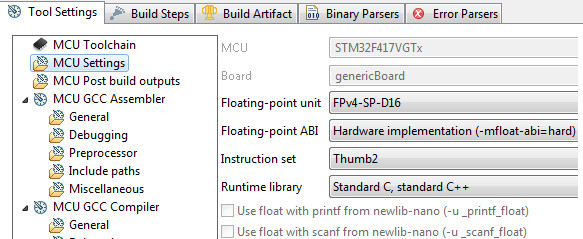

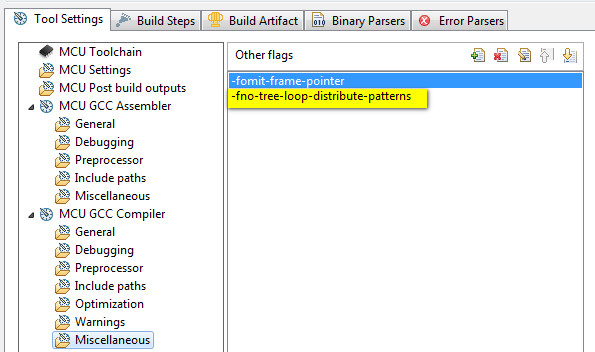

Offline peter-hTopic starter
  • Posts: 6154
Re: GCC compiler optimisation
« Reply #290 on: February 10, 2023, 09:26:24 pm »
May be useful in freestanding code, but there is a separate  flag for this anyway.
What flag is that?
That's exactly what I am doing (normally, e.g. a boot loader).
But also I wrote a faster replacement for memcpy, and the compiler recognised the loop and replaced it with a slower memcpy! That's just daft, and it got it wrong!
A -O0 function attribute does seem to work ok in suppressing these substitutions, at the cost of ~ 1/3 more code.
  • Posts: 6154
« Reply #293 on: February 10, 2023, 10:06:10 pm »
See the example code I posted.
It takes advantage of 25% of moves being fully aligned (src+dest), 50% of moves being partly aligned (src or dest), and (in the 32F4) still works with 25% of moves being fully unaligned.
Whereas the code in Newlib is suboptimal 75% of the time.
In the specific case of memcpy this is more complicated because while the byte-only memcpy is from Newlib, the full memcpy in one Newlib source I found
https://github.com/eblot/newlib/blob/master/newlib/libc/string/memcpy.c
does have the fuller source which does the long optimisation. My faster memcpy was based on that.
My current settings are below and thus my byte-only memcpy suggests that ST compiled that library for minimum size, but I think, from other stuff I found, only Newlib-nano should be doing that, but my settings here are obviously not going to change a precompiled library.
The flag is being used on the command line
And why would you want to prevent the compiler from doing that
In this case, the compiler isn't smart enough to know what runs faster on that particular CPU. I can understand why it called a sub-optimal memcpy but can I assume that it would replace am optimised memcpy with an even more optimised one? I don't think so.
« Last Edit: February 10, 2023, 10:08:31 pm by peter-h »
Online ataradov
  • Posts: 12513
    • Personal site
« Reply #294 on: February 10, 2023, 10:45:53 pm »
Library memcpy() is whatever it is. But if you just write your version in plain c and let compiler substitute internal implementation, you will get the same exact optimized version.
Here is test code:
void *memcpy_my(void *restrict dest, const void *restrict src, int len)
    char *dp = (char *restrict)dest;
    const char *sp = (const char *restrict)src;
    while( len-- )
        *dp++ = *sp++;
    return dest;
If you compiler this with -Og, then it would result in a simple byte by byte loop. But if you use real optimization levels, then it generates the same code that checks alignment and does whatever is necessary to take care of the edge conditions:
arm-none-eabi-gcc -O3 -mthumb -mcpu=cortex-m4 -fno-tree-loop-distribute-patterns -mno-unaligned-access  -c test.c -o test
And if you remove -mno-unaligned-access, then it will generate a simpler version of the code that uses unaligned word access, which is still plenty fast and not worth thinking about in practice.
