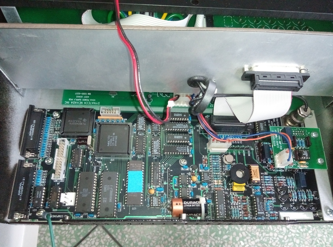

My test analyzer,The manufacturer has stopped providing after-sales support and calibration services,So I can only rely on myself or enthusiastic friends.
I disassembled the motherboard,The main MCU is a NEC D70320L,The main program is stored in M27C1001, and the calibration data is stored in AT28C64B
At present, it is normally used when starting up, but it has not been calibrated for a long time,I only found the video to test it, but didn't find out how to adjust it.
I successfully obtained the internal firmware of M27C1001 and AT28C64B chips, but I don't know how to read it
How do you know how to read firmware? Please tell me, thank you for your help

Offline pcprogrammer
  • Posts: 5002
Maybe give Ghidra a try. Not sure if it supports the D70320L and if it does it won't be easy and a lot of work to figure it all out.
There are several videos on youtube on how to use Ghidra.
Offline abyrvalg
  • Posts: 851
D70320L has Intel 8088 instruction set, there are many disassemblers supporting it (Ghidra mentioned already, IDA Free etc).

Offline alm
  • Posts: 2903
Do you need to adjust it? Just because it has not been adjusted for a long time does not mean it needs adjustment. Even in a commercial setting, just verifying that it's still performing within specifications could be enough to slap a calibration sticker on it. Of course if it needs adjustment, then you'll need to figure out how.
What kind of I/O does this have? Does it have its own front panel? Does it interface with a computer? If it has a computer interface with human-readable commands, and you have software that works with it, then I would start my sniffing the communication using software on the computer side (how depends on the hardware interface). If it looks like human-readable commands, then I would look for commands in the firmware you already dumped using a tool like the strings command.
Reverse engineering the firmware would require quite a lot of effort and would be my last resort. It would probably require at least some hours of work, so I don't think it's fair to ask someone to do it who does not own the equipment and hence would not benefit from it, unless you hire someone to do it.

Offline abyrvalg
  • Posts: 851
Looks like there is some pretty user-friendly calibration UI saying what signals to apply, what to adjust etc. The hw self-test procedure looks very informative too: for each kind of error it tells IC/pin/voltage to check, i.e.:
TC error.    Press ENT key to continue.
DAC1 U30 pin 7 output of -4.8 volts.
2.4 volts on these points: U3 p7, TH4,
         U4 p9 (TC output), and U5 p7.

Offline abyrvalg
  • Posts: 851
From disassembly it looks like there is some multilevel menu starting with "MAIN MENU" and calibration is one level deeper. Try entering various menus on the instrument (btw, that should be much easier than disassembling the firmware).
Update: indeed, the calibration menu is not accessible from "main menu". To activate it, you need to press ENTER and (or then?) F1 quickly when the instrument says "...SYSTEM INITIALIZING..." during start. Have fun :D

Offline abyrvalg
  • Posts: 851
Wrong. You need to press them (one by one, I think, press ENT, then press F1) when it already shows “…SYSTEM INITIALIZING…”. The time this message being shown is the key press waiting time.
  • Posts: 5002
You did not try:
1) power on and wait for message "system initializing" (which seems to be shown immediate")
2) press "ENT".
3) press "F1"
But you have to be quick, because the initialization state does not last long, by the looks of it.
  • Posts: 5002
No what I mean is, turn it on, then press/release the "ENT" key and then press/release the "F1" key. So in following order, 1, 2, 3. At least that is what I get from what abyrvalg wrote.
Online daisizhouTopic starter
  • Posts: 995
  • Country: cn
Very good. I entered the calibration mode smoothly according to your suggestion.I see the "Calibration" menu on the menu,When I press to enter "Calibration", it appears to let me set the time. I also set it, but finally I return.
