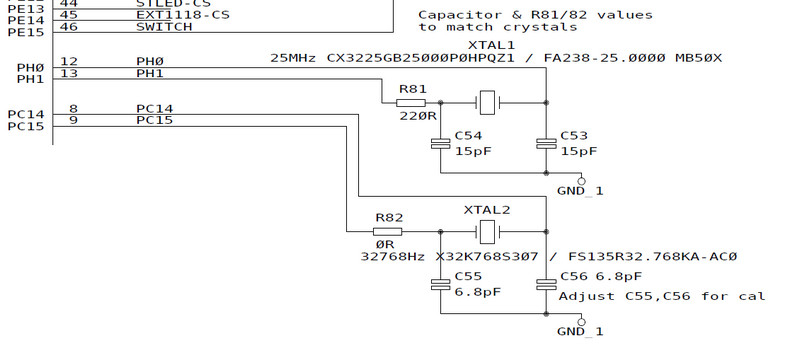

  I am trying to design my own board with an stm2g473, and am lost when choosing the crystal. I need a 25MHz oscillator, and woulf prefer a rather small SMD quartz, apparently 3225 is rather standard and easy to find.
  I tried reading the AN2867 document from ST, and using their spreadsheet, but there is always some information missing (e.g. they say to look for "Cs"  "From the MCU datasheet  + Estimation of CPCB", but I don't know how to estimation what I think I Cpcb and could not find the info for the datasheet...
  Can someone help ?
Thanks, J.

Crystals are a funny business.
The reality is that most of them work :) And if not needing accuracy, the capacitance is not that critical.
You quickly discover that the big brand xtals like Kyocera and AVX are pricey but well specced, and the no-name chinese ones are far cheaper but you may not get the same ones every time (because with most chinese stuff most people are reselling and nobody knows where some batch really came from). I have found to my irritation that a lot of the cheap xtals I had been using for years have been taken over by Abracon and the price went up 5x.
For example, for the 32F417 I use these branded xtals
but if you put those P/Ns into say mouser.com you find they are not exactly cheap and frankly I doubt many people use them in 1k+ volume. And in 100k+ volume the branded ones will be cheap :)
The cheapest one with the same spec as the CX3225 is the 815-ABM8G-25-18D2Y. If you are free to choose the package, Murata (a reputable make) do cheaper ones. But they only go up to 12pF. e.g. XRCGB25M000F1SBDR0
The xtals in the ST appnote are either expensive or obsolete.
You guess how many pF the PCB tracks will add. There is info online. 1-2pF usually.

Ok, so I I try to put it all together, i can :
- Start with e.g. https://www.lcsc.com/product-detail/C2901687.html (because 1/ it's available in large quantities so probably easily avilable if I want someone to make another board 2/ it cna be ordered in minimum quantity of 5 so it ends up cheap and 3/ it is 20pF so maybe easyer to match than the 10pF ones ? Also the values in the datasheet seem to match what the STM spreadsheet expects)
- Take 25r as an estimation for ESR (datasheet says "25r between 20 and 54MHz")
- Take 3pF for C0 (datasheet says 3pF max)
- Take 13pF for CL (datasheet says min 6pF, max 20pF)
- Take 10pF for "Cs (total in pF) (estimation taken from stm32g473 datasheet)
The spreadsheet tells the gain margin is 39.58 (good enough), and `CL1=CL2=6", so I use 6pF capacitor and that should be work ? I test the frequency by having the MCU output the frequency and inspect it with and oscilloscope, and if it is too far from 25MHz I try other values for the capacitors ?

Unless you're especially concerned with frequency accuracy, that's not really the risk. Get the capacitance or layout wrong, and there's a chance that the oscillator won't start reliably under certain conditions of temperature, voltage, and sample-to-sample variation.
Personally I have better things to do than worry about this stuff, which is why 99% of the time I use oscillator modules rather than 'bare' crystals. They're small, robust and reliable, which is way more important in my case than a small cost saving.

As peter said, I have yet to witness any case of a problem with those MCUs using pretty much any crystal with loading caps as spec'ed in the crystal datasheet.
Yes, you should take the parasitic capacitance into account (mainly PCB), but unless you have a very specific stackup or a very lousy layout, it will only add a couple pF which will usually be within the tolerance of the external capacitors themselves. In other words, it doesn't make a difference. The possible shift in actual frequency will usually be negligible relative to the rated initial accuracy of the crystal.
If you need very accurate oscillators, you will use a much more elaborate oscillator configuration anyway.
In practice, only in very specific cases, such as ultra-low power 32.768 kHz oscillators, can you run into real issues of unstable or not starting oscillators at all.

If you have a freq ctr, or a GPS 1pps, you can test the exact crystal total operating C, - see curve below.
You've chosen a 10ppm model, which makes checking CL easier as you know the crystal operating point fairly precisely.
The absolute value is not critical, they just move their calibration point along this curve.
Smaller CL crystals mean less gain degrade, so they are more preferred for higher Mhz.

..The possible shift in actual frequency will usually be negligible relative to the rated initial accuracy of the crystal.
That was broadly true back in the days of 100ppm crystals, but these days 10ppm crystals are becoming standard. (The OP links a 10ppm model)
With those you can take the trouble to step the C's in 1 or 2pF increments to centre the crystal.
You can also use different C values, as the XIN pin has a higher pull-ability than XOUT.
