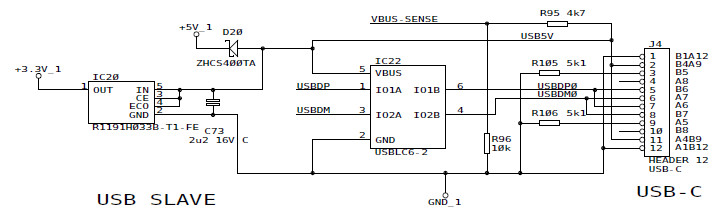

I've just done a prototype for something and left a track off which connected the "GND" junction of the two resistors to GND, so there was just 10.2k across A5-B5.
But it all works fine.
Due to the way the connector is reversible, there are actually no resistors visible at all.
Can anyone explain it? I've googled and find only fairly meaningless explanations.
My device is a client and draws about 200mA. It has no OTG capability. The client device is a STM 32F417 USB FS. The Host device is various types of USB hub, some USB2 and some USB3.

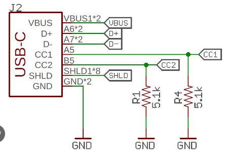

With a real USB-C host, this is not just for orientation (which usually doesn't matter if you strictly use the D+/D- pairs, which are themselves supposed to be paralleled on your device in 99.99% of the cases), but primarily to make the host detect your device as a USB device. Otherwise, it won't even care to enumerate it. In theory, you could do with using only one of them on either CC1 or CC2, except that "standard" USB-C to USB-C cables only have one wire for CC (which is precisely made to enable orientation detection, when it matters), so that if you put only one of these resistors in your device on either CCx, it will only work in one orientation as the host won't see the device as a device in the other orientation.
So omit those two resistors, and your device won't work when connected to a real USB-C port. And omit one of them, and cables will work only in one orientation: nice way to irritate your customers! That may not be widely available on typical desktop computers yet, but most laptops do now and some don't even have USB-A ports anymore. So you really don't want to play with that. It won't feel nice.

Any super-speed cable or cable that can carry alternate modes (displayport/thunderbolt) are e-marked.  As are any cables that can carry > 3 amps.  Unmarked cables are always USB 2.0 speed only, 3 amps max.
A USB type-C host or power supply will not even turn on VBus until it detects Rd.  So if your device is bus powered, it will not even power up when used with common charger.
