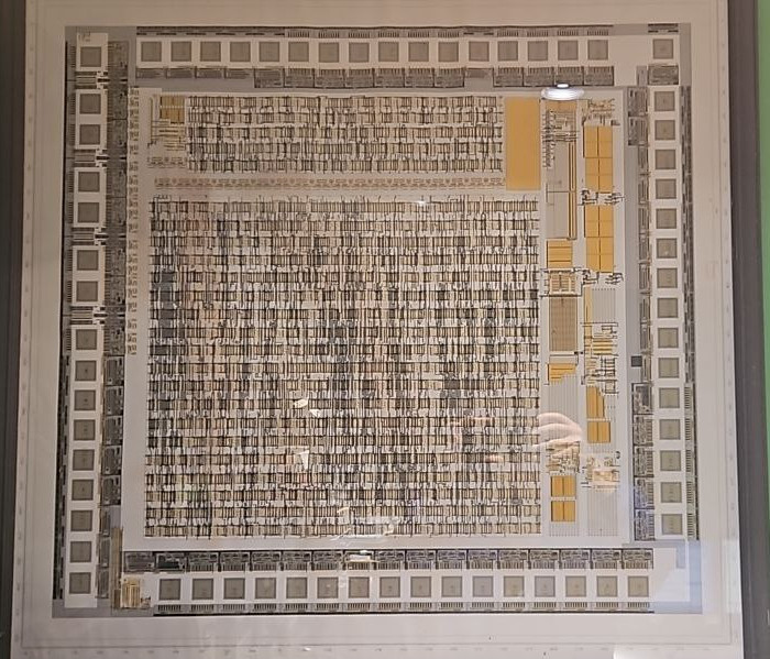

I need help analyzing these two chips. Can anyone tell me if they are microcontrollers or FSM STATE MACHINES, the links to the photos are:
https://zeptobars.com/en/read/Casio-F-91W-OKI-quartz-watch
https://zeptobars.com/en/read/Casio-F-91W-quartz-watch-homage-china

I would guess that it's a FSM. No need for a µC to increment several counters.

Those Casio watches are extreme low power, and as the zeptobars site states, they run 7 years or longer from a single button cell. That alone makes an uC unlikely, and also considering the amount of these things made, (and being from Casio) a custom (possible FSM) solution (Maybe just a counter, with an added FSM for time setting and handling button presses etc) would be my first guess.

Standard cell layout. No obvious instruction ROMs nor RAMs.

Many years ago I did an ASIC design (simulated in a Xilinx FPGA) for a low power RTC. It used a ripple counter, which is the lowest power implementation because you are clocking on the bit actually changing.
Even so, it was not optimal; IIRC it drew about 1uA. With a proper silicon design you can get it down to 100nA or less.

This is very likely just pure logic, the bulk of which being counters and registers and yes, a FSM. After that you have LCD drivers, a driver for the beeper, a driver for the backlight LED, debouncing input blocks for the buttons and the oscillator. As the picture below suggests, there may also be a charge pump, probably to generate a bias voltage for the LCD.
As can be seen on the die, this is an OKI IC. Casio started to use OKI watch ICs in the 70's and while I don't know what's current in the latest CASIO watches, I suspect that they still largely use OKI ICs, at least for their simpler models.
Interestingly, you can see a (c) 2006 marking on the die itself, suggesting that this die was a respin of the original IC they used in the late 80's. This is still on a relatively old process node. Likely > 1 µm. The die is also marked "05MG137-A01", which is probably its OKI reference. Couldn't find anything much from this reference, but not too surprising as theses ICs are not "off-the-shelf" stuff.
Being powered from a CR2016, if we take the bottom of the typical capacity (about 80 mAh), 7 years of operation equate to approx. 1.2 µA of average current for the whole watch, probably including occasional use of the backlight and knowing that the LCD is operating 24/7, this wasn't bad at all in the late 80's. It's still not bad by today's standards.

This was my RTC + logic design
Spot the similarity :)
The RTC ripple counter is the logic block at the top. The main logic block is just random logic (MFM encoder and decoder for a 3.5" diskette emulating product called Smartdisk).
Almost 30 years ago...

A perpetual calendar (like you get in 20k+ mechanical watches :) ) is easy to do in logic.
As are five stopwatches.
And those circuits draw power only in the logic currently being clocked, which is maybe 0.1% of all of it. But a CPU draws power all over all the time (unless the clock is stopped for say 999ms out of every 1000).
