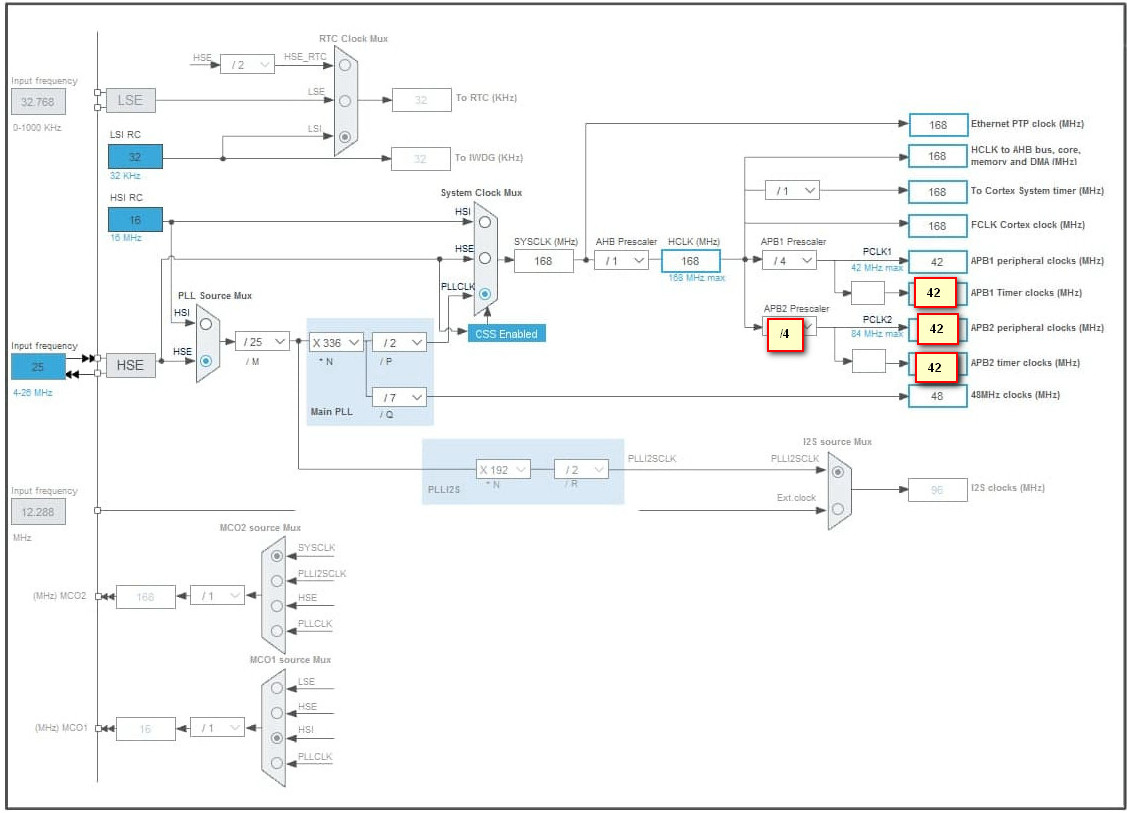

I've compared the PLL config register for the two mfgs and struggle to see the difference, other than different max clock values (240MHz v. 180MHz etc).
The problem is that this stuff needs a deep understanding... In Cube IDE you get fairly easy config, and if you want it really easy then you have the Cube MX GUI config (which someone originally did on my project and which never needed changing substantially - edits below done on actual registers).
Maybe the differences are elsewhere e.g. the RCC config.

It must have been some other GD device. I don't see any obvious differences here either.
If you want simple - stick with ST, this is why they cost more - they need to pay salary to people that do those UIs.
You are approaching that wrong anyway. If you need to treat GD device as an entirely new device that needs full porting. It may be highly compatible, but you won't know for sure until you go over all the peripherals you use and check that they do what you expect them to do in a new device.
Alex

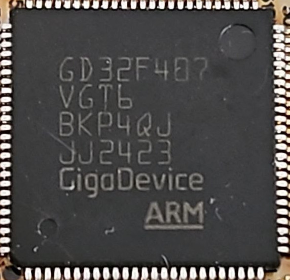

Well, I am going to spend an hour of my life soldering the GD 407 to a working board, which uses USB FS, ETH, Free RTOS, FatFS, MbedTLS 2.x, LWIP, you name it.
Taking bets on it working. €1 ;)
Offline peter-hTopic starter
  • Posts: 4637
Re: Opinions on ST 32F407VGT6 versus Gigadevice GD32F407VGT6
« Reply #54 on: March 28, 2025, 11:48:20 am »
Good job I didn't specify which way the bet was ;)
Verdict: it is totally dead. The ST-LINK Utility says: no SWD.
I selected the 407xG device on the programmer.
Even reading memory fails.
I even hand soldered the chip on (rather than reflow), under a microscope, and checked every pin joint for integrity. Unless I build up another board, and that runs, I reckon there is some SWD difference on this chip.
Should these chips show some kind of life when powered up? AIUI they start internally at 16MHz, using some on-chip oscillator, not the external 25MHz (in my case) xtal. And I am sure it needs that clock for SWD to work.
VCAP1 & VCAP2 are both 0. Practically no current being drawn.
« Last Edit: March 28, 2025, 12:26:01 pm by peter-h »

I'd expect them to start from HSI - after all, there might not be a crystal on the board at all.
VCAP = 0 is pretty telling. The internal regulator should be alive even with no code running, and I'd expect to see power before SWD would work.
Do you know for certain that these chips are pin-for-pin drop-in compatible? ST themselves do like to budge pins along a bit when they release similar (not not identical) parts in the same physical packages. Are the power and GND pins actually the same ones? What about BOOT0 or NRST?

The GD 407 was bought from LCSC in China. Maybe they are fakes? I've had empty packages from China... Maxim, Hitachi...

Nobody is going to fake GD devices.

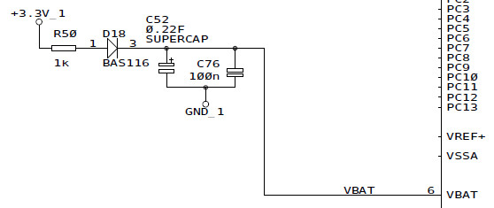

The RTC supercap doesn't charge past 1.35V (supposed to go about 3V, over a few mins, charging from +3.3V via 1k and a diode). This is weird.

The GD 407 chip was mounted on a fully working 32F417 board.
A google on
GD32F407VGT6 usb fix
digs out some hits e.g.
https://forum.chibios.org/viewtopic.php?t=6008
but this is too complicated for me to work out. I am not using OTG, btw.
I also did not test the boot loader which allows remote firmware upgrades. This is unlikely to work.
