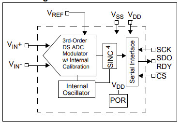

I would think using a differential input ADC, like the MCP3550, is the way to go for any precision.
That chip works down to GND minus 0.2V or so, too.
You still have the problem of radiation from the SPI. On this chip that can be up to 5MHz, but arguably one should run it much slower, given the ~80ms conversion time. OTOH
- the SPI activity is outside the conversion period (so is there any point in running it slower?)
- if the SPI is used for other stuff, that activity (up to 10MHz on mine) can be inside the conversion period, unless the SPI is gated
Also, on a DAC, the SPI is obviously going to be active when the output is active ;)
I suspect precision is actually worse with a differential input, but the differential input makes up for it by rejecting common mode noise.

We had various threads on this. This setting is more a programmable Rds of the MOSFETs; not a slew rate control as such. Of course increasing the Rds impacts the slew rate into a given load capacitance...
Why would it be?
ISTM that delta sigma switched-capacitor ADCs are naturally differential input. Others might not be.

Why would it be?
The errors from each side still add together, especially with noise.
It would be interesting to know whether matching the source impedances causes cancellation of the correlated errors between the inputs.
Early designs tended to not have differential inputs, but I wonder if there was greater demand later for differential inputs to remove ground referred errors in single ground plane designs.  That is a big advantage of using a differential input, but previous designs using single ended inputs did work if the design was good.
To give a concrete example, each input has Johnson noise from the series resistance of its input switch.  Doubling the number of inputs to a differential configuration places these Johnson noise sources in series, increasing noise by 1.414 times.
For almost anybody using these ADCs it will not matter, because their design is not going to achieve the datasheet specifications for noise and precision anyway.
