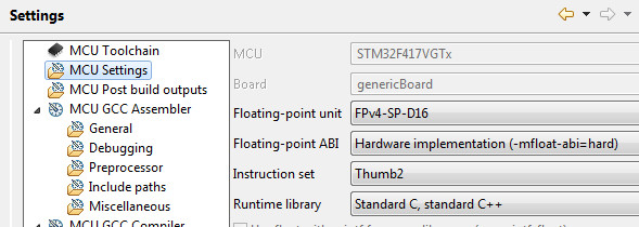

I got a reply from Spirit, surprisingly:
They don't support users, so I need to contact ST, to which I replied that I am not a car manufacturer, and I am happy to give them some money for a cortex-m4 lib which is actually usable :)
These are my global project settings and I really do not want to mess with that now
It appears that:
My project: -mfloat-abi=hard (VFP register arguments)
Library: -mfloat-abi=soft or -mfloat-abi=softfp (no VFP register arguments)
and the two cannot be mixed at link time even if I managed to edit the "makefile" to compile the mp3 decoder to use soft floats. Why this link time mixing is not possible, I don't get.

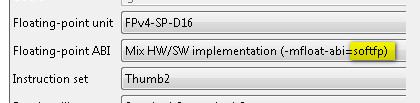

If I use this global setting
then the Spirit lib links in OK but now I get the same errors from my libc.a (which also came from ST as a compiled module only, but it comes in 100+ versions, which are extremely difficult to identify, and I spent ages on working on it because it had loads of dummy stubs for mutex calls, which had to be sorted out for RTOS usage to work). Some past threads on this horrible topic. This would be much more work, and importantly I will have lost 2-3 years of reliable product operation which I now have behind me. Libc.a has sscanf, the heap, and other stuff.
This thread suggests that the linker can mix the different fp models and that its refusal is due to declarations in the code, which can be stripped out

The funny thing appears to be that Spirit code does use the FPU but they call it directly, while building their .a library under the pretence that they use soft floats (i.e. do not use the FPU). This is a real hack and I wonder why anybody would do this, and then label the finished lib as "cortex m4", where most (if not all?) chips have an FPU. This hack will break FreeRTOS which saves the FPU context.
