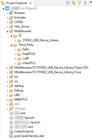

I have a Cube IDE project which comprises of
- some ex Cube MX (the STM "code generator") code, largely modded to remove bloat; the project was started years ago with this bit
- ST port of FreeRTOS (very few mods were needed)
- ST port of LWIP (lots of mods were needed)
- ST port of MbedTLS (lots of mods were needed)
- ST ETH code (loads of mods again)
- ST USB code (client only - CDC & MSC) (load of mods needed)
- ST port of FatFS (very few mods)
- interface code for SPI serial FLASH
- interface code for a number of serial ports
- a couple of LWIP-interfaced modules written by outside people (no doubt they will recognise this ;) )
- a ton of code I wrote over the past 2 years of my life; stuff which defines what the product actually is, an API for a ton of stuff, and countless bug fixes to stuff above, revealed in extensive 24/7 testing
The project is in a directory tree:
and since I didn't set up the ST port stuff, I don't know where and how these directories are set up, but I don't need to know. I know how the stuff I've been writing last 2 years works :)
I am not posting what this thing does :) but I can say that in some application contexts there will be outsiders (with C expertise) writing their own modules. They will be given the whole Cube project, with an example file like hello.c. I will absolutely not be supporting ST Cube and creating a project from scratch; that is way beyond the call of duty.
And the idea is that their life will be far easier than if they were coding for some development board (these normally come with example code but usually it is crap for anything beyond trivia) or for some "hobby board" (which tend to be mechanically unsuitable for serious industrial use, as well as production-problematic long-term). For example LWIP and proper code examples will make the development of internet applications a lot easier.
And I don't want to give them all the source code. They can have the ex-ST code (even though the fixes to make it work probably amount to a man-year) because it is basically public-domain, but I don't want to give out the whole lot, especially most of the stuff which I wrote.
These other coders will write applications which run at base+32k (0x00008000) because the bottom 32k is a boot block which has various recovery features, etc. Obviously I won't publish the boot block code, too.
So I am looking for the simplest path to generate this "0x00008000" development kit.
