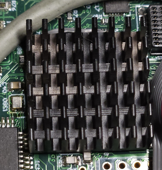

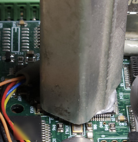

It would be an interesting experiment to stick a heatsink on an STM32 package and see what it does.
I did a quick test with a QFP100 32F417VGT6.
Measuring the chip temp (see the above linked thread on CPU temp measurement) I have
+46.5C no heatsink
+42.0C little heatsink (pic 1 below)
+33.1C "infinite" heatsink (pic 2 below)
heatsink 1 - 1cm high
heatsink 2 - a 10cm tall block of aluminium :)
Obviously a high grade thermal compound was used.
The PCB temp, measured with a PT100 on the PCB, is about +31C but the exact value of this as seen by the device is obviously important to understand the infinite heatsink result above. With a PCB to chip delta of only about 2C (2K for the purists) it certainly does look like the infinite heatsink is highly effective through the QFP100 package - just as I would expect given the chip is some 5x5mm and the plastic is only some 0.5mm thick. Similarly any decent heatsink, or a heat pipe setup, should be very effective.
The small heatsink is near-useless, but it is tiny. It would probably do something if you are running an H7 at +105C and there is some forced airflow around ;)
The following users thanked this post: thm_w, Siwastaja

The second "heatsink" is not necessarily better a heatsink. It may be also the way how you mounted it - it appears to me that you may have used too much thermal compound (which in fact has a very poor thermal conductivity and is intended to improve somewhat the conductivity by filling in the roughness, as it still has way better conductivity than air that would otherwise be there), and the heavier item might have squeezed out the excess better.
Also, would there be the same contact, the second is simply a bigger thermal mass (while having a great conductivity), so it simply might have taken a way longer time until it heats up (i.e. stops cooling). There might be some chimney effect along its length, but I doubt it would be that pronounced.
Btw. a nice experiment is to observe the internal temperature probe's output (provided it's filtered enough to stop fluctuating excessively) and then simply touching the surface of the package by the index finger. It's counter-intuitive, but given the internal is >37deg.C, the finger does provide observable cooling.
JW
Offline Siwastaja
  • Posts: 9779
Re: STM H7 lasting only 2 years due to heating
« Reply #18 on: April 07, 2025, 10:07:55 am »
Such solid block of metal is a good approximation of "inifinite heatsink" given that the test time is short enough, so while not very effective in actual application (poor weigh-to-surface area ratio), it's great for short testing. And I believe peter-h has no reasons to wait for more than a few minutes.
Correct amount of paste is very hard to see from images. Squeezing out is not a a bad sign (except losing $0.02 worth of expensive paste), these pastes are designed to squeeze. In fact, excessive amount seems like simplest way of reducing risks of voids, something which happens easily after reading misinformation online that "you must not use too much of the paste" or "use as little as possible".
But it boils down to the force being used. With enough force, excess paste is simply squeezed out, voids minimized and thermal conductivity maximized. Good thermal pastes are designed to flow easily enough so that required force to obtain thin layer is not too much to cause board flexing enough to destroy MLCCs etc. And on the other hand, if you press way too lightly, the paste is not going to spread. Then it's irrelevant if you used "as little as possible" or too much; it will fail anyway.
If you try to apply some "optimum layer thickness" directly (say 0.1mm), then you are guaranteed to have voids. It needs to squeeze, that way it gets everywhere. Optimum way to spread is to put a large blob in the middle (not spread it), press down evenly and observe it squeezing out from all four sides at approximately the same time.
Similar principles are relevant in stuff like screen printing or solder paste printing. The more, the better: excess squeezing out from every corner is the proof it is also everywhere it needs to be.
It is possible though that the weight of the "heatsink 2" contributed to good thermal contact. Maybe "heatsink 1" would have performed better if "heatsink 2" was used as a tool to press it down against the chip.

I made sure the compound layer was really thin. That first heatsink would be poor. Too small. Probably 50-100C/watt. It would work if there was a fan nearby but most people avoid fans; they always fail after some years due to dust.
Sure; that aluminium block would have heated up eventually :) I did see the CPU chip temp rising although very slowly. It was just a test to see how well heat flows out of the device, and clearly it flows very well. I think if one had to get rid of 1-2W (probably about right for an H7 with 105C Tj) then a little heat pipe arrangement would work well. One doesn't need to achieve much of a drop to improve device life dramatically.
The ally block (a part of an aircraft nose landing gear) had a very smooth and straight surface on its end. I machined it myself :)
One day I will go back to doing the Tj measurement properly i.e. calibrate the sensor. One has to hack the code to take the temp reading very fast (a millisecond) after power-up.

I don't think using a heatsink on something like a STM32F4 MCU makes much sense, sure you'll see a non-negligible difference, but between like 30°C and 45°C, who cares, that's barely tickling it.
For a H7 running at full speed, that's something that can be warranted depending on the environment, although I have rarely seen that done in practice.
That depends on the environment of course. The die temperature will be relative to the ambient temp so in hot environments, the die may more easily reach dangerous territory.
