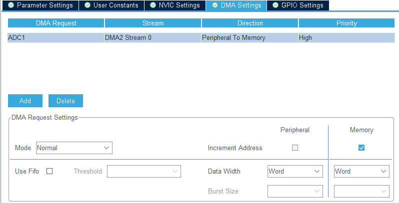

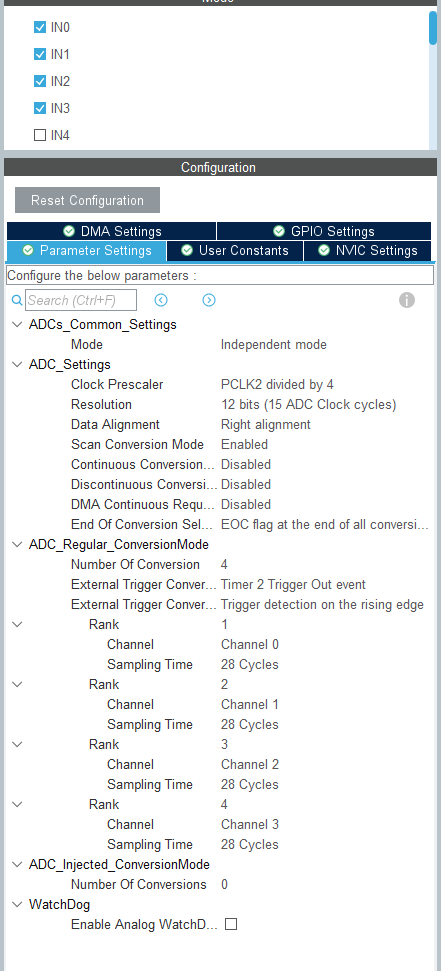

- Configured the ADC in Scan Conversion Mode
- Set it 4 Conversions and changed Rank 1 to Channel 0, Rank 2 to Channel 1, etc...
- Set it to 28 Cycles per conversion
- Set it to be triggered by the Out event of TIM2
Then I enabled the DMA of ADC1 to be in normal mode, I want to do a bunch of conversions at a time but only when I fire them, not all the time.

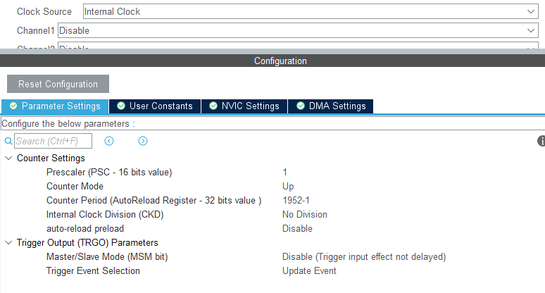

Then I configured TIM2 to fire at the rate I want. I decided I want to store around 200ms of data using around of 128KB of buffer, because that's like 65% of my ram.
I may have calculated wrong, but the timer clock is 160Mhz with a Prescaler of 1 and a Counter Period of 1951 I get a frequency of around 41Khz

There is one thing that helped. When I changed End Of Conversion Selection to EOC flag at the end of all conversions in the configuration of the ADC. It became more stable, reading correctly maybe 6 out of 10 times, now it oscillates between 3 values, 1 correct and two wrong.

« Reply #1 on: November 26, 2024, 09:17:08 pm »
ADC registers are 16-bit so DMA should be set to half word, and declare your buffer as uint16_t.
Try that first.

« Reply #2 on: November 27, 2024, 06:56:59 am »
Try that first.
Thank you, I already tried, I declared the buffer as uint16_t and set the DMA to half word, the function HAL_ADC_Start_DMA expects a pointer to uint32_t so I cast it like this (uint32_t*)ADC_BUFF; but the buffer is not filled. I remember reading somewhere that the buffer must be of uint32_t type.

« Reply #4 on: November 27, 2024, 03:03:04 pm »
Yes afaik you have to cast it like that.
