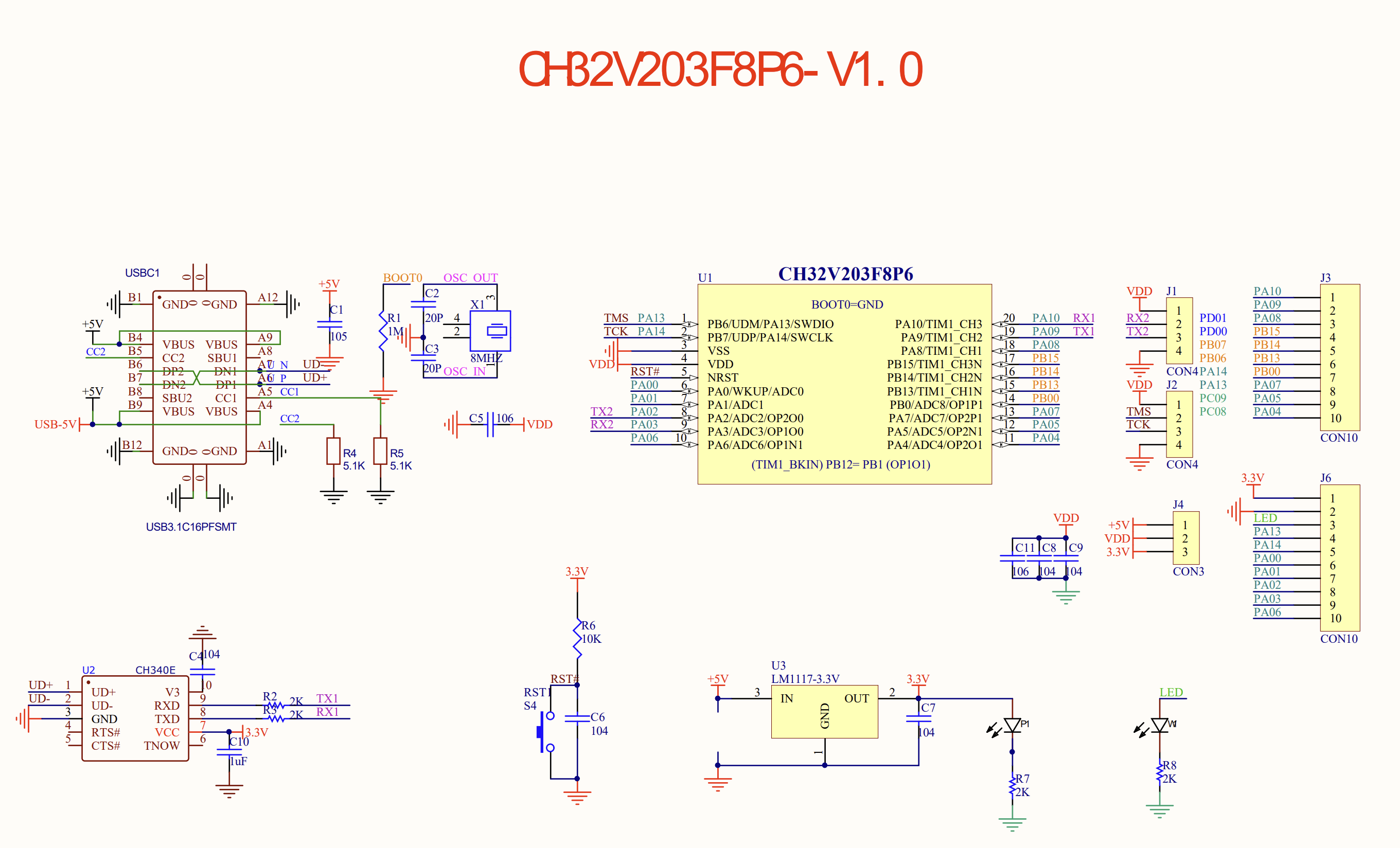

Ch32v203f8p6 suggested board schematic :
https://www.google.com/url?sa=i&url=https%3A%2F%2Fwww.cnblogs.com%2Fzxyy-%2Fp%2F16689243.html&psig=AOvVaw296XSjPBuPeeltaoA_LeMr&ust=1714917556959000&source=images&cd=vfe&opi=89978449&ved=0CBIQjRxqFwoTCLCGgNiT9IUDFQAAAAAdAAAAABAE

Online DavidAlfa
  • Posts: 6539
Suggested schematic... Show yours, and pictures of the real thing.
For example, capacitors must be as close as possible, not 10cm away.
Make sure the config bits are not enabling the Brown out reset.

Another schematic Link :
https://www.wch.cn/uploads/image/20231226/1703596323131395.png
Which gaveme the correction for the Uart TX/RX = PA9/PA10.
