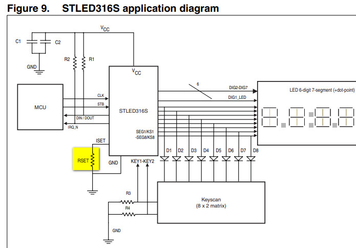

Can STLED316 brightness be PWM-controlled?
« on: May 20, 2026, 05:16:18 pm »
https://www.st.com/resource/en/datasheet/stled316s.pdf
The brightness is software-set with 3 bits. The steps are not very even.
There is also a resistor, Rset, which programs it linearly
and basically the range is 360R to 1.5k. Less than 360R exceeds the max rated segment current, and more than 1.5k has - according to the DS - little or no effect.
In my project I use both the 3 bits and Rset (which I switch 360R or 1.5k according to the MSB of the 4 bit brightness value)

I wondered whether pulling down Rset with a MOSFET driven from some suitably fast PWM (fast to not beat with the display muxing) would work?
Obviously there are 1000 ways to do this job but this chip is really handy for stuff like this

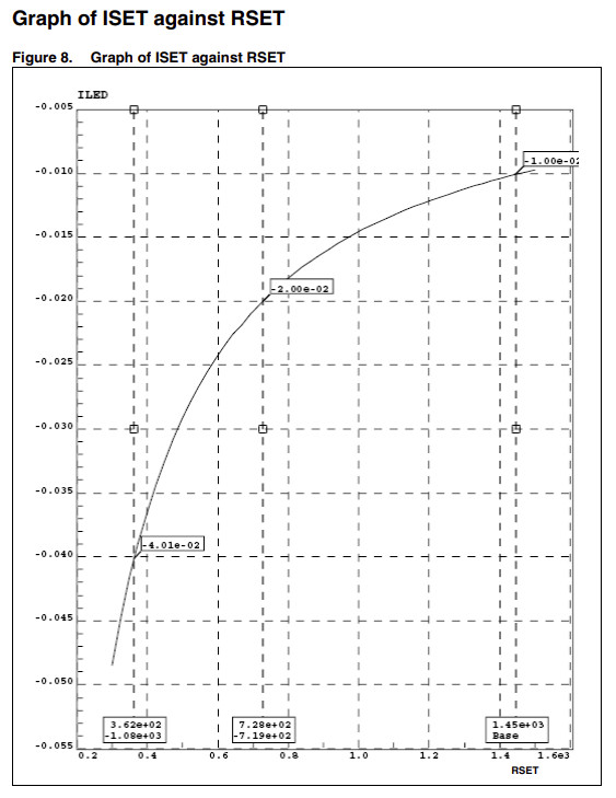

Rset values above 1.5k do nothing
do nothing little effect.
I would think you could control the iset current by sourcing the rset resistor from a dac or pwm instead of directly to ground. Less voltage across the R = less iset. Would be easy enough to try.
Offline peter-hTopic starter
  • Posts: 6029
Re: Can STLED316 brightness be PWM-controlled?
« Reply #2 on: May 20, 2026, 07:54:40 pm »
Looking at that Rset graph, 360R/40mA and 1450R/10mA is exactly in proportion per ohm's law. The fact that this is 14.5V when the chip is powered from 5V just means the current mirror is not 1:1. I've only just noticed that. Why did they publish a graph when a trivial formula would have been clear?
It also means that higher values of Rset should work and the 1.5k is probably just arbitrary.
However, to get "human eye meaningfully" low brightness you need to go into the < 1mA (average) region. I know this from LCD backlights which need a > 100:1 current range if you want to make a device to work in a low-lit room.
The 8 software steps give an 8:1 range so if Rset switching is used, that should have an 8:1 range also, but my circuit is just 4:1. But with PWM you should be able to forget the software setting, set it to max, and just use PWM on Rset.
I will do an experiment with a BSS138 on the bottom of Rset and feed it from PWM. But equally I bet a precision current sink on the Rset terminal should work equally. As in post #1 here

I did a test with PWM.
It does not work. You get a beat with the display mux rate. But this is set internally, at roughly 3ms per digit (so ~18ms to get around the whole lot) and will vary between chips, so you would need to dynamically measure this and the select a frequency in between :)
I also tried simply driving the bottom of the 360R Rset from the signal generator, 0 to +5V swing, and varying the duty cycle. That works too but you get horrible beat effects at most frequencies, even into the kHz region.
Then I tried using a much higher value than the DS says for Rset. 25k works just fine and produces a very dim display. So the 1.5k max suggested in the DS appears to be BS. And logically I think if one is using a MOSFET to switch that resistor value, to supplement the 8x software range, it should be 360R, or 8x360R. I picked 430 and 2k7.
I think a precision current sink would work just fine.

The discovery that 25k Rset works great means that an analog solution exists, as a wide range current sink.

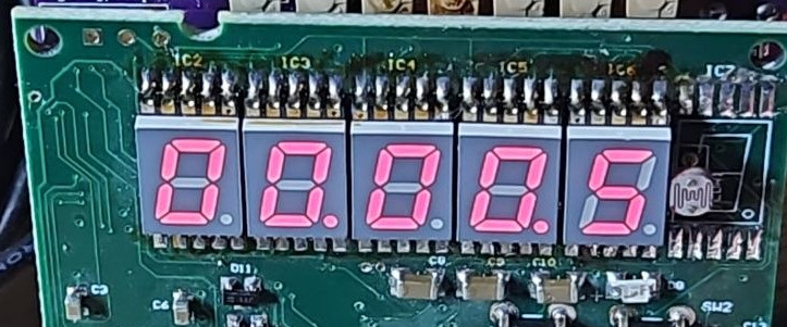

The DS reveals a weird relationship for the brightness setting bits:
0000: pulse width is 1/16
0001: pulse width is 2/16
0010: pulse width is 4/16
0011: pulse width is 10/16
0100: pulse width is 11/16
0101: pulse width is 12/16
0110: pulse width is 13/16
0111: pulse width is 14/16
So the chip's 3-bit brightness values 0-7 do not map linearly to increasing brightness (LED current) — there's a non-linear jump between values 2 and 3 (4/16 to 10/16), skipping 5/16, 6/16, 7/16, 8/16, 9/16 entirely.
I've spent a bit of time on this and it appears impossible to solve that gap with just one resistor being switched (i.e. two Rset values only).
So another reason to not use the software brightness, set it to 111, and drive the Rset pin from a wide range current sink. Or one of those programmable potentiometers but they aren't cheap.

The counter argument to the above is that Rset values above 1.5k do nothing, which suggests some weird circuit... can anyone imagine what it would be?
LED display drivers often have this somewhat arbitrary range limit on RSET.
My take on that, is that range given is just to meet the error band specs. You can use much lower currents just fine.
ie The circuit is a simple current mirror with some gain.

Well, you can make your own
You can but you need to implement 6 x 8 controllable and gated current sinks. Otherwise, yeah, it is just a shift register :)
Indeed; the AS1115 shows that explicitly, while the STLED316 does not say that (but a "mirror" is mentioned in an appnote). The AS1115 would have been a much better chip for this project, but maybe it was not known in 2016 when it was started. OTOH the STLED316 is just fine if you don't need ambient light based (continuous) brightness control.

« Reply #10 on: May 22, 2026, 02:16:38 pm »
As an extra data point, the voltage on Rset is +1.2V which indicates that the current mirror (which hangs off the +5V supply rail) drops quite a bit of voltage.
Hence this chip cannot do 3.3V. The min is 4.5V (DS), unsurprisingly.
And here is another bizarre thing: One of the prototypes I built has green LEDs, not red. And I cannot get the brightness on this one to work monotonically. It just does weird things as I vary the Rset resistor value. So what is different?
The actual Vs is about 4.6V and green LEDs drop a lot more voltage, and I think the current mirror structure is running out of steam.
Hence I wonder how the AS1115 can be specced at min 2.7V when a green LED can drop this alone.
