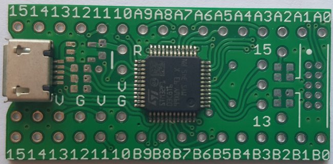

Hello everyone.
I am currently designing an STM32G474VC development board for my projects. The microcontroller has 100 pins and 86 GPIOs.
I've previously used Arduinos and Raspberry Pi Picos in my projects and I am used to the GPIOs on the development board being sequentially numbered.
For example, the Raspberry Pi Pico has GPIOs 0~15 on the left hand side, in order. The GPIOs are also in order on the RP chips.
The Arduinos have D0~D13 on the right hand side, in order. (I know that it is "reordered" in software.)
The GPIO ports are not in order on the STM32 chips. So, I tried to reorder them on the PCB so that the GPIOs on the pin headers are in order. I quickly found that it is quite a challenge for a 100 pin microcontroller.
Therefore, I have a question.
Do you guys care about the order of the GPIOs on a microcontroller development board? Is having them in order a nice feature of the development board, or it doesn't matter to you?

Every time I have cursed ST for their QWERTY-like approach to laying out their ports, I have always assumed it was so some peripheral or other actually is laid out logically. I have yet to find this mythical peripheral, but I'm sure there must be some reason...
They're almost as bad as XMOS.
But to your point, if you're going to lay out ports in a logical manner (which is A Good ThingTM), make sure you don't make any fast-peripheral paths have wildly different trace lengths. There's a lot of pearl-clutching about just how many picoseconds a trace can be "out" and still work - in my experience they work far outside the supposed boundaries - but I still endeavour to keep things within the specified tolerances.
It depends on what the firmware needs to do. If the firmware needs to output 8-bit or 16-bit parallel data via GPIO, it's highly desirable keep the GPIO ports according to the logical order. It makes connection to the system bus or logic analyzer easier, with a single ribbon cable. Otherwise, the board either becomes difficult to connect, or the firmware becomes x times slower (where x is the number of GPIO groups a bus needs to cross).
If it only outputs serial data or a few control signals, I don't care.
Also, when using high-speed peripherals, that hardware pinout can be in conflict with the GPIO, so there's a tradeoff.

Great to from you guys.
I think I will still try to make the GPIOs in order, it will be a challenge for me.  ;)
The signals probably will "jump" off the development board with wires. Maybe a few millimetre of difference on the PCB will only be a small portion of the total delay mismatch?
At least the fast peripheral pins that I am interested in (HRTIM) are logically arranged on the STM32, so I can make the trace length very similar.
Is this kind of application common? I've thought about this when I was designing the pinout of the development board, but I couldn't recall when I ever used this technique.

I like to have a full "port" (at least 8 or 16 bits) of contiguous bits, somewhere on a development board.
Board vendors and even chip manufacturers aren't particularly cooperative (I once posted a flame about some of the low-pin-count Atmel SAMD chips - no more than 2 contiguous bits in the 12 GPIO pins...)  But I don't need ALL of the pins to be in order.
I blame Arduino.
OTOH, I also tend to believe that Arduino's API emphasizing single pins rather than ports was one of the most important steps toward acceptance by their target audience (to whom "bit manipulaion" might as well have been tensor calculus.)

For a developement board it really helps to have the ports sorted. For a board for a specific purpose one can often get away with a little more software effort and a simpler PCB, but it depends.

All is not lost if you can at least make some groups of the pins contiguous. The STM32G474VC is a Cortex-M4 MCU so you have access to the single-cycle bit-manipulation instructions RBIT, BFI, BFX etc. which allow you to remap the GPIO pins in software very efficiently.

You will have all gpio pins available in either case. I would go with easy routing which still leaves you with something like 6 ports with 8 consecutive physical pins (and probably rarely used as 8bits). Dealing with the physical pin order when using the dev board may make you choose pins during development that are also easier to route when it comes time to layout the mcu on its own specific board. Pins can be changed later in the software, but its nicer if your dev board matches up.
As a simple example, lets say you chose to use 8 led's as hex code error output, and since your logical layout had pb0-7 in order you use them (no real need to use consecutive pins for this, but at first glance it looks like it will be easier so you do it). Now you put the mcu on its own board and now realize during layout some of those pb pins are on the other side of the mcu and makes routing harder than it needs to be. That can be dealt with by using different pins, but it also now means your dev board setup you most likely initially used does not match the new board and you now need more software to make the same code work on both boards. Now you start to juggle pins and now also need to avoid alternate function pins in use, and pretty soon you wish you would have chosen pins better in the first place.
Since most of the time pins will be used as individual pins, or as alternate function pins which will probably be scattered around anyway, about the only useful thing the logical order gets you is a little easier time finding a pin on the dev board.

I think the benefits of having sequentially ordered GPIOs is not about efficiency of operation but the efficiency of developing.
For me, being able to find the pins/ports instantly on the development board is important. Especially if it's going to be reused in multiple projects.
I think this is a great idea. Breaking the 16-bit port into two 8-bit ports strikes a balance the PCB layout complexity and the easiness to find GPIO pins. The only downside is that it doesn't look as satisfying.  |O

I prefer to have ordered GPIO on development boards. For example on my blue pill port A is on one side, port B on another and 3 C pins (13 - 15) between.

You HAD to use that nasty micro-usb! :D (I have so much hate to them)
