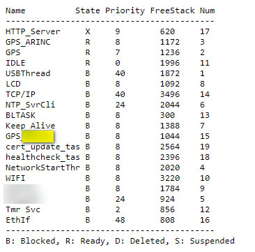

FreeRTOS is brilliant. No trouble with it at all. I now have a load of tasks hanging off mine. Some of them are pretty big.
The key to making it all run nicely is, whenever there is nothing to do, do osDelay(10) or whatever...

So by switching to RTOS you offload this management onto OS and get clean tasks.
And then by switching to even more advanced OS like GNU/Linux you gain access to a huge existing software stack.
My projects were all bare metal up to this time so unfortunately I can't give you a real world example of switching to OS, but the guiding principles are there.
