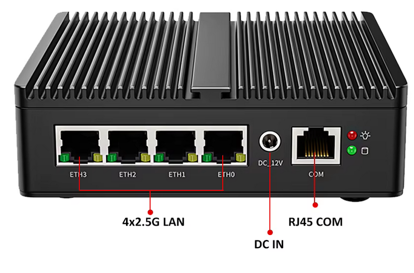

I must admit I have struggled - the APU2 (and minor variants the 3, 4 and 6) were among the best small, low power but decent performance SBCs and with three Mini-PCIe ports very flexible for building small routers and WiFi APs or 3/4/5G routers with the added bonus of a completely open source software stack and availability of schematics.
I bought one of these mini PC's with 4x 2.5GbE which are OK - but they run hot (some mitigation is possible tweaking power limits in the BIOS)
Apart from the power consumption there is, of course, no schematics, it's very questionable if any BIOS update would ever appear and only one MiniPCIe slot
Other possibilities often suggested are the Broachlink Noah boards - haven't acquired one to tinker with yet but the cases aren't as nice (close, I admit but the PC Engines cases definitely win the good looks competition) and the BIOS and schematics remain proprietary.

In the UK LinItx still has stock of the APU4D4 at £210 inc VAT (so about $230-235 without sales tax). In the US mini-box.com still seems to have stock of the APU2E4 and APU4D4 at $229 (exclusive of sales tax, presumably)
Over on Aliexpress a bare bones (no RAM, no storage) N5105 based mini-PC with 4x 2.5GbE is £96.52/$125 shipped, taxes/tariffs on top (so 20% VAT into the UK, who knows what into the US).
Rack-matrix.com has the Noah 4 (1.9GHz Intel E3845, 4x GbE, 1x mSATA and 2x MiniPCIe) for $162.23 exclusive, the Noah 5 for the same money ($171.84 for the version with TPM) or the Noah 6 at $212.39
Another board which is suggested as a replacement is the Banana Pi BPI-R4 - this seems to be available starting around $135 from amazon.com
As I said none are exactly equivalent to the APU2 (or related GX-412TC based boards). the best replacement for an APU2 or 4 is still a new APU2 or 4 while stock lasts in the retail channel (I managed to score some unused APU3's for a good price on eBay recently) but there are definitely boards/systems which will replace the core functionality for about the same price if you look for them - just that nothing quite replaces everything the APU boards offer in a single package.

Agree with your comments. Which is why I've gone for "stock up" (well, 2 spare boards and cases) as my main response to the boards going EoL.
There are too many scams and rip-offs from China.  Quality and support are horrendous.
True, and I can't imagine it's easy or cheap to order from AliExpress in the US at the moment.
That said I have had good luck (and I suppose it is luck to an extent) and not been scammed when buying stuff - though support is non existent, as you say.
There are a plethora of devices and it is not always clear who the original manufacturer is, the one I have is labelled GF-1388NP-12 on the PCB, but identified as a "Techvision TVI7309X" in the SMBIOS data. Techvision might be badge engineering a board by Bluetech, or maybe not, who knows.
But, it works, it has a reasonable specification and although I mostly just use it for short term projects where it doesn't matter if it stops working.
Intel still has objectionable market segmentation policies.  Any system with an Intel processor which supports what my current APU2 supports is more than 5 times the price, at least based on what Netgate and others offer.
If ECC is on your must-have list yes, it's going to be expensive as you are probably looking at "industrial" SBCs (which always have ridiculous prices from a hobby perspective), a lot of the "router" boards are pricey as well, as you observe.
In the end we were a bit spoilt by the APU series being so flexible and such good value for money. They were showing their age performance wise but the BIOS update which enabled the 1.4GHz turbo manage to redress that a bit.
There was (apparently) an APU7 prototype with I225 NICs - that would have been interesting, especially if coupled with a slightly beefier processor such as the GX 420MC though a single lane of PCIe2 x1 might have struggled to keep up at 2.5Gb/s. I think that processor might even still be available.
I do not really object to a non-x86 processor, but nothing available has sufficient memory and peripheral support, and ECC.  The non-x86 environment is very fragmented.
Nod, especially if you want ECC though how critical that is I'm not that clear.
A low power desktop can completely replace an APU2.  The only question is how low can the power be pushed.
A more powerful but still low power desktop would also allow virtualization, perhaps making up for its higher power draw by encompassing other systems.
That's definitely a "how long is a piece of string" question - too many variables - CPU speed, number of cores, load, platform.
Using "powerstat" on my cheap Chinese toy (N5105 4 cores, 4 threads) gives an idle power draw of ~3W, just under 30W at 2.8GHz and 16W at 2.1Ghz where I have the long term power average set in the BIOS - that did need a bit of tweaking from the stock settings.
OTOH my desktop despite being a "low power" CPU (i7-12700T) idles at ~12W but readily shoots well over 100W with a bit of a load.
