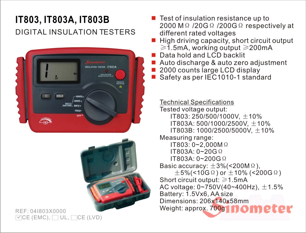

I am also looking at getting an insulation tester.  Does anyone have any experience with these units?  Is there anything to specifically avoid buying?
VC60B+
http://www.amazon.com/Victor-Digital-Insulation-Resistance-0-1~2000M/dp/B008F29N44/ref=sr_1_1?s=hi&ie=UTF8&qid=1350409475&sr=1-1&keywords=VC60B%2B
Sinometer 803
http://www.sinometer.com/uploadImage/2012-09-27/2012092714384439413570.JPG
UT511
http://www.uni-trend.com/UT511.html
