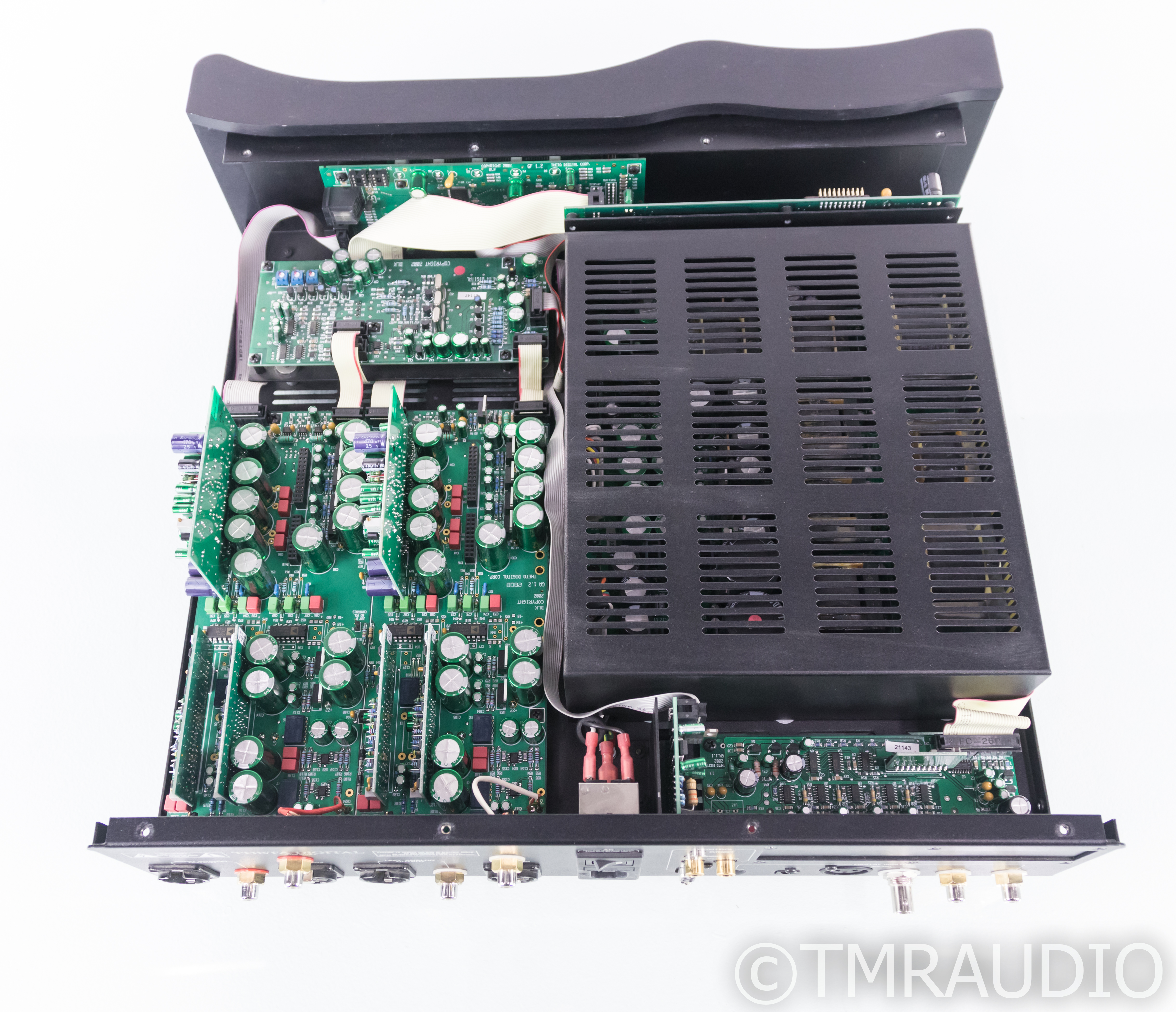

The mechanical design is so bad that carrying by hand on a soft eider-down pillow
is the only safe way of transportation. The stilts for the PCB's are very narrow and
very high with the mass on top so a mild whack with a hand on the side of the amp will
break them. A few millimeters wide and much longer (like 60 mm in total) will amplify
any sideway loads until the plastic cracks. Width 6 mm, screw 2 mm in the center leaves
a L-shaped fulcrum with a 60/2 force increase on soft plastic. Either the threads in the
plastic will strip or the stilt cracks. The swedish word "klämlängd" (that I don't know
the engelska translation of) is what every designer MUST know. Long levers makes small
forces BIG.
... but it worked on the lab bench!
Now you ruined it transporting this gold-plated design!
