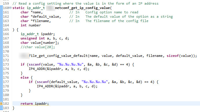

This function produces no warning with -Og or -Os but with most others e.g. -O1 you get
'ipaddr.addr' may be used uninitialized in this function [-Wmaybe-uninitialized] line 182
How does that work?
« Last Edit: November 22, 2024, 04:28:05 pm by peter-h »

Such "maybe" warnings are based on the pattern in the intermediate representation (GIMPLE or GENERIC for GCC) after optimizations are applied, and are heuristic instead of deterministic.
In your case, ipaddr indeed is used uninitialized if the value does not conform to numeric IPv4 dotted notation.  Initializing it to all zeros would make a lot of sense in my opinion.
Offline SiliconWizard
  • Posts: 15736
Re: GCC v11 32F4: compiler warning depends on optimisation level
« Reply #2 on: November 22, 2024, 10:15:57 pm »
As Nominal said, it does depend on the internal representation the compilers makes, but I would see it as a limitation of its static analyzer, which is still not very good for GCC. The CLang one is better.
You simply have execution paths for which ipaddr is not set (if both sscanf fail), and the function returns this variable it in all cases. So the warning is definitely relevant.
The fact it only appears in some optimization levels isn't great IMHO, but would again be explained with how GCC handles it internally.
You should initialize ipaddr to some default value. Not sure what the type is, but simply:
ip_addr_t ipaddr = {};
should do (I think formally it's only correct in recent standard revisions - maybe strictly C2x? - but GCC has been accepting that for a long time for initializing almost anything to '0').
I would suggest avoiding sscanf() too here, ideally. Not only is it relatively expensive (both in terms of code size and execution time), but it's also pretty unsafe.

I can see that if both sscanf calls fail, the IP is undefined in this function. I just could not see how the optimisation level should affect this warning.
I googled on Dead Store Elimination and while I can see why -Og disables it (it enables better single stepping) I can't see why -Os should disable it.
I also can't see how
   unsigned int a, b, c, d;
   if (sscanf(value, "%u.%u.%u.%u", &a, &b, &c, &d) == 4) ...
could make the sscanf fail. Surely any int (without a - sign) will be valid for %u. But yes it might fail if not seeing that x.x.x.x pattern, but file_get_config_value_default() does always return a valid string, in the form "169.254.75.75" (static const definitions).
So maybe the compiler is trying too hard and getting it wrong.

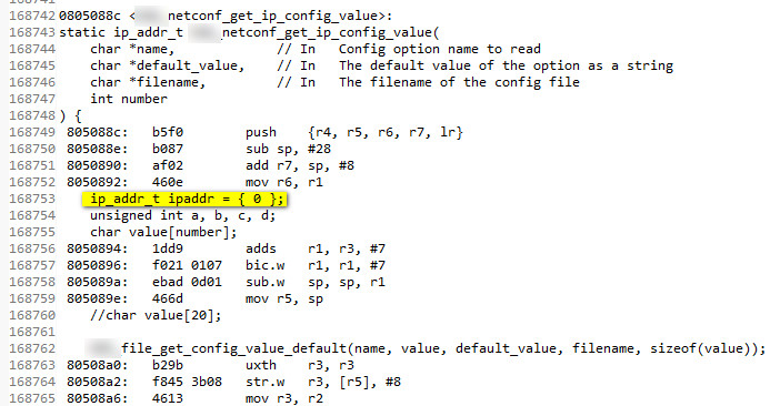

Probably I should have
ip_addr_t ipaddr = {0};
and sure enough that removes the warning with -O1.

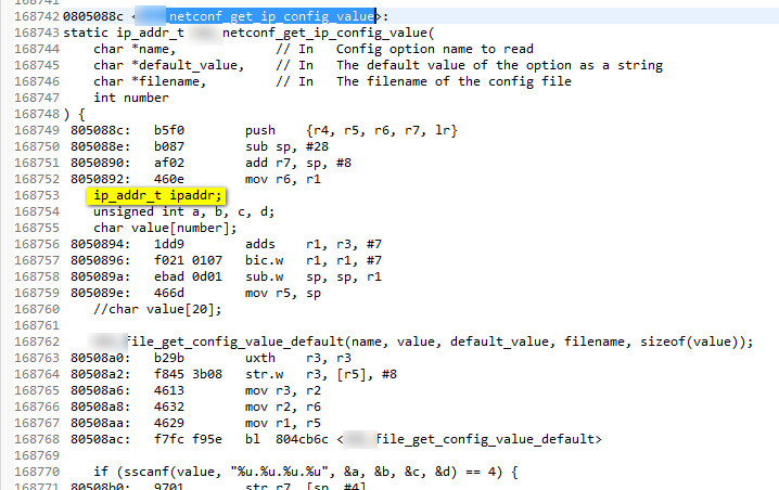

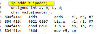

At -Og, I see no zeroing code
But I probably don't understand the subtleties of arm32 asm since the code with = { 0 } produces the same asm. The bic.w instruction might be doing the job but the #7 operand makes no sense
and this is with -O1 but not zeroing the IP; same code produced!
« Last Edit: November 25, 2024, 02:40:53 pm by peter-h »

Looks to me like ipaddr is getting zeroed in all 3 cases.
« Last Edit: November 26, 2024, 10:15:02 am by peter-h »

3) GCC claims (variously?) that -Og may zero stack variables but -O1 does not, yet the generated code does not confirm this
Can anyone confirm that ipaddr is actually being zeroed? I cannot find an asm language reference explaining some of the code.

What does this asm do?
It is the same if I use ipaddr={0} - the above screenshots show that.
It rounds r1 up to a 64-bit word, moves the stack pointer down for local variable space, pointed to by r5.
This code does not clear any variable.
Right, so why did my ipaddr = {0} produce the same asm?
It is not as if ipaddr was a static and thus in BSS and thus zeroed at startup. This stuff is on the stack so could be anything.
Online Tation
  • Posts: 106
  • Country: pt
« Reply #22 on: November 27, 2024, 04:30:26 pm »
Sure it is on the stack? Fitting in 32 bit it may well be in a register.

Online peter-hTopic starter
  • Posts: 4320
« Reply #24 on: November 27, 2024, 05:01:01 pm »
OK here is the asm for a non-zeroed ipaddr
0805088c <netconf_get_ip_config_value>:
static ip_addr_t netconf_get_ip_config_value(
char *name, // In Config option name to read
char *default_value, // In The default value of the option as a string
char *filename, // In The filename of the config file
int number
 805088c: b5f0      push {r4, r5, r6, r7, lr}
 805088e: b087      sub sp, #28
 8050890: af02      add r7, sp, #8
 8050892: 460e      mov r6, r1
ip_addr_t ipaddr;
char value[number];
 8050894: 1dd9      adds r1, r3, #7
 8050896: f021 0107 bic.w r1, r1, #7
 805089a: ebad 0d01 sub.w sp, sp, r1
 805089e: 466d      mov r5, sp
//char value[20];
file_get_config_value_default(name, value, default_value, filename, sizeof(value));
 80508a0: b29b      uxth r3, r3
 80508a2: f845 3b08 str.w r3, [r5], #8
 80508a6: 4613      mov r3, r2
 80508a8: 4632      mov r2, r6
 80508aa: 4629      mov r1, r5
 80508ac: f7fc f95e bl 804cb6c <file_get_config_value_default>
if (sscanf(value, "%u.%u.%u.%u", &a, &b, &c, &d) == 4) {
 80508b0: 9701      str r7, [sp, #4]
 80508b2: 1d3b      adds r3, r7, #4
 80508b4: 9300      str r3, [sp, #0]
 80508b6: f107 0308 add.w r3, r7, #8
 80508ba: f107 020c add.w r2, r7, #12
 80508be: 4924      ldr r1, [pc, #144] ; (8050950 <netconf_get_ip_config_value+0xc4>)
 80508c0: 4628      mov r0, r5
 80508c2: f008 f943 bl 8058b4c <sscanf>
 80508c6: 2804      cmp r0, #4
 80508c8: d11b      bne.n 8050902 <netconf_get_ip_config_value+0x76>
IP4_ADDR(&ipaddr, a, b, c, d);
 80508ca: 68bb      ldr r3, [r7, #8]
 80508cc: 041b      lsls r3, r3, #16
 80508ce: f403 037f and.w r3, r3, #16711680 ; 0xff0000
 80508d2: 68fa      ldr r2, [r7, #12]
 80508d4: ea43 6302 orr.w r3, r3, r2, lsl #24
 80508d8: 687a      ldr r2, [r7, #4]
 80508da: 0212      lsls r2, r2, #8
 80508dc: b292      uxth r2, r2
 80508de: 4313      orrs r3, r2
 80508e0: 783a      ldrb r2, [r7, #0]
 80508e2: 4313      orrs r3, r2
 80508e4: 021c      lsls r4, r3, #8
 80508e6: f404 047f and.w r4, r4, #16711680 ; 0xff0000
 80508ea: ea44 6402 orr.w r4, r4, r2, lsl #24
 80508ee: 0a1a      lsrs r2, r3, #8
 80508f0: f402 427f and.w r2, r2, #65280 ; 0xff00
 80508f4: 4314      orrs r4, r2
 80508f6: ea44 6413 orr.w r4, r4, r3, lsr #24
return ipaddr;
and here is the asm for the zeroed ipaddr:
int number
char value[number];
//char value[20];
return ipaddr;
A comparison shows no change.
Above is with -Og. With -O1 I do see a difference. Here are the two cases, same order as above
0804f40c <netconf_get_ip_config_value>:
int number
 804f40c: b5f0      push {r4, r5, r6, r7, lr}
 804f40e: b087      sub sp, #28
 804f410: af02      add r7, sp, #8
 804f412: 460e      mov r6, r1
ip_addr_t ipaddr;
char value[number];
 804f414: 1dd9      adds r1, r3, #7
 804f416: f021 0107 bic.w r1, r1, #7
 804f41a: ebad 0d01 sub.w sp, sp, r1
 804f41e: 466d      mov r5, sp
//char value[20];
 804f420: b29b      uxth r3, r3
 804f422: f845 3b08 str.w r3, [r5], #8
 804f426: 4613      mov r3, r2
 804f428: 4632      mov r2, r6
 804f42a: 4629      mov r1, r5
 804f42c: f7fc fa04 bl 804b838 <file_get_config_value_default>
 804f430: 9701      str r7, [sp, #4]
 804f432: 1d3b      adds r3, r7, #4
 804f434: 9300      str r3, [sp, #0]
 804f436: f107 0308 add.w r3, r7, #8
 804f43a: f107 020c add.w r2, r7, #12
 804f43e: 491a      ldr r1, [pc, #104] ; (804f4a8 <netconf_get_ip_config_value+0x9c>)
 804f440: 4628      mov r0, r5
 804f442: f008 f819 bl 8057478 <sscanf>
 804f446: 2804      cmp r0, #4
 804f448: d111      bne.n 804f46e <netconf_get_ip_config_value+0x62>
 804f44a: 7839      ldrb r1, [r7, #0]
 804f44c: 68bb      ldr r3, [r7, #8]
 804f44e: 021b      lsls r3, r3, #8
 804f450: 687a      ldr r2, [r7, #4]
 804f452: 0212      lsls r2, r2, #8
 804f454: b292      uxth r2, r2
 804f456: 7b3c      ldrb r4, [r7, #12]
 804f458: ea44 6401 orr.w r4, r4, r1, lsl #24
 804f45c: ea44 2402 orr.w r4, r4, r2, lsl #8
 804f460: f403 437f and.w r3, r3, #65280 ; 0xff00
 804f464: 431c      orrs r4, r3
return ipaddr;
int number
 804f40c: b5b0      push {r4, r5, r7, lr}
 804f40e: b086      sub sp, #24
 804f412: 460d      mov r5, r1
char value[number];
 804f41e: 466c      mov r4, sp
//char value[20];
 804f422: f844 3b08 str.w r3, [r4], #8
 804f428: 462a      mov r2, r5
 804f42a: 4621      mov r1, r4
 804f440: 4620      mov r0, r4
 804f448: d110      bne.n 804f46c <netconf_get_ip_config_value+0x60>
 804f456: 7b38      ldrb r0, [r7, #12]
 804f458: ea40 6001 orr.w r0, r0, r1, lsl #24
 804f45c: ea40 2002 orr.w r0, r0, r2, lsl #8
 804f464: 4318      orrs r0, r3
return ipaddr;
The code looks similar but registers are used differently. The difference starts with
sub   sp, #28
sub   sp, #24
and as posted before, the non-zeroing version with -O1 produces that warning.
