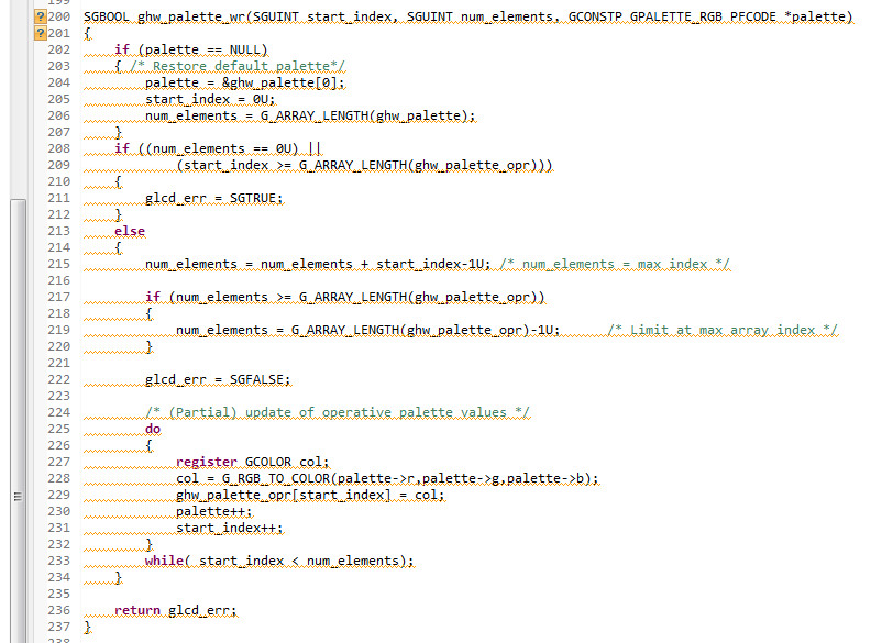

Here is another mystery syntax error
SGBOOL is uint8_t
SGUINT is uint16_t
GCONSTP is const
GPALETTE_RGB is
typedef struct _GPALETTE_RGB
   SGUCHAR r;
   SGUCHAR g;
   SGUCHAR b;
   } GPALETTE_RGB;
PFCODE is
  /* Memory type qualifier used for pointer to fixed data (if GCODE var * is not enough) */
  #define PFCODE   /* nothing */

« Reply #27 on: June 11, 2025, 06:39:06 am »
try to use typedef instead of preprocessor #defines

« Reply #28 on: June 11, 2025, 07:09:44 am »
The #defines for e.g. uint8_t are everywhere in this bit of code (not mine). The problem is elsewhere and may be in the typedef'd struct.

Re: Please help with this C syntax error
« Reply #29 on: June 11, 2025, 11:00:21 am »
In Uni when it came to C and C++ we were forbidden to do many things.
One of them was to use contractions.  The reason being,
for( ; AMACRO++; AMACRO<limit )
Becomes a completely random bit of code once the preprocessing has finished with it.  It might, if you are lucky produce a compile error.  If you are unlucky it will do something that appears valid, most of the time.
Using
for( ; AMACRO=AMACRO+1; AMACRO<limit )
Will catch more cases of inappropriate use of AMACRO than the former will.  You are first ensuring the AMACRO can "store" a result in the first place.  If it's a function call wrapper, then ++ will either post increment a register that will immediately be discarded or it will bomb out with a wicked compiler error.
MACRO_DEFINED_FUNCTION( parameters ) -1U
Is this asking for trouble? and relying exclusively on how that MACRO is implemented and if it was ever intended to be used that way.
In C++ it gets worse when operators can be macro'd!
The way to debug these things is unfortunately to add the "keep preprocessing output" flag and go and look at what ACTUALLY got compiled.
I don't know if it solves your problem, but just a "word from the wise", (my uni, not me).

« Reply #31 on: June 11, 2025, 01:46:31 pm »
This may be a missing bracket above within the same source file. I mean the function doesn't have a certain syntax error but a function wasn't expected..
