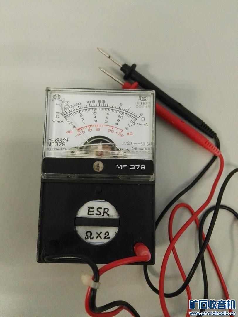

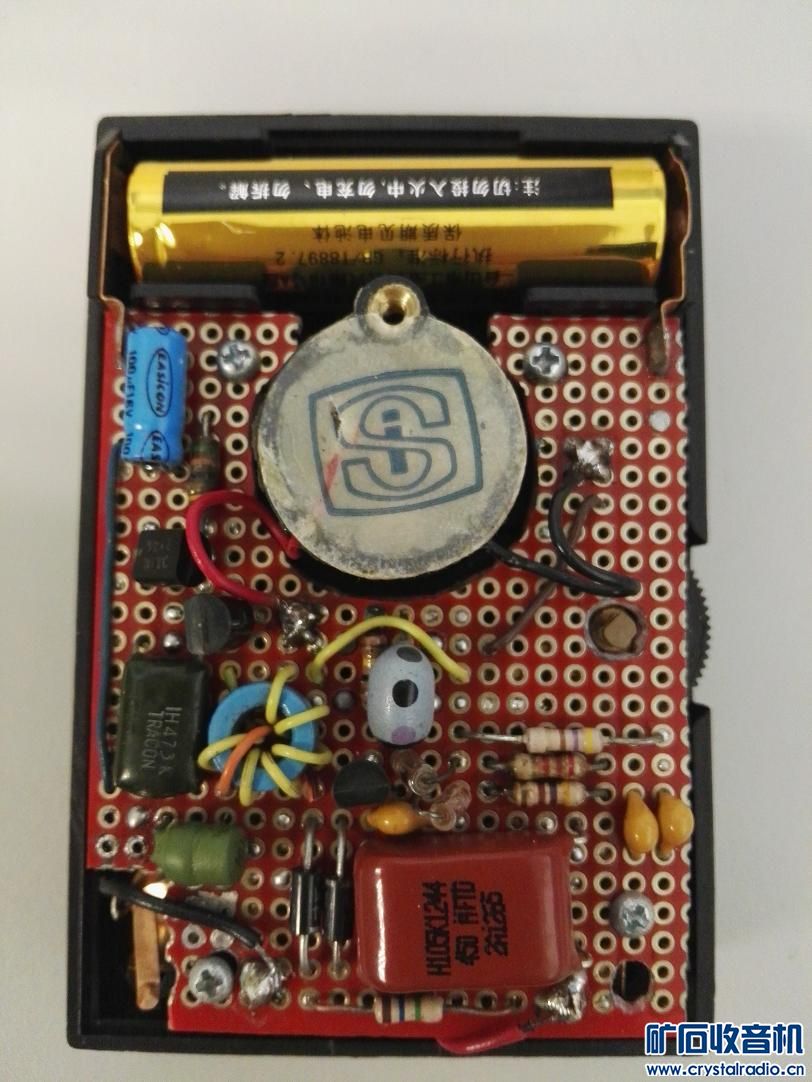

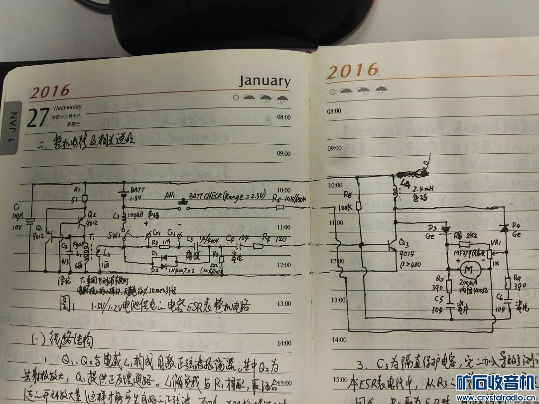

another ESR meter design from China.it (and mine) can use the anologe  multimeter scale,and only use one IC.
TDA1308 can work at 3V~5V ,so you can use Li-rechargeble battery for it. if you have not TDA1308,you can use NE5532 at 7V~9V
R7=the centre value of scale,R5=R6=2*R7
http://www.crystalradio.cn/forum.php?mod=viewthread&tid=511567&extra=&page=1
