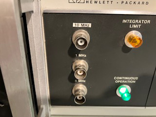

Nice-looking solution!  However, consider whether you really want a cleaner 5 MHz signal, as opposed to direct access to the internal 10 MHz signal from the 10811.  I've always found it more useful to repurpose an unused jack for 10 MHz output
If I were going to spin a boad like this, I'd take the opportunity to add a well-isolated 10 MHz output jack that could be routed to the front panel if desired.  Something to think about for the next revision, maybe.

I have implemented a 10 MHz "sniffer" SMB-connector on a redesigned 10811- adapter board that connects the XO and the divider board to the chassis.
Will use the 1PPS output connector on the right side of the 5065 after having built a suitable sniffer-amplifier/buffer module.

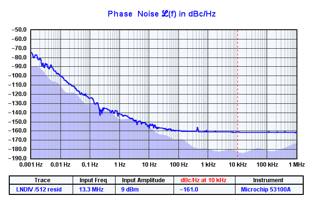

Although it's a little debatable whether he should have relied on a 90-degree hybrid ahead of the dividers to establish quadrature at the PN analyzer inputs, as opposed to adding 90 degrees' worth of coax in one of the measurement arms.  90 degrees at 24 MHz corresponds to about 10 ns of time difference at the divider inputs.  This time difference will be preserved at the divider outputs since their output edges are generated only in response to input edges, but now it's only 22.5 degrees since the frequency has been divided by 4.
This will cause the measured PN to be 20*cos(22.5) dB low, not a huge deal since it's only about 1 dB.  But it will also have the effect of impairing the analyzer's AM noise rejection, so he may have been measuring the DUT's PSRR to some extent.  It would be nice to reproduce the measurements with a modern digital PN test set, and include newer logic families as well.
I had a customer a couple of years ago who had some unusual measurement requirements at 6 GHz, so I built a 'limited edition' low-noise divider module for them.  Was really impressed at how well the HMC983LP5E and HMC394LP4 did in this application:
So natürlich the HMC983LP5E is now EOL.  Never change, Hittite.  Never change.  |O
