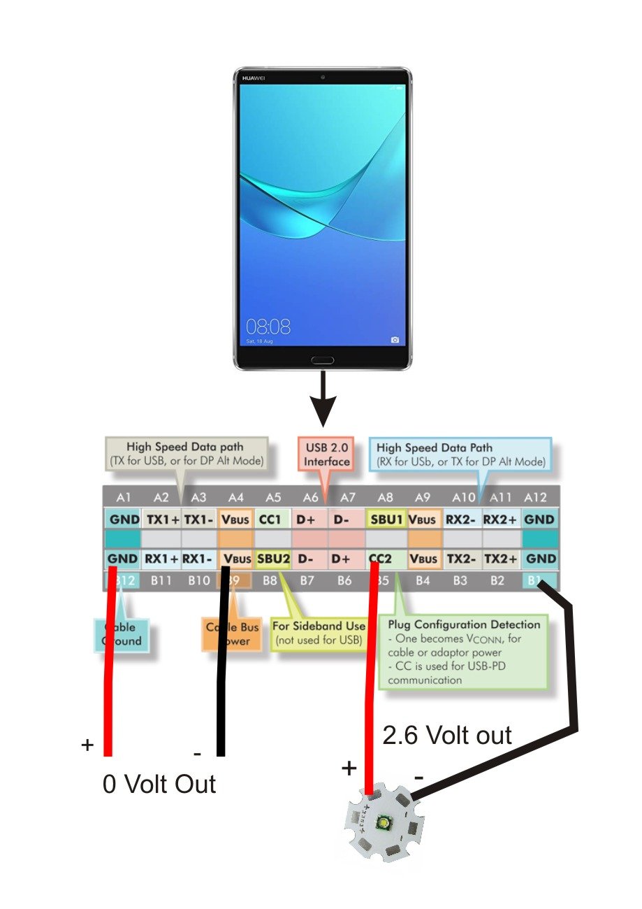

Taking the current from the USB Type C output of the tablet.
I have already tested the speakers, I have connected two headphone speakers and with a switch I can turn them on and off as desired, so the phone does not always detect headphones (it would no longer play audio from external speakers). Everything ok, it works well.
Then I tried to connect the LED, years ago I had done it from an iPhone and it worked very well, I had taken the current from the same poles where the current entered to charge the cellphone.
But here with this damn new type-C USB port I have a problem, the GND and Vbus power pins that are used to let the current in and charge the smartphone, do not give any output voltage.  |O
I can detect 2.66 volts only from the GND ping and the CC2.
Do you think there is no way to take power from the tablet to power a small external LED?
In your opinion, if I connect a LED, (which absorbs about 250Mah)
 connecting it to GND and CC2 as per attached drawing, do I mess up?
do I damage the new tablet I just bought?  :scared:
Is there any way to take the current out of this tablet?
Yes.
Probably not (but I'd still be wary), as the CC1/CC2 pins from a host can only provide little current, but they are used to configure the role of the plugged device (with pull-down  resistors), not provide any significant amount of power. I wouldn't do that under any circumstances. Use VBUS and configure CC1/CC2 properly so the host knows what kind of device it is and can provide power to VBUS.
(Side note: I don't know if your LED module has an integrated series resistor or constant current driver - otherwise you'll need to add one: don't connect a LED directly to VBUS!)
I suggest starting there: https://www.embedded.com/print/4458380
USB-C is significantly more complicated than previous USB connections.

You do not need an LED driver, instead you need an LED current limiter, maybe a power resistor. The LED datasheet will say its maximum allowed current.
Your LED is mounted on a round metal that gets hot. The heat is removed by mounting the metal on a heatsink that has cooling fins in the air.

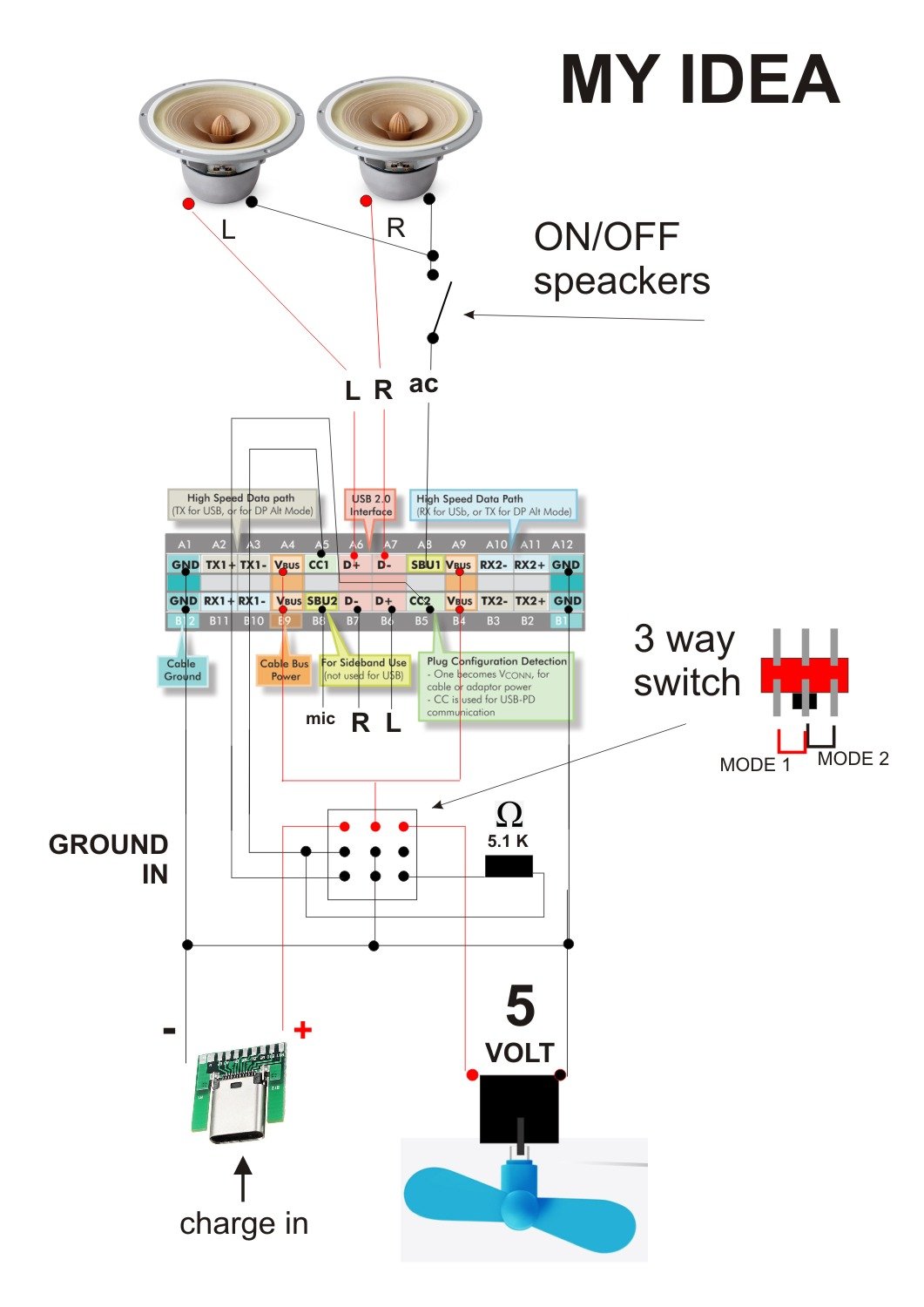

I disassembled and identified the configuration of the type-c usb adapter circuit to audio jack for headphones and input to charge the smartphone.
and the type c usb fan.
I enclose the diagrams of how the two accessories are connected.
Yes, you were right, to give consent to the smartphone to supply the current, there is a 5.1K resistor, exactly one second from the fan connection, 5V are delivered perfectly stable from the smartphone to the fan motor.
I wonder if changing the value of this resistance, it is possible to change the output voltage, but I'm happy with the 5V. :phew:
I made a circuit of how I believe I have solved the situation. >:D
Practically a 3-way switch, creates two modes, in the first, the connections are like the original of the adapter, and you can connect the smartphone in charge from the female adapter.
and through another switch you can activate the headphones when you want.
In the second mode, it excludes part of the adapter connections and I connect the resistor, supplying power to my torch.
How does it look like?  :box:
I squeezed my brains, it's a good puzzle, being able to do everything with as few switches as possible, nothing better came to mind.
Nope, those resistors only control available current at 5V (basically tell the other device that your "phone" is capable of charging at higher currents and that it should supply it if able). If you want higher voltage (9-20V) you must implement the USB Power Delivery standard.
EDIT: Actually nope, the pull-down resistor you have put in only indicates to the host that something is connected and the orientation of the plug. The host provides some pull-up resistors that can tell you how much current is available for you device.
(see here: https://community.cypress.com/docs/DOC-10779 )
If you want more current/voltage than this you need to implement Power Delivery.
Sorry for the confusion.
I have no idea how to proceed
what about my connection scheme? no one thought of a simpler system? :-+
http://www.ti.com/interface/usb/type-c-and-power-delivery/getting-started.html#
The question is why would you want higher voltage from the tablet? It isn't even sure that the tablet can actually provide it or whether it even implements PD. It is the part of the standard intended for device charging from a charger, not one device powering another.
Thank you all for your cooperation
USB C standard is complicated, there is no way around that.
In fact, if you wanted to be properly compliant and wanted to make sure that e.g. you headphones actually work with another device and not only your tablet, you would need a microcontroller that would negotiate the proper alternate mode for the sideband (SBU) pins. Analog audio is not the only thing that can be present there, by far. Also many devices may not even be capable of providing analog audio and you need to provide your own codec/DAC if you want to connect headphones.
The same for drawing power from VBus - you are not supposed to draw more than 100mA before your peripheral is properly enumerated and actually sends a descriptor to the host saying how much current it will need. A lot of devices don't bother with this because they assume they will be connected to a PC/laptop/wall charger where there is plenty of current available. That may not be the case for a battery powered device like a tablet or a phone and you could get a surprise when the power gets shut off suddenly. That the connector/standard is designed for delivering a lot of power doesn't mean that it is actually available.
