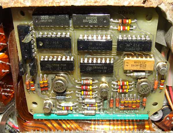

Google turned no datasheets. Someone said I could have anything I wanted from their parts bin, so I chose this, because it looked cool.

It's a DAC (digital to analog converter) made by the PMI company. The part number is DAC-01. It is a 6-bit design, and uses a R-2R ladder circuit.
I found a few books containing datasheets for it:
1986 PMI
1976 PMI
The datasheet even has a photo of the top metal layer (attached).

Another, quite peculiar application of that DAC was as an RPM preset element in an all-electronic engine control unit of a tiny turbojet engine (of its time that is). See here:
If you're interested in some more information on that particular engine (Williams Research WR24-7), have a look here: http://www.turbinenmuseum.de/Gasturbines/WR24-7-2/wr24-7-2.html

Another, quite peculiar application of that DAC was as an RPM preset element in an all-electronic engine control unit of a tiny turbojet engine (of its time that is).  If you're interested in some more information on that particular engine (Williams Research WR24-7), have a look here: http://www.turbinenmuseum.de/Gasturbines/WR24-7-2/wr24-7-2.html
Incredible stuff.  How much thrust did the engine actually produce in the test, I wonder?  I noticed the test stand was mounted on a wheeled cart, so it was somewhat disappointing not to see the cart zoom across the parking lot. :)

We only ran the engine witout the tail pipe / nozzle assembly. In the particular run that we got on video, we also didn't reach full RPM (fuel feed issues), I guess the engine produced in that run round about 100lbs / 450N of thrust. In a later run, we reached 100% RPM but still ran it witout the tail pipe so actual thrust was probably approx. 80% of rated figures (so it must have been something like 180lbs / 800N. In that run, two men had to push the cart quite a little to keep it from moving...
So far, it's a collector's item but eventually it will have to be used in some fun project...  ;)
