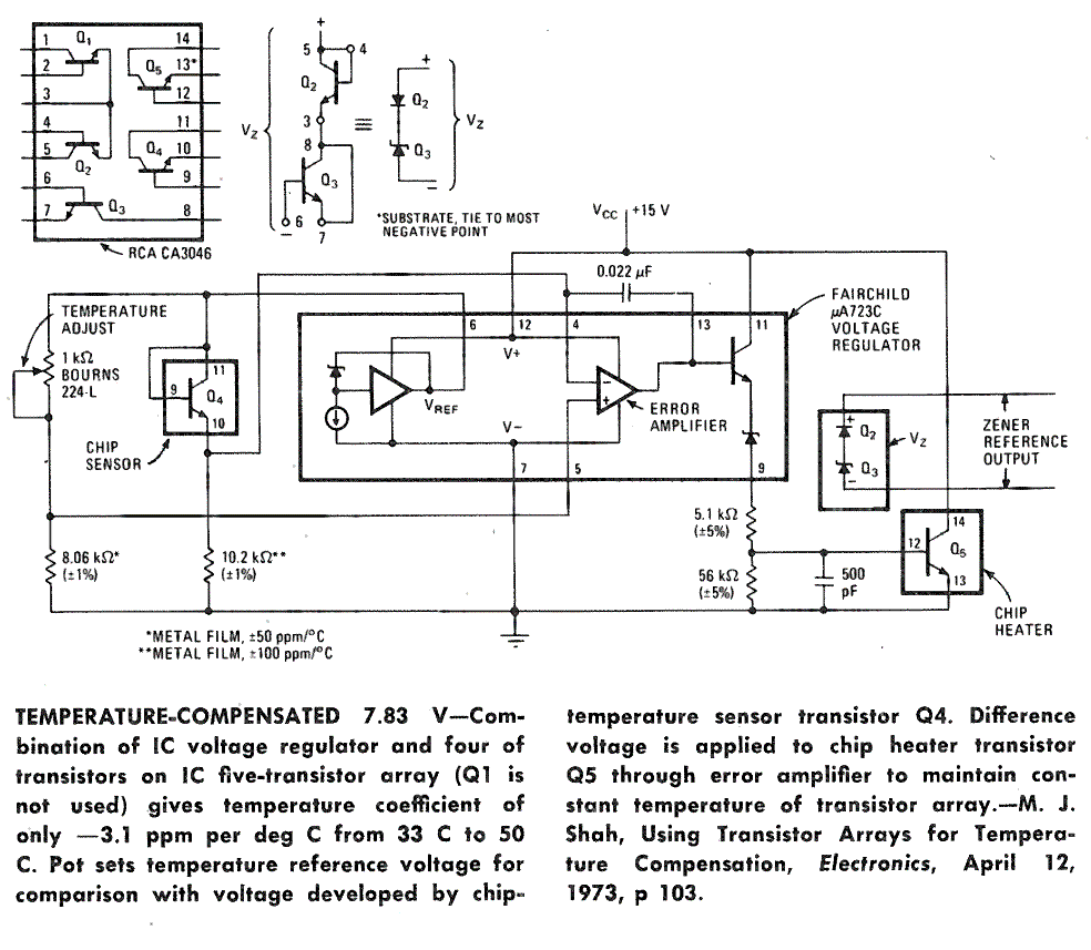

I found a scan someone did of the LM723 temperature controlled reference, it wasn't as smart as suggested ... it actually used a second transistor array for the voltage reference, the LM723 was a preregulator and oven controller.
This seems wasteful to me ... the suggestion of using the internal LM723 transistors as sensor and heater for the internal reference seems better, although the way the transistors are connected makes it a bit non trivial.

I wouldn't use a 723 as a reference. I just looked at the specs, even a 2 cent TL431 is better :P
It was pretty good though when it came out. The competition was a zener diode, potential divider and pass transistor. Still is a good device though if used correctly.
There are however no other cheap references with devices on the die you can use for temperature measurement AFAICS.
True!
But besides tempco, long term stability also sucks!
