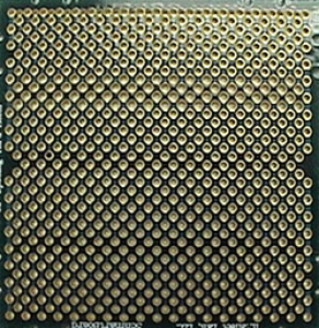

Schmart Boards haven't really caught my attention. Except this one:
Apparently you can fit both standard DIP and shrink DIP packages on it. This may come in handy if I have SDIP ICs to work with.
