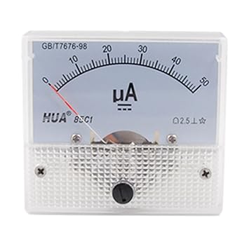

one like this is about $6
from http://www.electroschematics.com/6537/simple-microampere-meter-circuit/
from http://www.electronicecircuits.com/electronic-circuits/micro-ampere-meter
http://www.ebay.com.au/itm/GE-General-Electric-Model-AY278-DC-Microamperes-Analog-Panel-Meter-40-0-40-A-/181770375541
still, calibration is key.  I guess you could use a resistor network, as very cheap accurate resistors don't cost much and working the math, it would be well within 1% accurate.
