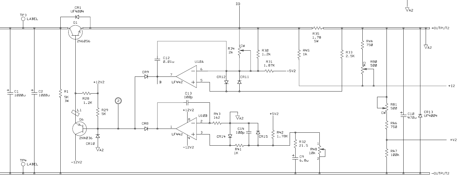

So, I have been fiddling around with various ideas recently and have begun work on what seems like a fun project idea, building my own lab bench psu. I know there are a bunch of topics on this already, and I have been trying to read through alot of them (they have been extremely helpful as far as brainstorming goes) however I'm not totally sure what I should work towards for this. I don't necessarily need it to reach 0V, nor do I need it to go much higher than 12V, and about 1A should be plenty. I would rather design the specific circuits myself, as this project is aimed at learning, but what I'm not sure about is what I need as far as protection goes. What elements would you recommend for my psu? I want low noise, so no tracking preregulator, but like what elements should I use for protection or other necessary or handy features? I've seen designs discussed ranging from little more than an lm317 circu it to circuits whose designs are even more impressive than even commercial PSUs, and am just unsure what I really need for my design. If anyone has any ideas/advice or can point me towards any resources that would be awesome.

"I know there are a bunch of topics on this already, and I have been trying to read through alot of them (they have been extremely helpful as far as brainstorming goes) however I'm not totally sure what I should work towards for this"
Sounds like bullshit because every PSU thread at least mentions if the PSU has adjustable current limiting or no, and you didn't specify if you want current limiting or no. literally you see it on every thread.
So, if you want adjustable current limiting the best topology is something like this:
its from HP E3620 manual, you can pretty much copy the schematic onto a perfboard and it will work but it can be improved.
notice you must have duel secondary transformer for this or use a galvanic isolated DC/DC converter. (costs like 1$ on eBay).

I know about current limiting and I have a copy of the hp handbook thing, I do plan on implementing that in any final design. What I was looking for was more of clarification on what a psu really should include. I've seen some threads discussing these monster designs that have features I don't even understand how to use much less design, and then others are some barebones designs relying on a basic linear regulator ic. I don't plan on using an ic, all my current plans are based around an op-amp solution, but what I'm wondering is, aside from the typical voltage regulation and current limiting, what features are worth putting into a typical bench psu. For example, what safety features should I include, aside from fusing and some form of overvoltage protection?
