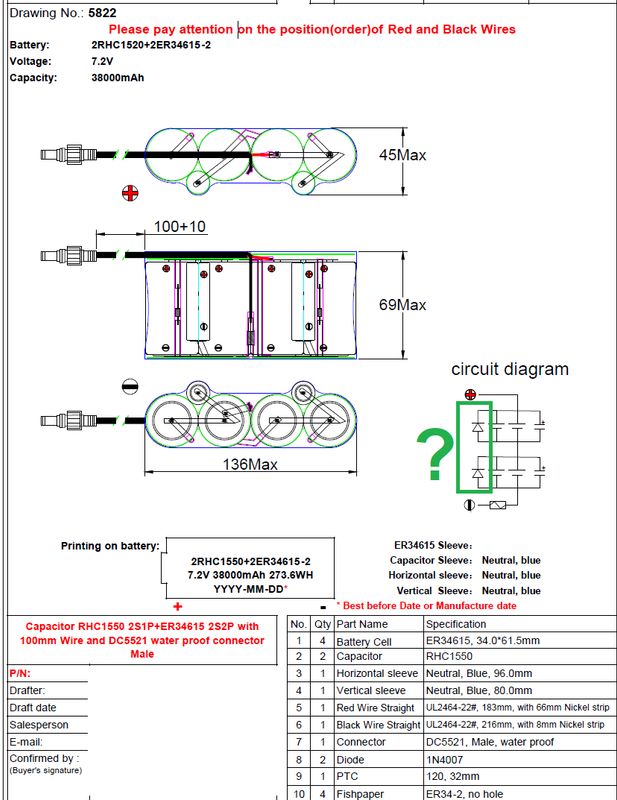

I'm attempting to optimise battery life on a remote IoT sensor and turned my attention to the battery pack which the customer has sourced. Looking at the suppliers drawing I noted the 1N4007 diodes across the cells. The supplier insists they are for "anti reverse charging" (it's a non rechargeable pack).
I can't see what function the diode performs in this configuration? The pack is built to drawing with the diodes fitted as shown and are 1N4007, not a zener or anything.
Is there a gap in my understanding? They look pointless.

1. When cells are connected in series, the one that discharges first will become reverse polarized by the other stronger cells.  That can damage the reverse polarized cell.  By adding the diode, the maximum negative voltage will be limited at -0.5V, which might not completely ruin the reverse polarized cell.
2. The reverse polarized cell might show a high impedance and cut the current, even if the other cells might still have enough voltage and current.  With the diode, the whole pack will remain low impedance, because an open diode is almost like a short-circuit, so it will let the other good cell(s) to deliver power to the load.
3.  Protect the cells against trying to recharge them with wrong polarity charger (if connected to the charger in reverse, by mistake).

There is no charger. These ER34615 cells are lithium metal primary cells.
Connecting them in parallel like this makes me nervous, it assumes they are well matched (voltage and capacity) and if one fails with internal short the explosion will be twice as big as you might expect.
I've seen that on lead acid, and come to think of it on NiMH packs. It's probably the reason they have it here.
These are non-rechargeable, but that also would make sense.
And lithium metals do explode violently if you don't treat them nice.
Yes these are Lithium-thionyl chloride (Li-SOCl2), they have a much higher internal resistance than Li-Ion or Li-Po.
Dead shorting a single cell would give you 120mA if you were lucky, there is a ER34615M which would delivery higher current than ER34615, but still much less than other Lithium types. This is why my attention was drawn to the pack in the first place, it's the old "transmit burst current issue" causing some edge case issues.
The packs are manufactured in China, the customer has been using them for years with zero issue, but yes it's good to be diligent.
