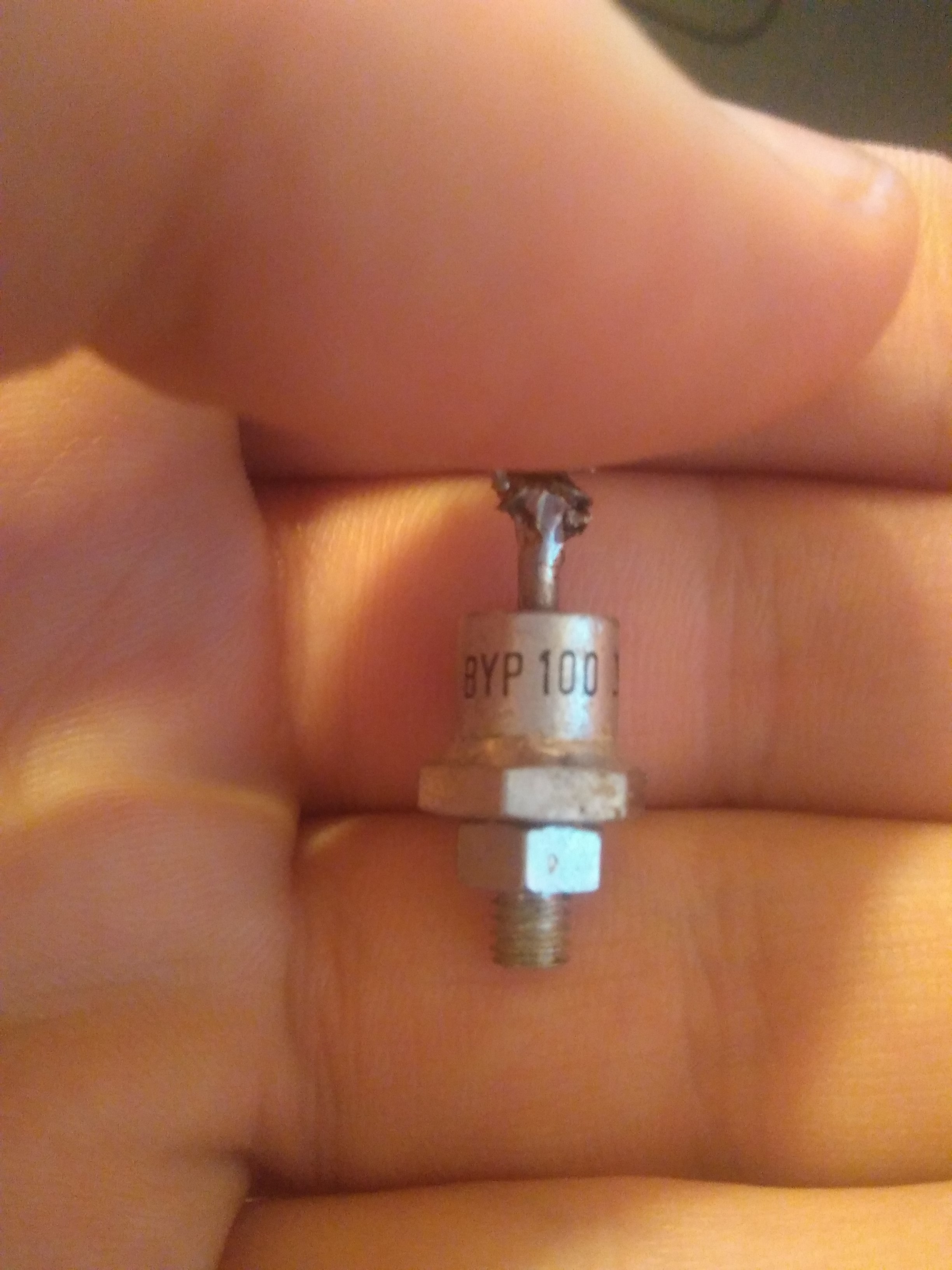

An example of a "second-rate" diode.
Normally marked as BYP680-100.
5A 100V general purpose diode.
This one is marked as BYP100, you won't find it in any datasheet from the time.
What kind of load can this "second-rate" diode handle ?
Dunno really. May have lower current rating, higher leakage current or decreased max voltage.
Sometimes "second-rate" devices were repurposed or used for "bottom of the line".

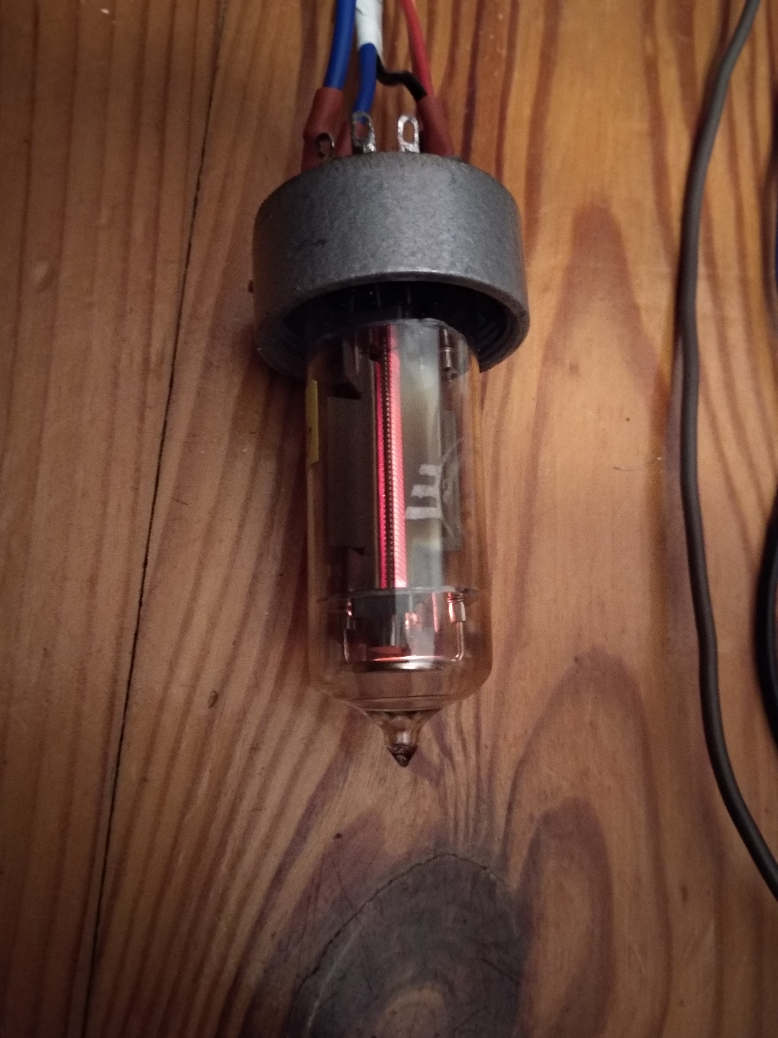

Started working with tubes.
Soviet 6S19P triode. Main use was series voltage regulation in military aircrafts.
Isn't the glow nice ?
Regulated grid and anode voltage.
Anode voltage is 180V zener + KSC5027 NPN transistor (800Vce).
Grid regulation is 4x15V zener.
I have a audio transformer which was originally used in Stern 7e86, an Eastern German Vacuum tube radio from 50's.
The radio used 6V6 (in Eastern Germany) or EL84 (version for Polish market) as output tube, 40mA@240V so it should be fine with 6S19P.
170V anode(~320R primary, 185V before transformer),-60V grid which results in 44mA anode current.
Close to original value used in the radio.
