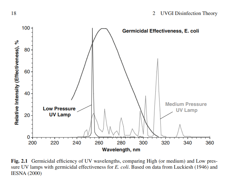

Ultraviolet Germicidal Irradiation Handbook by Kowalski and The Ultraviolet Disinfection Handbook by Bolton and Cotton are what I use as references. Primary sources are listed in the books.
Offline KaneTW
  • Posts: 811
Re: COVID-19 Emergency - Using UV Lamps to sanitize Face Masks overnight
« Reply #103 on: April 01, 2020, 10:29:18 pm »
If there are any references for UV mercury germicidal lamp efficiency, please send them may way.  The study I was referring to is
Hao & Han, Qiuyi & Zhang, Shanduan. (2013). “254 nm Radiant Efficiency of High Output Low Pressure Mercury Discharge Lamps with Neon-Argon Buffer Gas” Applied Mechanics and Materials. 325-326. 409-412. 10.4028/www.scientific.net/AMM.325-326.409.
That is where I obtained by 30% estimate from.
from Kowalski's book above

Go ahead. The books I mentioned are used to design UV systems for air (e.g. in a HVAC system) and water disinfection. There's also (commercial, with free trial) http://www.uvcalc.com/ which can be used to model reactors so that you get the required target dose.
The required dose rate depends on whether you want to kill everything immediately or whether the system is circulating and a partial kill is fine. It also depends on whether there's a constant influx of new pathogens or not.
There was a paper on the relevant disinfection kinetics but I can't find it again. I'll let you know if I find something.

Interesting details about UVC lamps in air handlers. What about the ozone generated? Is it a safe level or is there some way of filtering it out?
Would the UVC be more effective on the intake side (before the air filter, so microbes would be killed and then filtered), or on the output side where it could help to sterilize the evaporator coil?
   I already covered the first part of this. You can buy 254nm lamps that have a doped envelope that blocks the 185nm radiation so they don't produce ozone.
   Regarding the 2nd part, IMO the UVC source would be most effective on the dirty side of the filter since the virus should be trapped on that side of the filter.  That means that to protect someone from the virus it needs to be on the intake side but for preventing an infected person from spreading the virus that it needs to be on the human side of the filter.  However having the UVC on the human side of the filter could also expose the skin and eyes to harmful UVC radiation so the design would have to prevent that.  Also if the mask is designed only to prevent spreading the virus and to only filter exhaled air and not inhaled air then ozone generation shouldn't be an issue and may actually be a benefit since it would help kill the virus.  So it looks like you would need two different mask designs to best serve two different purposes.
Doped UVC tubes generate negligible amounts of ozone-generating UV as far as I know (haven't concerned myself with air disinfection too much, only water).
No idea about intake/outtake. Industry practice for HVAC seems to be to install them in the return duct, but more research is needed.
