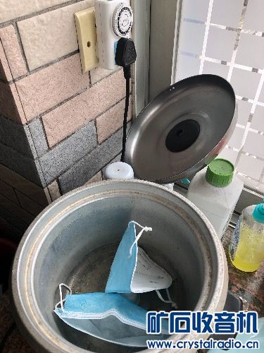

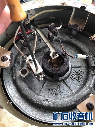

I  had  used  an oven to be a face mask restorer .
http://www.crystalradio.cn/forum.php?mod=viewthread&tid=1838490&extra=
