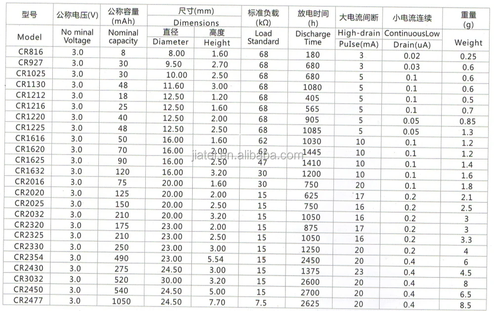

I have used Energizer datasheets for comparing CR2032, CR2430 and CR2450, but now I noticed there is something badly wrong in http://data.energizer.com/pdfs/cr2450.pdf. It shows IR to be 100 ohm at just over 300 mAh, but still 9 mA current causes only about 0.2 V difference between idle and load. U=R*I gives 0.9 V. Is there a wrong scale for IR? CR2032 and CR2430 are consistent with U=R*I.
Now I also found this one: http://www.dixonelectric.ca/productsheets/energizer/ECR2450BF_3V%20Lithium%20Coin%20Battery_Dixon%20Electric%20ca.pdf
It has a completely different curve for CR2450 with the same test setup! Now the pulse curve drops below 2 V already before 300 mAh while in the earlier one that happened at 550 mAh. Almost now additional capacity compared to CR2430 despite of more than double nominal capacity.
Renata shows quite different curves for CR2450: https://www.renata.com/fileadmin/downloads/designersguide/DesignersGuide-2011_080813.pdf

I got the new batteries. Brand new Varta CR2430 seems to have less than 10 ohm internal resistance. Also it seems IR of lithium coins depends on how it is measured. I have a DE-5000 LCR meter. I measured resistance through a capacitor and the higher frequency I used the lower resistance I got. E.g. for a used CR2032 I get 130 ohm at 100 Hz, 122 at 120 Hz, 43 ohm at 1 kHz, 23 at 10 kHz and 17 ohm at 100 kHz. Using a 470 ohm resistor and multimeter I got about 180 ohm and calculating from rise time after a pulse I got about 300 ohm.
I first thought that DE-5000 + the cap I used fails to measure, but measuring a NiMh AA-cell gave about the same at every frequency (0.4-0.5 ohm).
