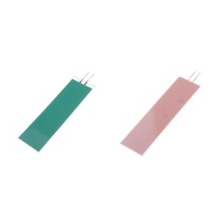

I purchased a small EL panel and was wondering is there are any recommendations on the best way to crop it to size. Its both a little tall and long for my application. Obviously I need to center the cropping on the pins. Anything else I need to worry about?

At a guess... Atmospheric moisture ingress and possible delamination, causing degradation of the phosphor around the edge. Also the possibility of creating localised shorts between the upper and lower conductors.
I don't know for sure but I think they are edge sealed.

I could mitigate the environmental effects by sealing the cuts in Scotch tape.

I temporarily attached the new panel to the device and the light output is still very low. I measured the voltage from the driver and its only 16VAC rather than the 75VAC it should be. Looks like its the driver (a self-contained piece of unobtainium) rather than the panel. I'll hack in a modern driver and see if it works.

Yes, that doesn't sound good. The driver is probably fairly simple, quite likely a Royer converter.
I'm not sure that will work, since moisture will still get in. I think a clear lacquer will be better

I could open it up via a dremel and have a look but a new driver is less than $2 so...
Hopefully I won't need to go there right now but I'll keep that in mind for next time.

Finally got around to completing this after all the holiday business was taken care of. Got a $2 USB EL driver from Aliexpress and it works just fine in the Keithley. Will save the EL panel for future use.
