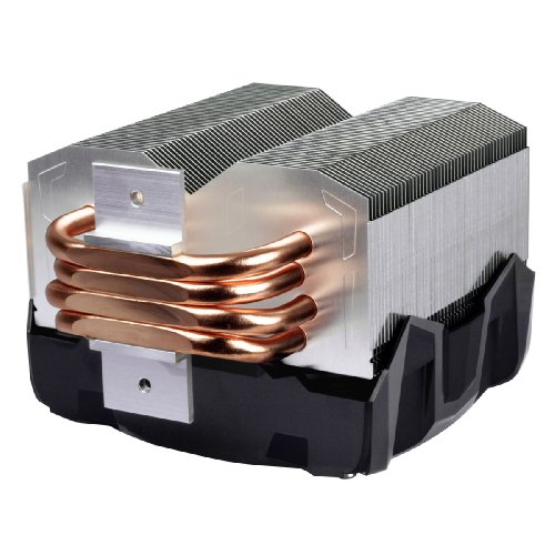

Offline microbugTopic starter
  • Posts: 568
  • Electronics Enthusiast
DC load using a CPU cooler
« Reply #41 on: September 20, 2014, 01:02:03 pm »
Yes... I agree. I'll measure it up when I buy the heatsink.
EDIT: that link is correct, if anyone is wondering.
Offline mrflibble
  • Posts: 2051
Re: DC load using a CPU cooler
« Reply #42 on: September 20, 2014, 01:08:37 pm »
Wait, 9??? Look at the picture of the heatsink portion. (5th Picture)
That looks like *maybe* enough room for two TO-220 packages...
Heh, I was wondering the very same thing.
I don't know of any cheapo cpu coolers that would accomodate 9 TO-220 packages. You could do something custom, but that would automatically discard that "cheapo" word in there.
Image of the cooler being discussed. Inline because I am lazy today:
  • Posts: 568
« Reply #43 on: September 20, 2014, 01:11:45 pm »
Judging by the details on this page (4x8mm heat pipes), I'd say that the thermal pad is 32mm by 32mm or thereabouts. That's just enough for two TO-247 packages.
EDIT: I think it would just do 6 TO-220 packages, because in one dimension it is slightly more than 32mm. My current design (which needs some significant changes anyway) has an OPA4188 controlling 3 MOSFETs and acting as an amplifier for the DAC. I could stick in another OPA4188 and use 6 op-amps for 6 MOSFETs. I'm sure I can find a use for the two spare op-amps.
« Last Edit: September 20, 2014, 01:16:54 pm by microbug »
